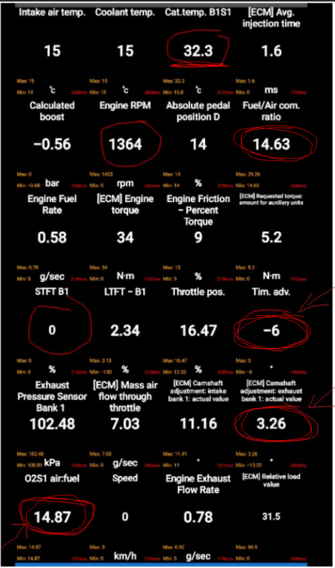

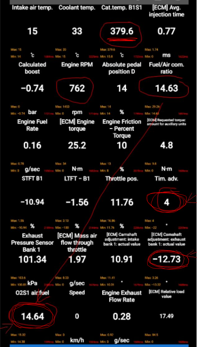

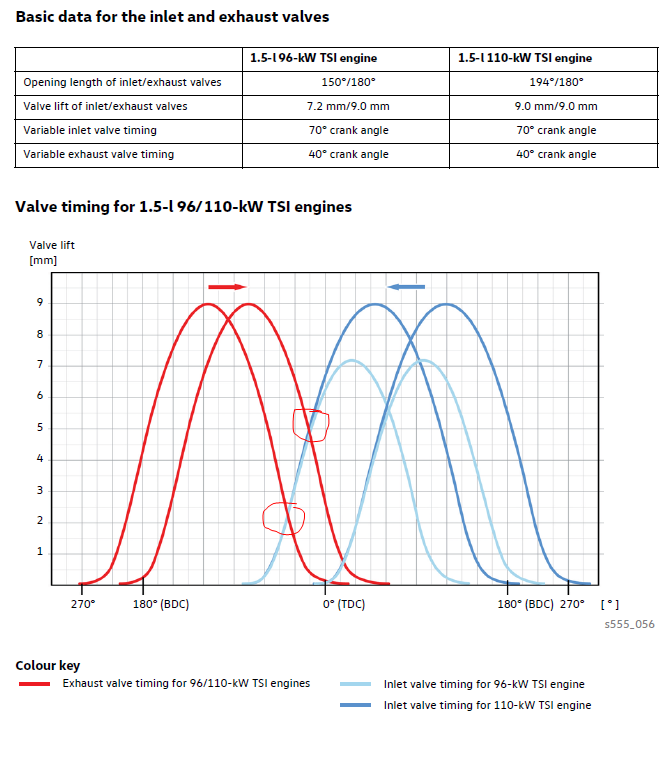

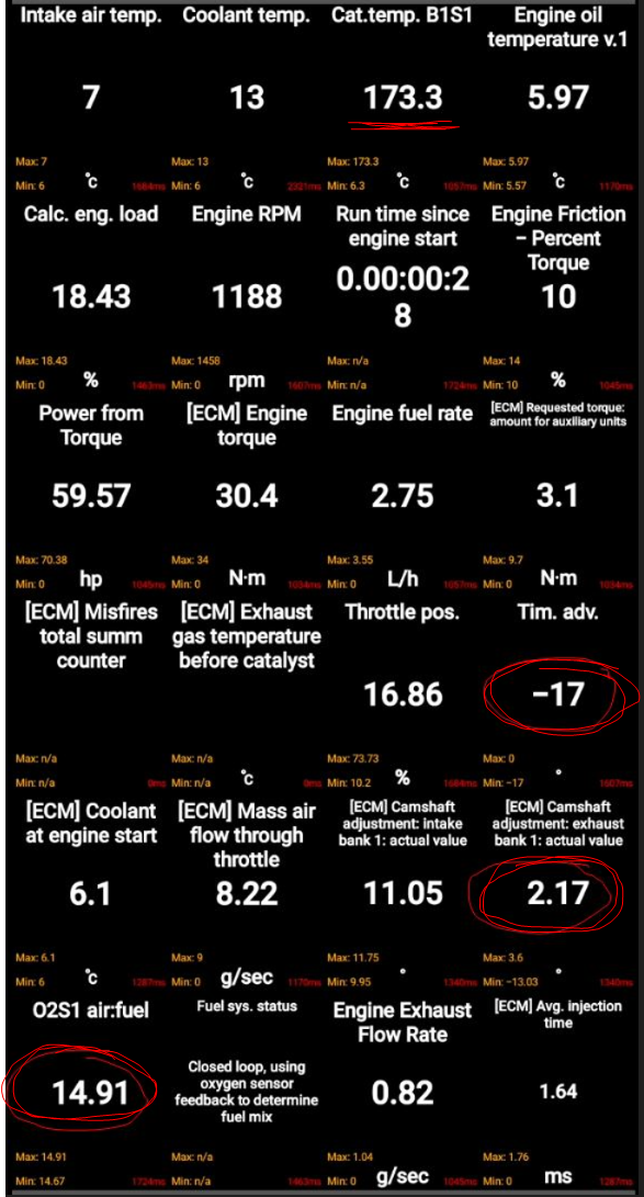

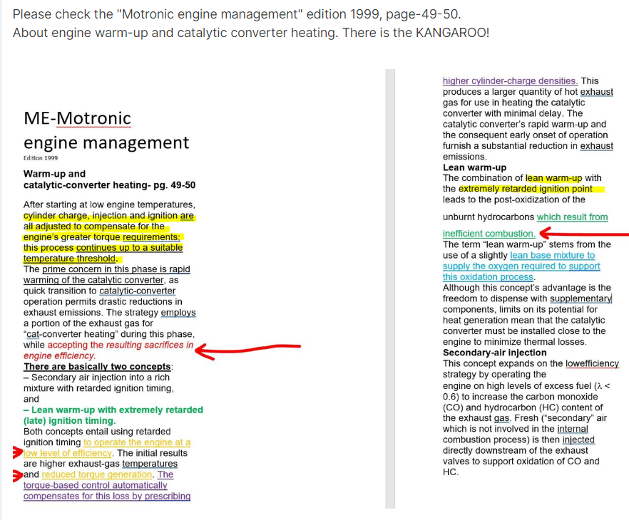

Hi, found that Kangaroo is related to the exhaust camshaft advance/retard when the engine is cold/when preheating the catalitic converter.
It is because the ea211evo does not have a physical EGR, everything was made with the inlet/exhaust valve overlap in order to decrease NOx.
So don't ask for the usual power remap (with the lambda and timing advance, like all do), ask instead for the exhaust camshaft tweak at low RPM and low driver demand (for less overlap with the inlet).
SSP-253 info there, you can also check by yourself with a tester.
Edited by cri1410sti
attached 1 file with the exhaust retard, sorry for the language :)

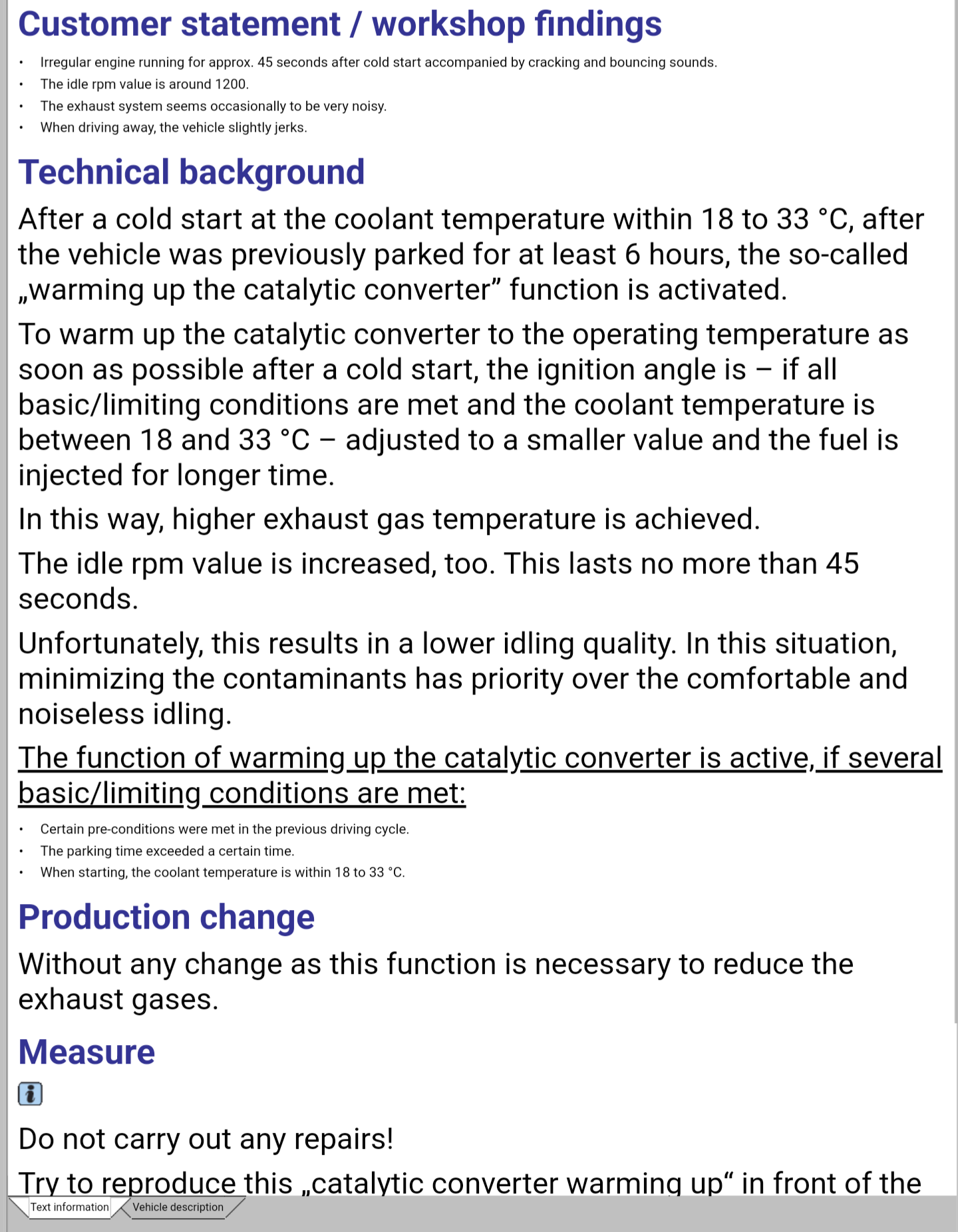

It just goes to show that with that knowledge 2 decades on the VW Engineers tried to get the WLTP Certification not taking that into account.
Vorsprung Durch Technik and just try whatever you think you might get away with.
Even further back in 1988 when I worked at an automotive consultancy the engine management engineers knew that they had to have two phases to their tuning:
Phase 1: get the engine to run correctly and delivering good power, torque AND drivability
Phase 2: sacrifice the drivability to pass the emissions testing requirements
starting catalyst pre-heating (see spark delay + exhaust/inlet overlap, lean mixture)
catalyst pre-heating after 30 seconds from engine start (see spark delay + exhaust/inlet overlap, lean mixture)
at ~1 min after engine start, catalyst at working temp, (spark advance, no inlet/exhaust overlap, perfect lambda)- from here there will/should not  be  kangaroo

So we are supposed to wait 1 minute before driving?
This TPI is for Dealership staff to try and have Euro 6 1.2TSI,s that run crap on start up believing that is perfectly normal.

yes, 1min or until your idle is below 800rpm :)
for VW everything is normal,
so VW did not care about the driveability, they forced the CO2 figures, so it is all about $$$
my warranty ends in ~6 months, i can tell 110% that i will have a custom remap,
will fix the kangaroo (spark+fuel in the catalyst pre-hearing mode) and will add 1-2% more fuel in the engine warmup mode and also in normal mode.
i will not get more hp, it has enough, it will just work as it should.
