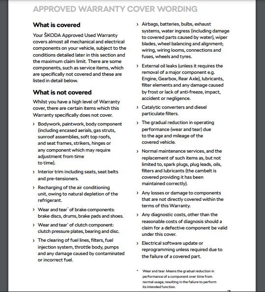

They or the Warranty Provider can tell you in Writing which exclusion covers the part required & the breakage.
*They might have messed up and managed to not include something they can say not covered.*
VWFS_11815379_SKODA_AUW_Booklet_0922E (1) (1).pdf
Edited by toot
That's exactly the document I showed them. That small piece at the bottom saying wear and tear means the gradual reduction in performance or component over time from normal usage pretty much excludes them from paying anything. I was told today that if this pipe had snapped on a new car it would not be covered and it was also mentioned that the washer fluid screen wash may have been to strong! I was about to extend the warranty but not now after this I won't give them a penny more. It's not specific to Skoda as I also own a Hyundai I30N from new which has a five year warranty but they also do not want to pay out on anything.
The Washer Fluid anti freeze would have been not strong enough.  Washer Fluid froze in pipe.
That Performance stuff is for the engine but they can try to have it cover anything.
The Rear Washer loss of Performance is because of a broken pipe though, then leaking washer fluid.
Maybe due to freezing in winter, maybe caused by you because the washer fluid strength was too weak for the coldest weather.
 But they are not saying that are they.
Has the Dealership submitted a Warranty claim or is this just the Master Tech not supporting your claim.  They are your agent, they are not the Warranty Provider.
