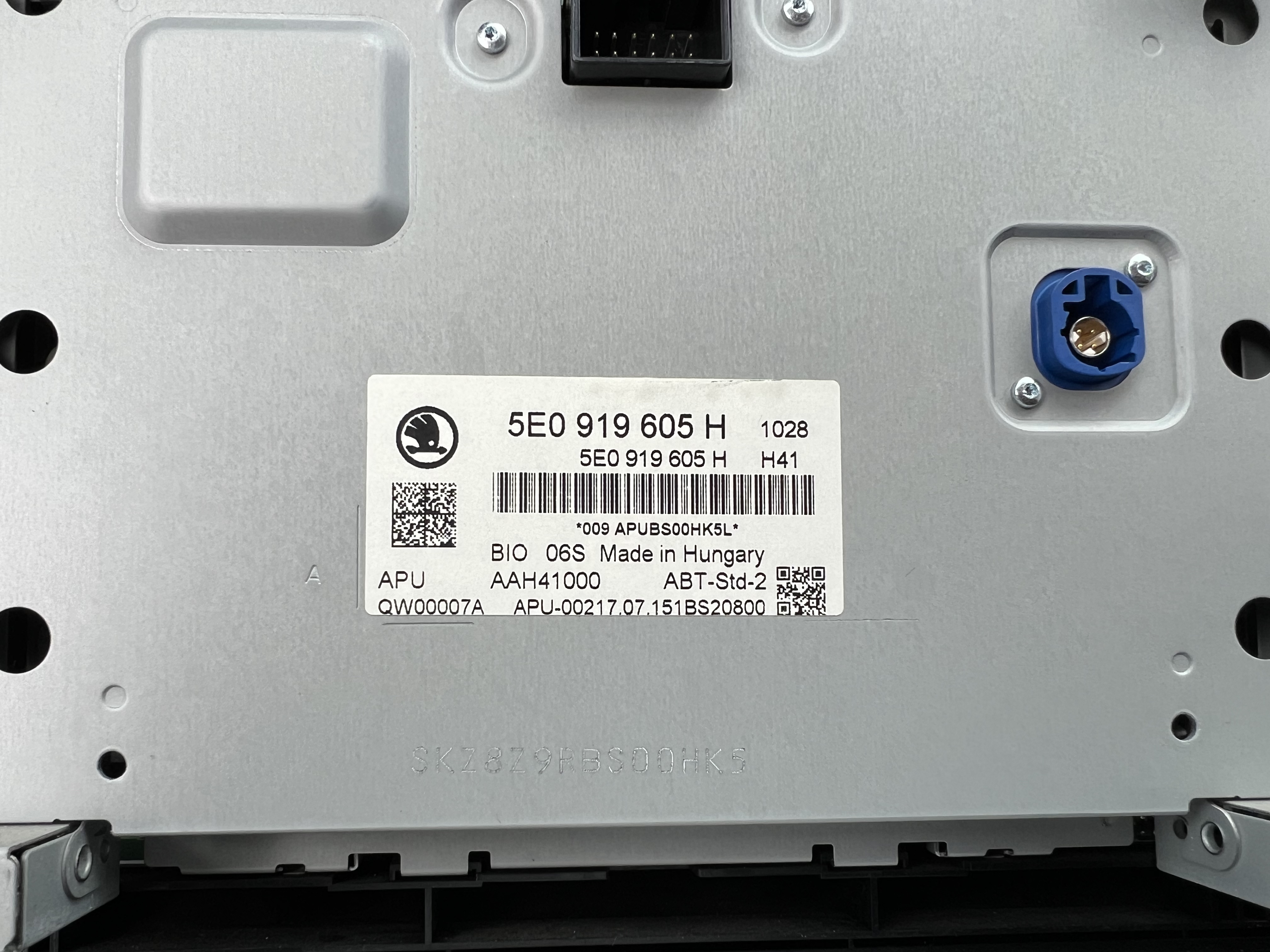

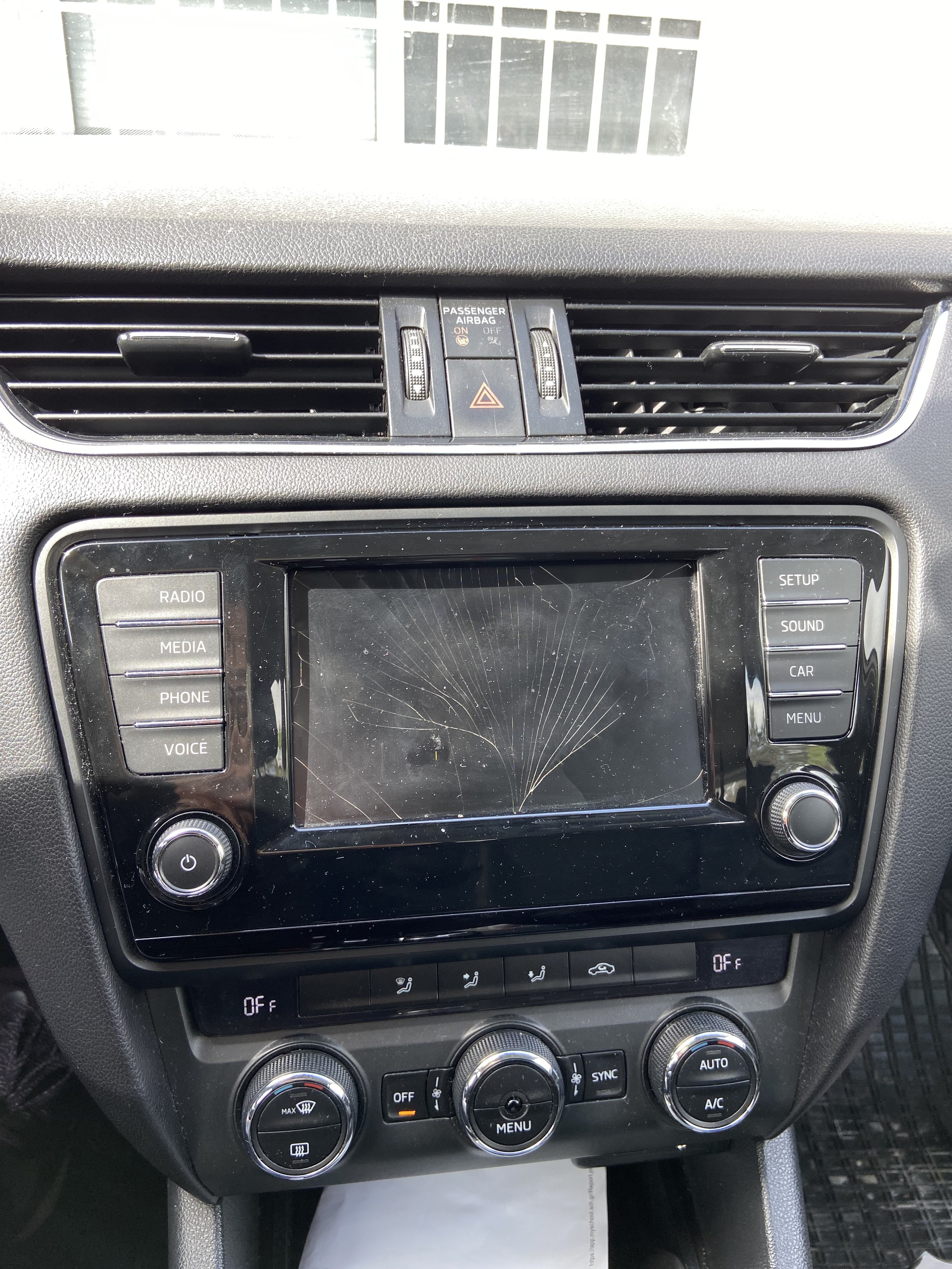

I have broke the screen last week and I want to replace it with the exact same one . I don’t know which one to buy and if it needs extra coding. So, the help I need is with the part numbers, mine’s says BIO 06S underneath. But, I have found some screens that says BIO 08S and they are exactly the same in front . Which one , I have to choose in order to be okay with no problems ?
Thanks in advance for your help and for your precious time!
Displays are not covered with Coponents Protection and don;'t require any coding so just buy a new one and replace (4 removal keys required to remove old one).
Perfect, thanks for your help guys.
I have removed it on my own and checked it, the photos are mine .

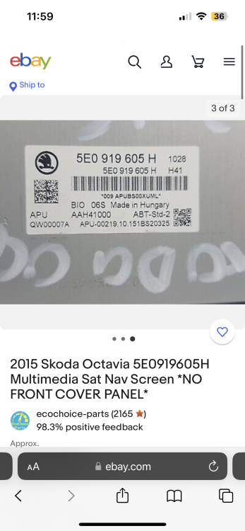

But, what about the code BIO 06S and BIO 08S ? @pab567
For example:
I have no clue bu beleive me - will work OK.
