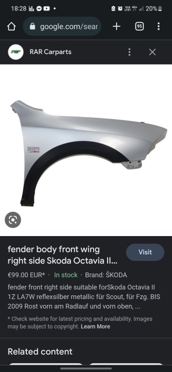

Hello! I was just wondering, if I buy a used front side panel with the scout plastic trim around the wheel arch, will it fit for a normal octavia?

I couldn't figure out the correct word for it when I wrote this thread, should be fender 👍
If you take a look at the parts catalogue entry HERE for a 2007 1Z Octy you can see that the wing (what you called the fender) is the same for all Octy models of that year (and, as far as I know, for all mk2 Octys).
The model differentiations are almost entirely in the plastics - for example there are three front bumper types.
Note that you will need to use a hot air gun to soften the polyurethane adhesive  inside the top of the wing, and I'd recommend replacing the two foam rubber supports/dampers under the wing.
