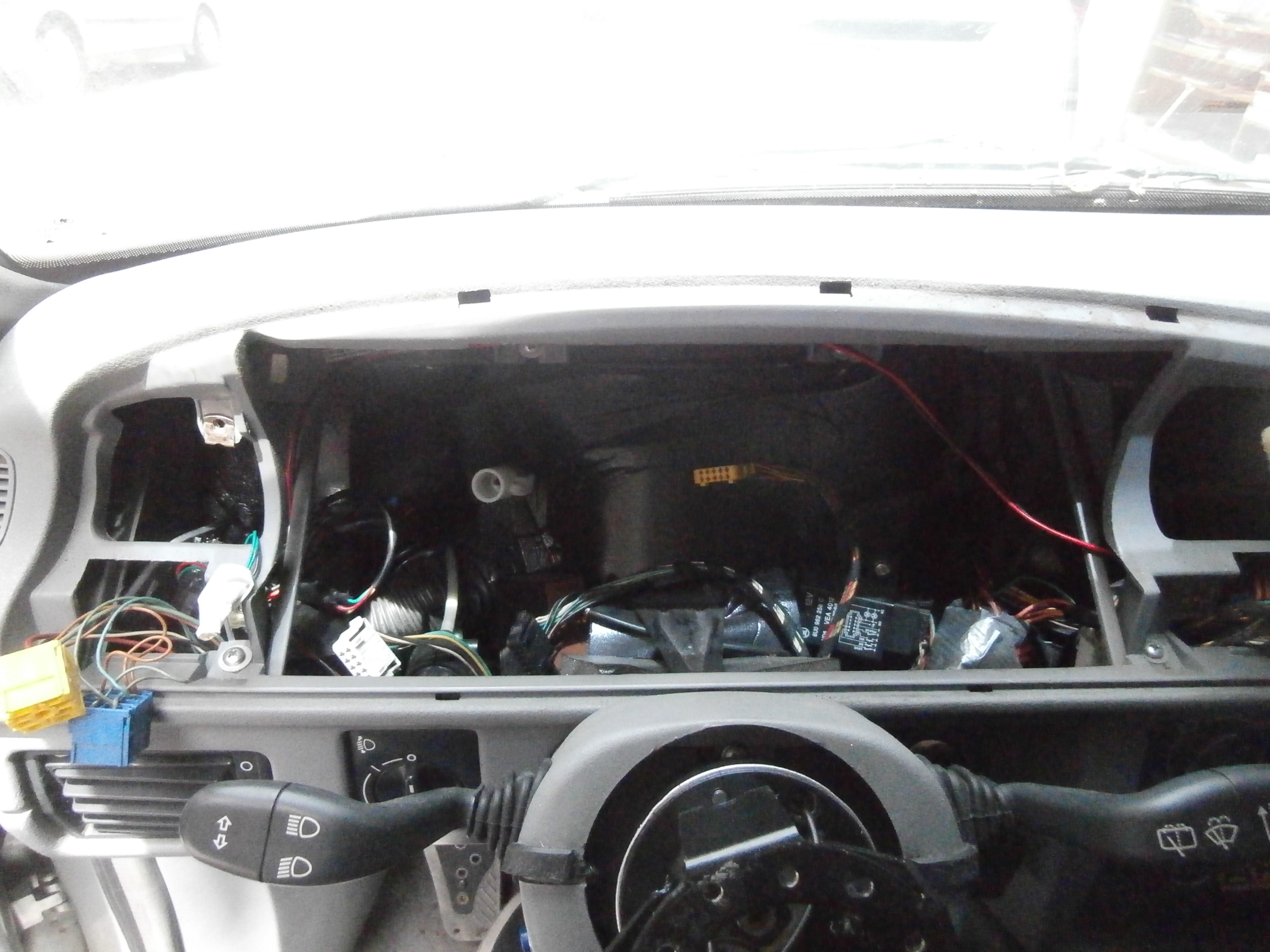

Maybe a plug problem, not proper contact or a pin has corrosion of damaged cable.

Some times my english don't help me, for sure it has as i show it.
It happened to me few years back, i had a ''squeaky noise'' in national way only, not in city roads.
The problem was on the base of the square wire, by mistake i had put in the past some silicone oil inside the ''nest'' and in high rpm the wire was trembling.
Another time that white (like Teflon) clip wasn't secured 100% (it's twist and click procedure) and i had a noise that something was ''coordinated'' but when i removed the panel both of these problems solved.
