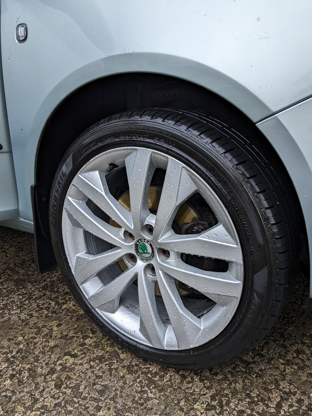

These are some I'm looking at, for an example - https://www.ebay.co.uk/itm/195713828129, and https://www.ebay.co.uk/itm/285141388880 and attached below is one of my current wheels, which fit quite tightly into the wheel well.
What size are those you have on the Fabia now, 205/45 R 17 .
That is oversized for Mk2 Fabia if you have as the vRS OE tyres on Gigaro are 205/40 R 17  but some do fit 205/45 R 17 or 215/40 R 17 on vRS / Monte carlos.
Or have you 195/45 R 17's on?

Hi toot, yes they are 205/45/17, and as you say they are oversized, they barely fit.
That's good to know, I'll miss them as they look cracking but as I say, I want some nice fat tyres to stop feeling every single pebble I drive over (and by God are the roads bad where I live...oh wait, that's all of the UK)
I'm talking tallness of the tyre wise, I actually tried 50 profiles but they rubbed
