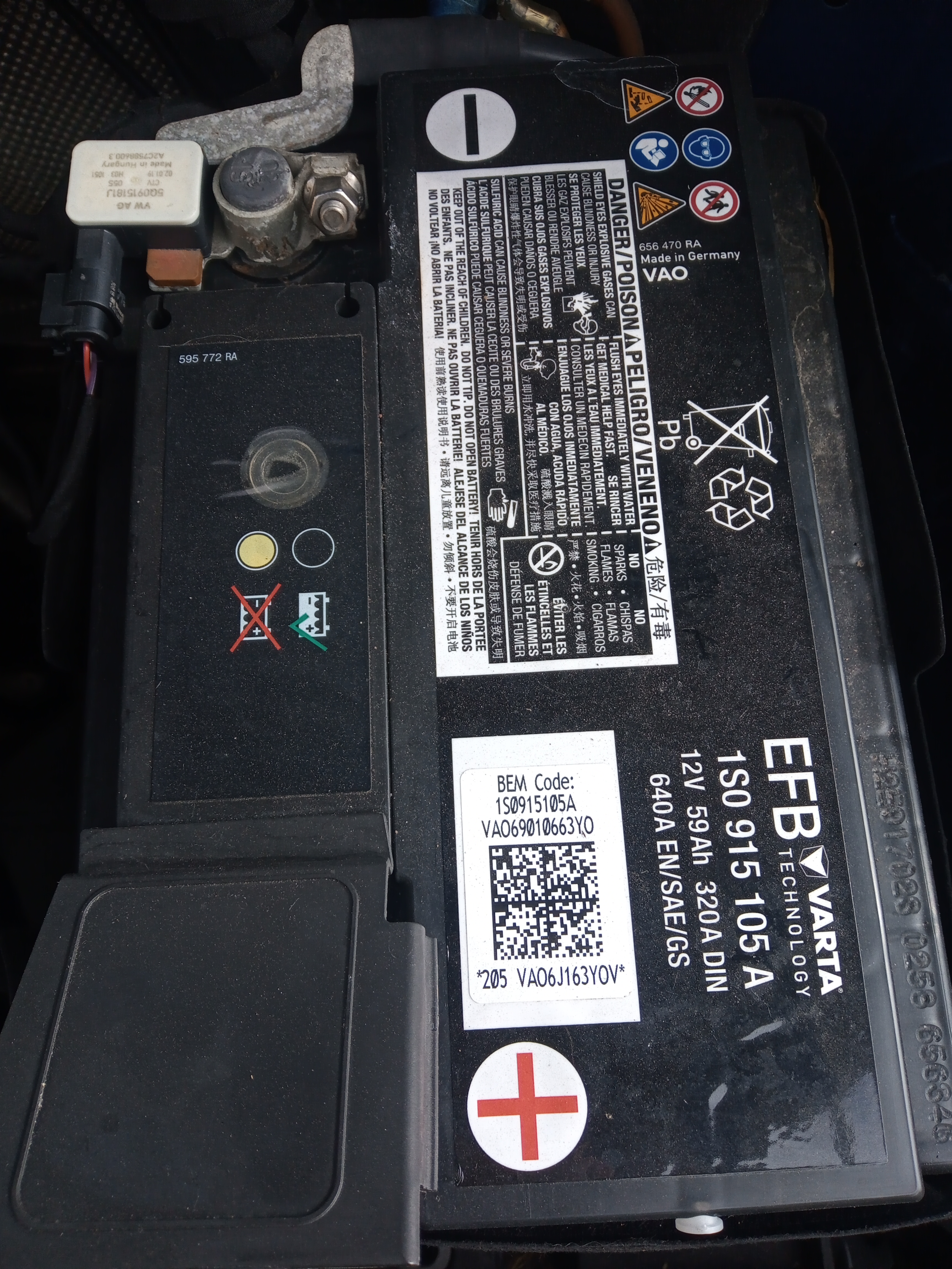

i replaced this exact EFB battery on my 2017 Octavia within the last few weeks. The Octavia I had before my current model had an AGM battery. I imagine the EFB battery is now fitted as a cheaper alternative. The battery I fitted was an AGM and I have VCDS so updated the battery information using the guide above. I can recommend it except VCDS wouldn't accept the serial number in the way illustrated. I removed the "/" in the date and left spaces and VCDS was happy.

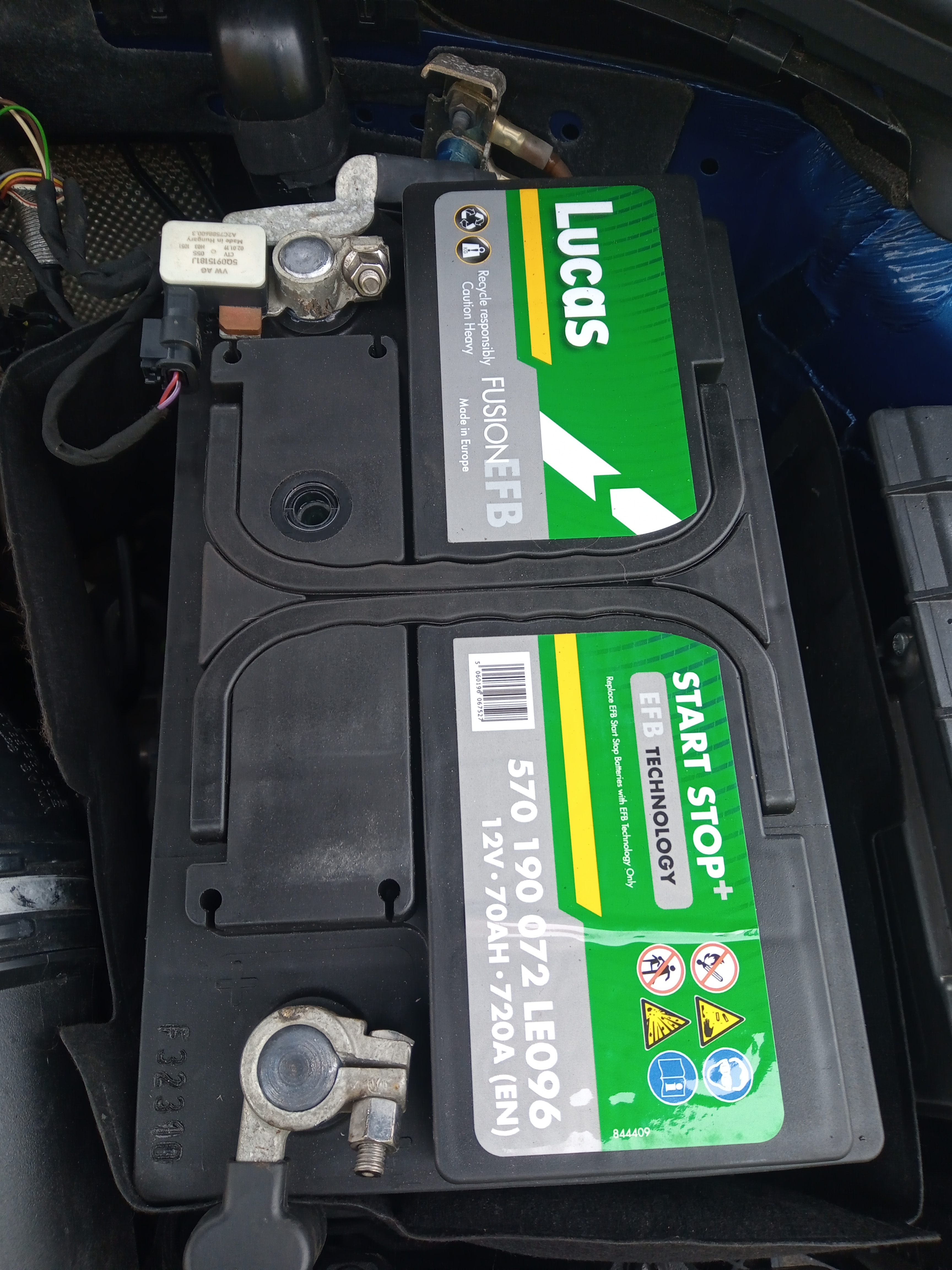

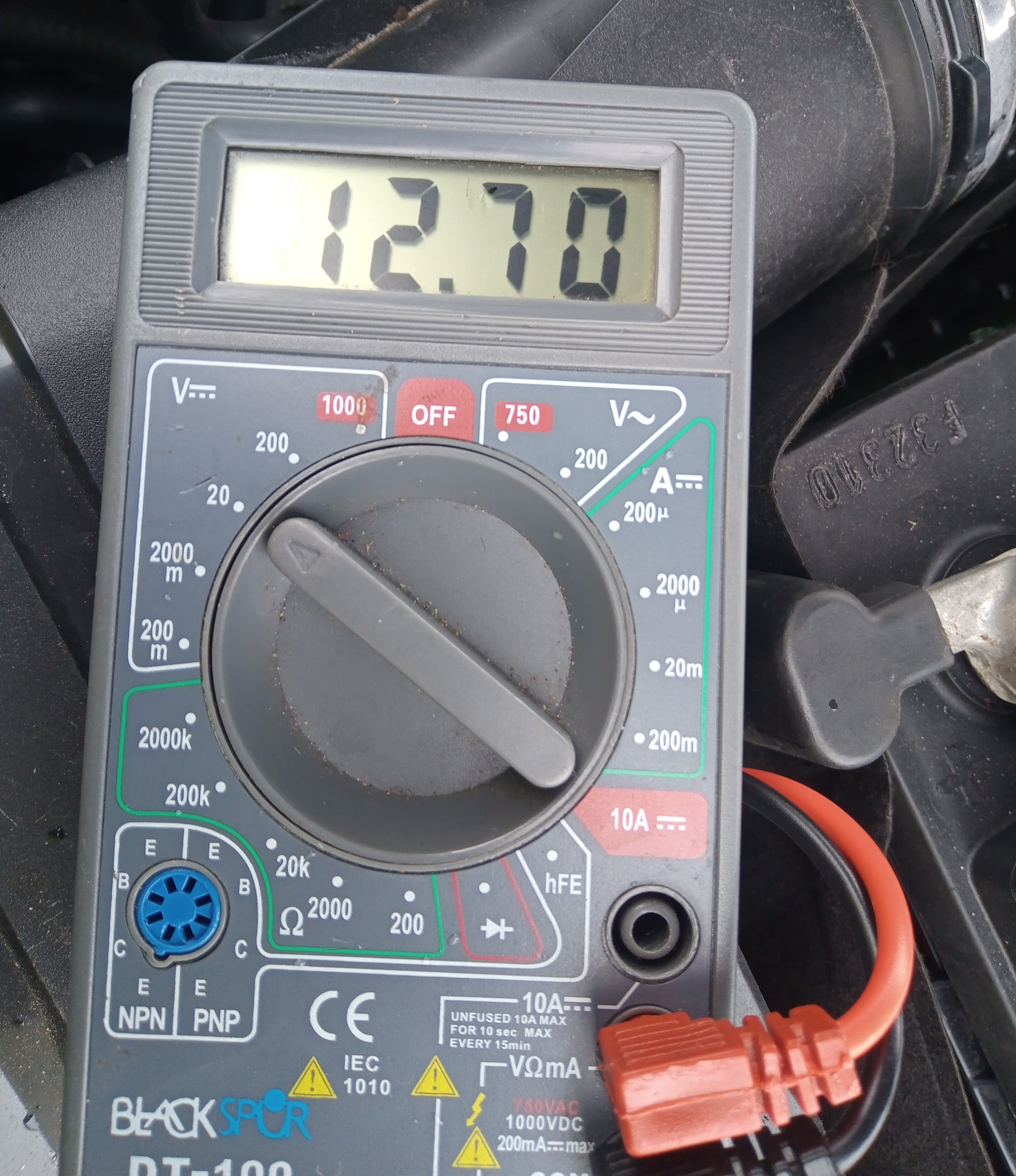

New battery now fitted (EFB), they'd ordered an AGM in by mistake, 20 mins later had an EFB dropped off. So in the end had it supplied, fitted and adapted for £150 all in, so was pleased with that and a 2 year guarantee on the battery. They used a type of cloned system to adapt the battery. New battery showing 12.7v with engine switched off.
