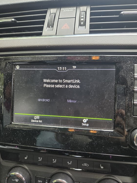

I have followed all the steps and managed to unlock Smartlink. However, both androidauto and mirrorlink are greyed out on the infotainment screen and my phone when plugged in is not being read by the car. Anyone got any suggestions?
