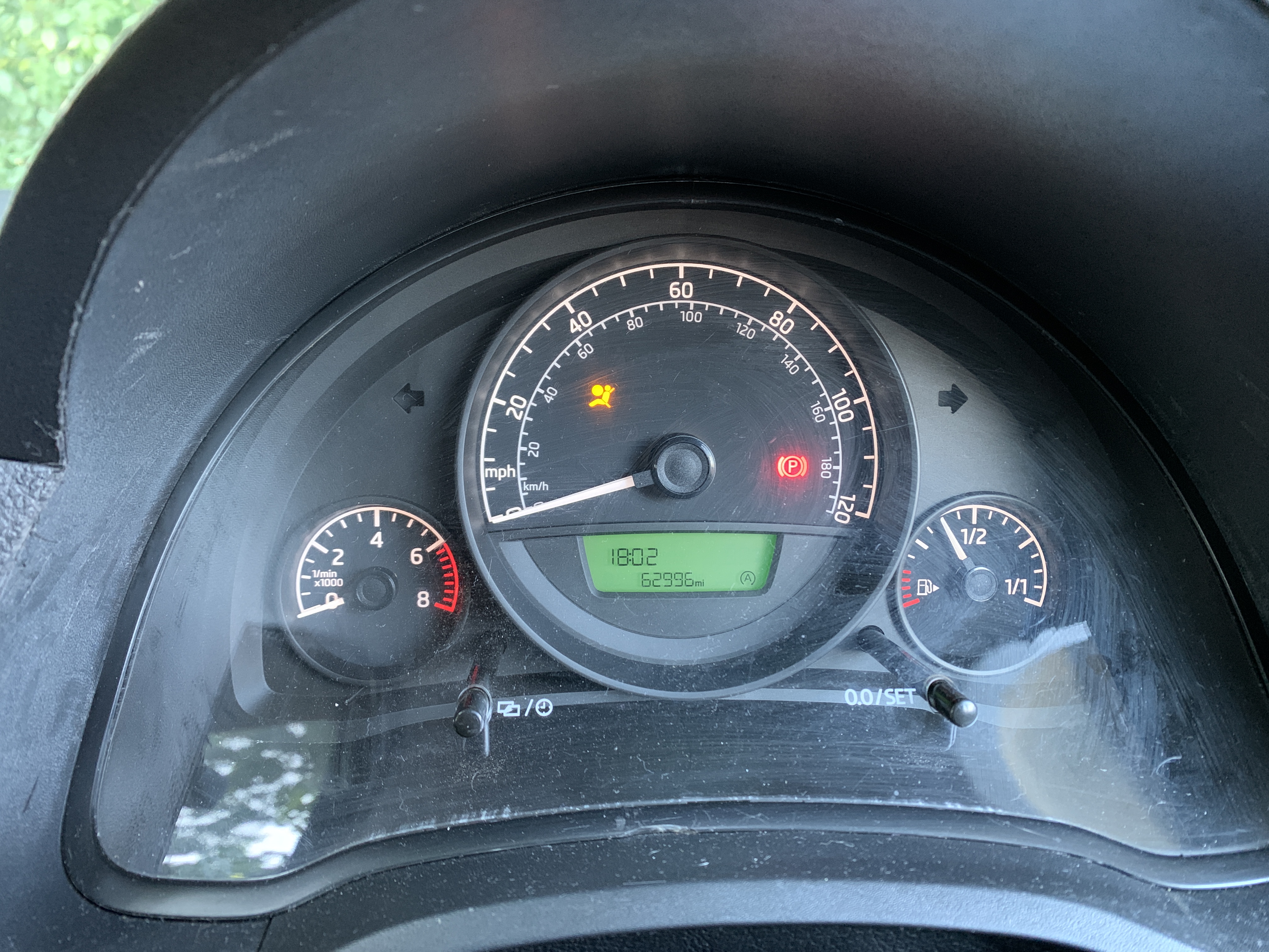

Skoda Citigo, Airbag light stays on. Could someone near London help me diagnose and reset for me please? Wires were loose underneath the seat, replugged all of them! Does Ancel VD700 reset the code?

Turns out the aigbag cables were unplugged under driver seat. WTF.
I stupidly thought the light means airbag feature is fully functional when bought the car. I wonder if the seller tried to cheat me by giving me a lemon, as they didn't know how to fix and Garage quoted 65 to diagnose and 400 to fix.
Anyways, plugged in cables, a redditor helped me out with a VCDS and cleared the error. It's gone. Status says OK on the VCDS report. Good to know the airbag is fully functional now. Fantastic!
