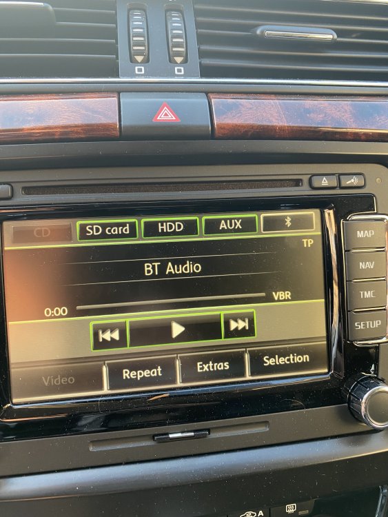

I have a RNS510 navigation on Superb 2
i bought a Novero HT-5 bluetooth module : 3C8 035 730 D
i managed to install the module and almost everything works fine
- phone manage to connect Fast, calls are working perfectly
- phone part: everything okay
The problem: I manage to put music from my phone with Bluetooth, I can even change it from buttons-Navi plus steering wheel
BUT music is working just on the right side- just right speakers
i managed to find something on your forum but not enough. I found that old module supported just MONO and that’s probably why.
my question right now is what I can do to solve the issue. Because I want to use Bluetooth music for all speakers, obviously
any suggestions? Maybe someone can remember what he did and what I need to buy exactly
attached pictures with my Navi and new Bluetooth module.
i wait for your kindly reply and thank you very much !

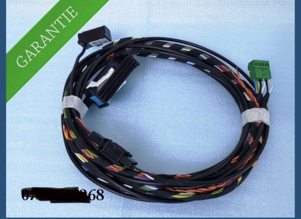

I found a solution: cable from 9W2 to 9W7
do you think that this will solve the problem ?
Your module supports both channels but the harness you get has connection only for one channel - you must add two wires between the black module bplug and green radio plug.
Hello,
yes, i think that this is the situation
I will buy one new cable from the navigation to Bluetooth
this one from above. Is just 35 euros and will solve all my problems
you are the best
thanks again !
Hi. I have the same problem. I think I can add the wires, but how do I know which pins they go in? Is there a diagram or some guidance?
BT Harness pin 4 -> Head Unit pin 11
BT Harness pin 5 -> Head Unit pin 5
Thank you so much!
