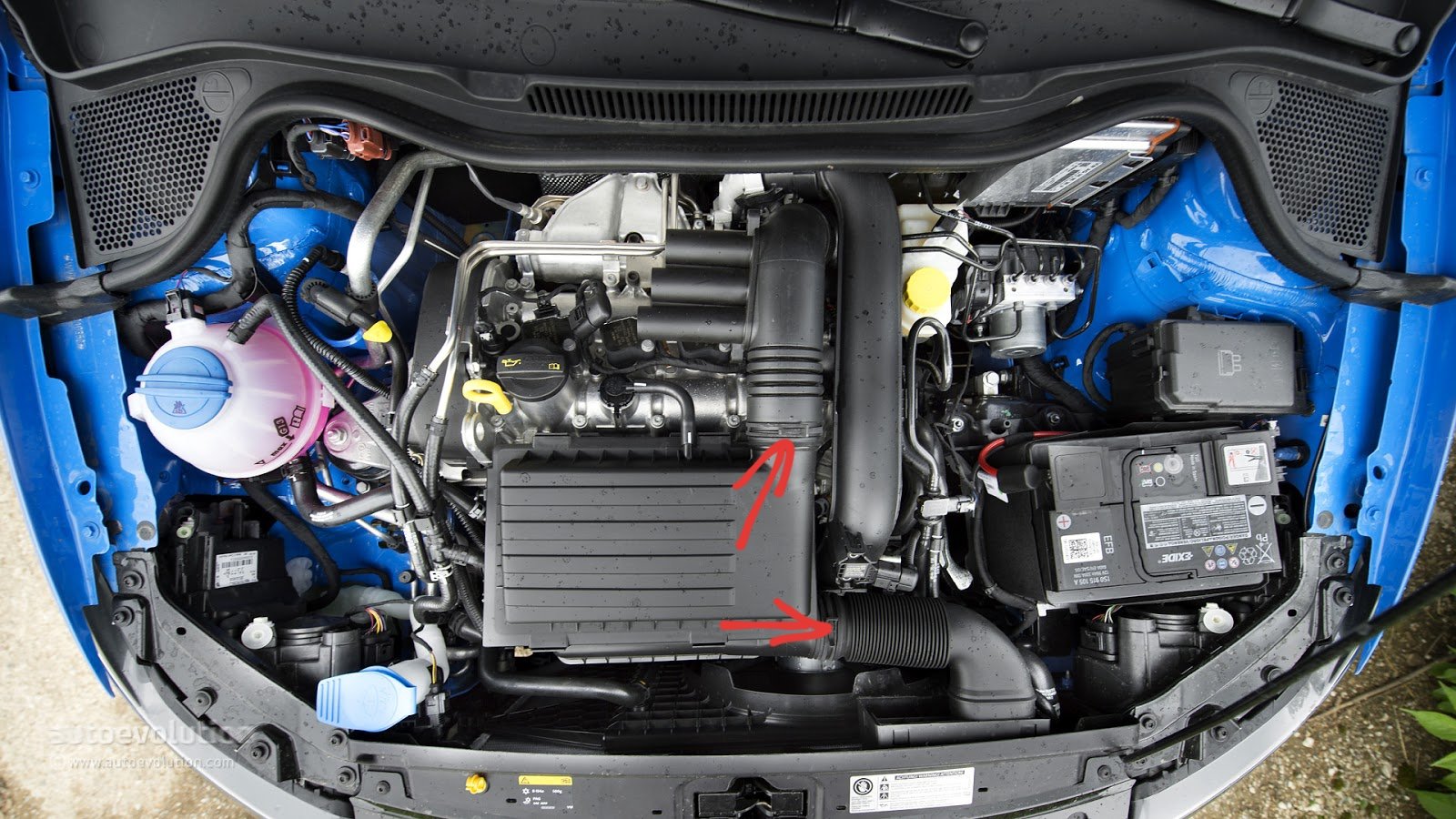

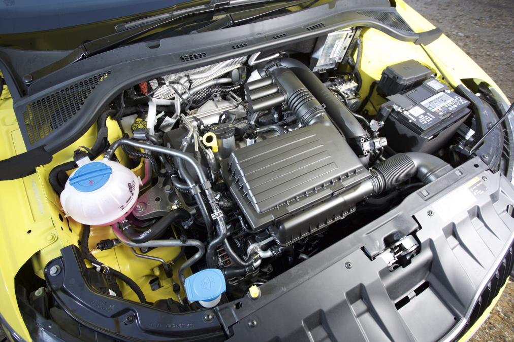

Sorry if the pictures i posted which have come from this section in the OP,s first post in the Performance section which i linked are not exactly the right ons.
I thought near enough to the engine compartment / parts.
20200303_195845.jpg.099971f573ca49726ce986391a566e53.jpg.bd78a319883d97ed56c09248a36503c1.jpg
skoda-fabia-tsi-engine.jpg.e98f38dd813371a933ec4b1ee25fc904.jpg.0a72ccd222f2b13c489dca8416ab56b4.jpg
