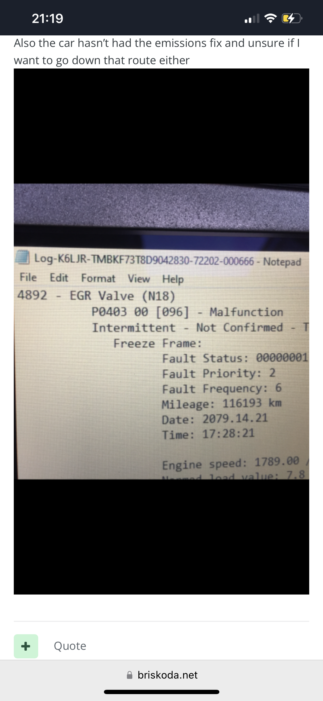

Back tracked through thread I started and same fault
but mine is 096 what ever that is
