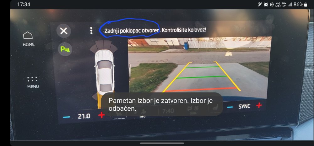

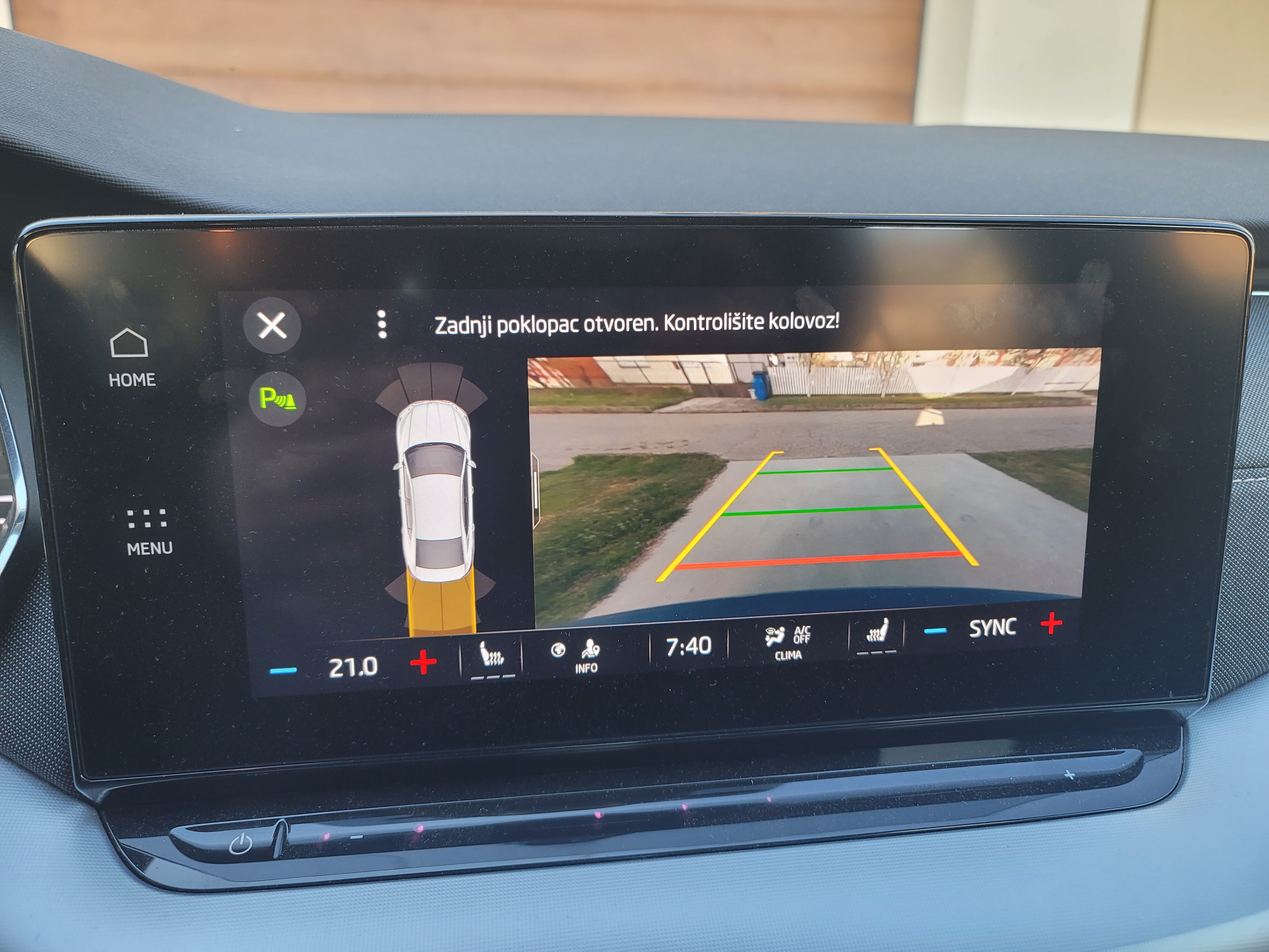

So as i mentioned in multimedia reboot topic, there is little annoying problem for quite some time. Multiple visits to dealer, Skoda sad sw problem, multiple upgrading, never solved. I used search on entire forum, found nothing.
When i open boot and close when ignition is off sometimes i get warning for open boot when i start car and reversing. Only on reverse camera, nothing on VC. Quick solution is to open and close boot, Skoda is persisant that it is sw problem, so i tried to restart multimedia and warning is still present. Is there anyway that signal for VC and multimedia is different for this? One guy told me it is probably camera problem, or wiring to it, but all they can do is listen to Skoda for now. And Skoda introduced me to a wonderfull world of reboots😆
P. S. Translation from picture is something like rear lead open, then it is control road, that second part is always there when everything is normal.

Sorry it is a long time ago now but if you are still around please show where it shows the Boot open ?
Only on MIB screen, nothing on VC. Marked with blue. Gonna solve it in next couple of months hopefully.
Sorry mate I cannot read that !
Boot lid opened or something like that. Described it in first post. Same thing as when boot is actually opened, only i that case there is also warning on VC.
