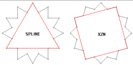

Triple square has 90 degree points, spline are 60 degree (4 triangles rather than 3 squares.
Will fit and probably work OK, biut be extra-careful that they go all the way into the screw heads (hammer on end of extensions til you feel it bottom out).

It's XZN, not XYN, which is triple-square, dunno what it stands for.
"I've never seen 4 triangles with 60 degree points", you say, so I guess that means they don't exist?
They may exist, but spline is normally used interchangeably with XZN.
I doubt you will find 4 triangles on VAG cars.

  • Sponsor
I agree on your last point (and the edit about Ribe) and yes, the terms are often muddled. Perhaps I should have checked with the OP exactly what his 'spline' bit looked like, but the advice about ensuring full engagement is never wasted words.
