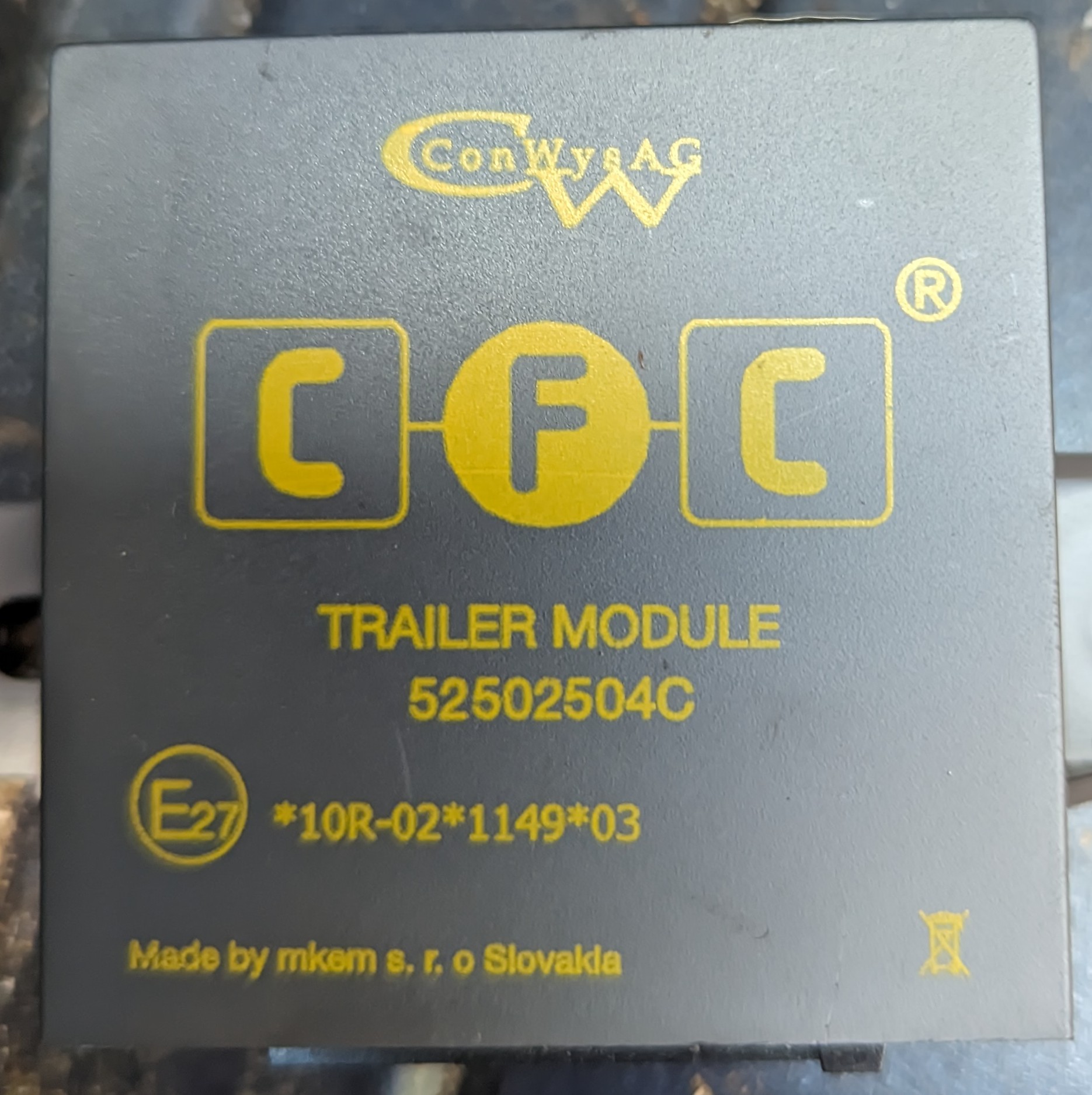

I've unplugged the trailer module (52502504C) and the bypass module, cleared all the faults, then reconnected the trailer module and at least the car is now behaving normally when the caravan isn't connected.

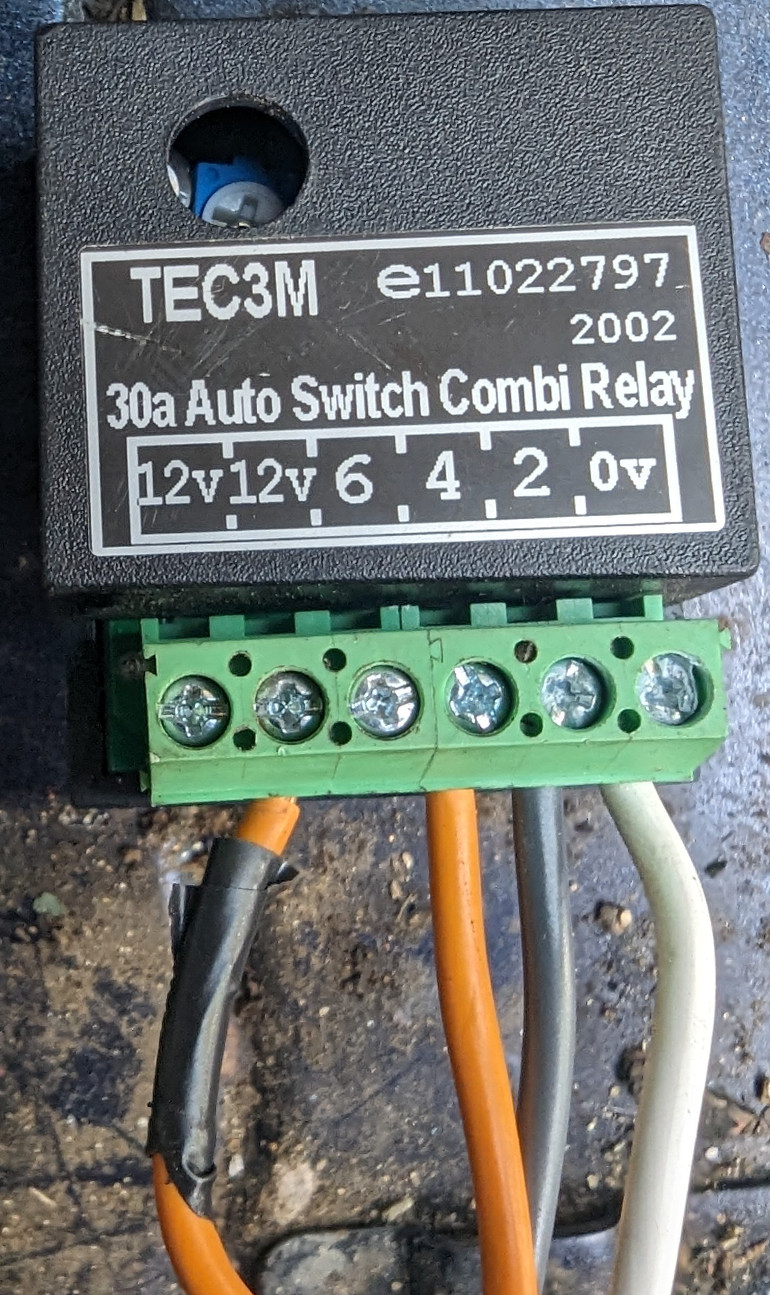

As soon as I connect the bypass relay (specifically the +12V)  the dash shows bulb errors and starts misbehaving again.
With both units disconnected there's 0V on this wire that's supposed to be the +12V feed for the bypass relay, and when I plug the trailer module in it goes up to +4V.
The bypass relay seems to have been wired incorrectly before too, with the fridge power going to 2 on the relay.

These are the modules.
I would love to have a wiring diagram for the car - any idea where to get one?
The connector that plugs into the trailer module seems to be direct from the main loom (I.e. Not aftermarket). Also, the reversing sensors won't work without this plugged in.
The bypass relay seems pretty standard. Note: this photo shows the wiring before I disconnected it. I added the black tape to the left-hand orange wire so I could distinguish it from the other one!

Can you show a picture of the connectors going to that module? Let's assume nothing about what's there since you've already spotted problems with the original installation. It would be really strange for someone to go to the effort of fitting the OEM wiring harness and not spend the little bit extra to fit the controller to go with it. Unless you strip down the boot liner panels and verify that the wiring is OEM it's safer to assume it's not and proceed accordingly.
The reverse sensors should function normally with the controller unplugged, so this is a red flag. The correct way to handle parking sensors is send a signal over CANBUS to the parking sensor controller to disable the rear ones while a trailer is connected, and instruct the screen to display the trailer icon instead of the rear sensor position. Unplugging the controller should have no effect on the rest of the CANBUS network.

Ok, having done a little digging on this controller, it's not using the OEM harness, it comes with its own which is fitted in a similar manner to the OEM one, connecting to multiple fuses at the fuse panel (should be 43, 44, 45, and possible 8 & 9), and hooking into the CANBUS at the BCM. It looks like it may also have the additional power supplies for the caravan included internally like the OEM controller does (if fuses 43/44/45 are fitted it almost certainly does since these positions are reserved for this function).
That bypass relay seems to be a pretty basic dumb one and shouldn't be connected to the towing controller at all. If the controller has this functionality built in, then having this relay fitted as well would definitely mess things up.
Provided the correct power and CANBUS connections were made at the fuse panel/BCM it should just work, so as I suggested above I'd disconnect the bypass relay and see if the lighting functions are ok. It would be worth checking pins 9 & 10 on the towing socket too to see if they are showing 12 V - if they are then you can bin that bypass relay.
