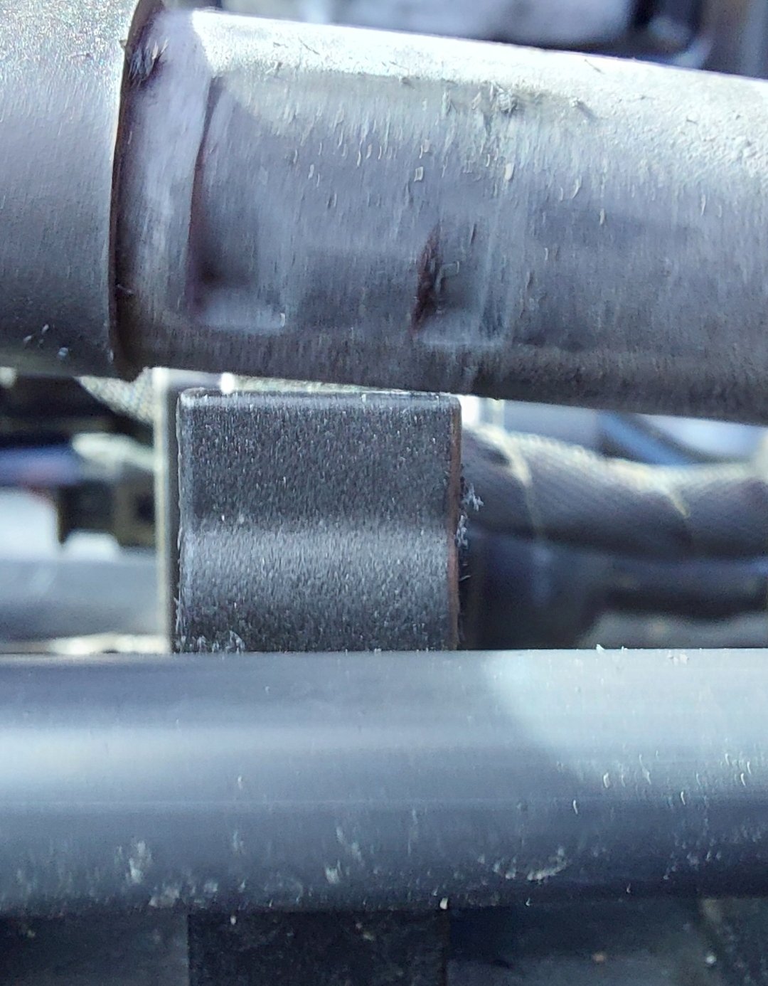

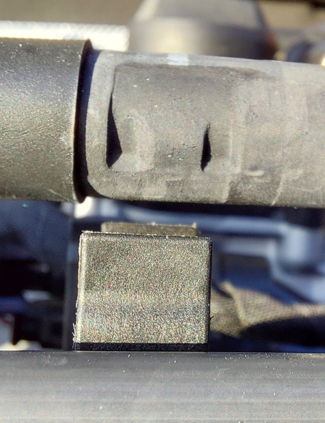

A new engine was fitted under warranty. However some vibration still remained which got worse over time. This I believe led to the next problem which was abrasive wear through vibration of the rubber fuel line from the tank to the high pressure pump where it's retained by the interference C clips on the inlet manifold. (My theory is the vibration on the new engine was caused by refitting the old flywheel from the damaged engine which was damaged by the old engine)
I only spotted the fuel line wear by chance as I could see rubber swarf around the area which I thought was odd. The line must have been close to wearing through as i cant imagine the wall thrickness is that great. This would have resulted in fuel at a few bar being sprayed over the top of the engine and only 40cm or so from the exhaust!
The fuel line was replaced under warranty but there was to be no investigation into the root cause so i had every belief the same problem was going to repeat and after only a few hundred miles i could see the same wear pattern occuring in the new fuel line. At this point I'd lost total confidence in the car and it's safety, and Skoda's ability and will to fix.
