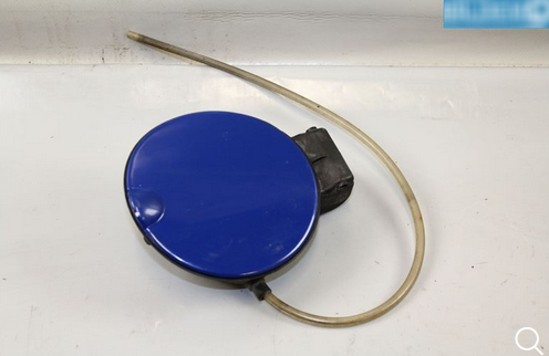

My car doesn't have a sunroof but I did notice a water drain pipe right behind the back bumper on the right side, maybe it's a drain for the fuel filler cap cavity?
Yes that's what that is. Apart from the scuttle drains there are obviously drain holes in the bottom of the doors but not much else to worry about really.
