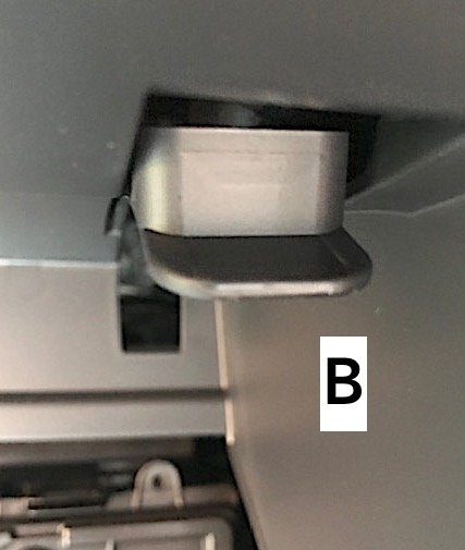

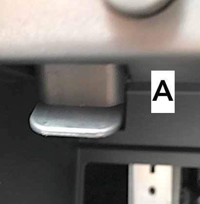

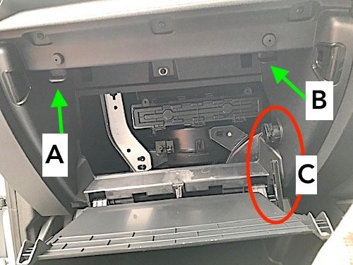

Should anyone wish to fully lower the glove-box unit on the PASSENGER side (to, say, replace the cabin pollen filter) this is what's involved.
This photo shows the glove-box unit fully lowered.
A and B are 'buttons' that need to be pressed upwards while the top of the glove-box is pulled forwards. The buttons are shown in more detail here

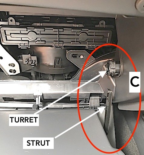

The glove-box will then drop halfway done, but will still be supported by a peculiar turret/strut mechanism identified as C in the first photo above and shown in more detail here.
Pulling the top edge of the glove-box unit further downwards (No need to pull hard!) will cause the strut to release from the turret (as shown in the photo). The turret is rotatable with a small plastic cog inside. When returning the glove-box unit to its original position, the turret must be in the correct position for the top of the strut to enter an aperture in the turret through which the strut slides. Once the top of the strut is in that aperture, gently lifting the top edge of the glove-box unit upwards will allow the strut and cog to mesh and the strut to click in place. Next lift up the top edge of the glove-box unit so that the plastic 'tabs' on each top corner of the unit come in contact with buttons A and B. Depress the buttons to allow the tabs to pass behind them and the glove-box can now be fully closed.

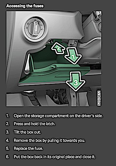

Soon after I bought my Fabia I checked where the fuse-boxes were. I could see the one in the cab to the rear of the small storage compartment on the driver's side, but I did not bother to confirm how straightforward it would be to access that fuse-box. When it became apparent from this forum thread (and from other UK on-line comments) that there could be difficulty removing the small storage compartment, I thought I had better experiment.

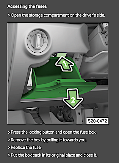

The relevant information in the hard-copy Owner's manual for my 2023-built Fabia differs from the "Access to the fuses" image you provided in your first posting above. This is the image in my cars paper manual and in the relevant on-line Owner's manual.
You'll see that no mention is made of a 'tray' and the instruction to "Press the locking button and open the fuse box" is potentially confusing.
It's perhaps worth observing that the equivalent image in the very latest English-language on-line Owner's manual is unambiguous and more detailed
but, despite following those instructions to the letter, I was still unable to remove the storage 'box' easily by pulling it towards me.
