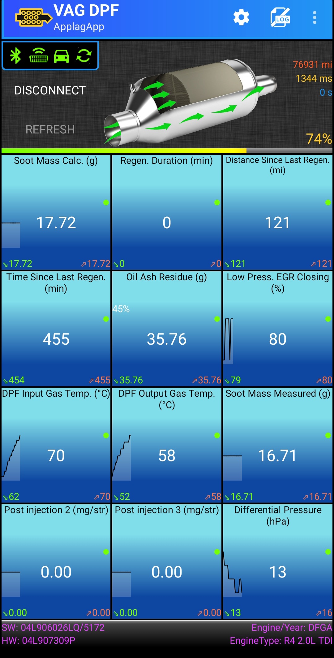

The dpf seems fine according to the vag dpf app and the differential pressures look ok.
Regen's are every 170 miles or so with town driving and complete with around d 5% soot content left.
The DPF has nothing to do with NOx emissions.
these are controlled by the SCR catalyst and adblue.
As much as someone may be able to assist based on fault codes over the internet, it has no promises of fixing the fault. Paying for a diagnosis is not always a bad thing as they will fully look into the fault using all data and codes, tpi’s and their knowledge to find the fault.

I didn't think  the dpf was at fault either.
My local VW Audi specialist told me the dpf was faulty and blocked but the readings  i've  obtained myself contradict his diagnosis.

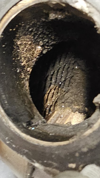

Turned out to be soot partially blocking the egr cooler as suspected. It was replaced with a genuine new one and new egr valve at a  cost of £1120. The code has not reappeared since. P2002 code has gone and also the odd appearance of the P20EE code that sometimes appeared at the same time.
Will be using dpf cleaning additive every few months from now on to try and avoid this issue again.
