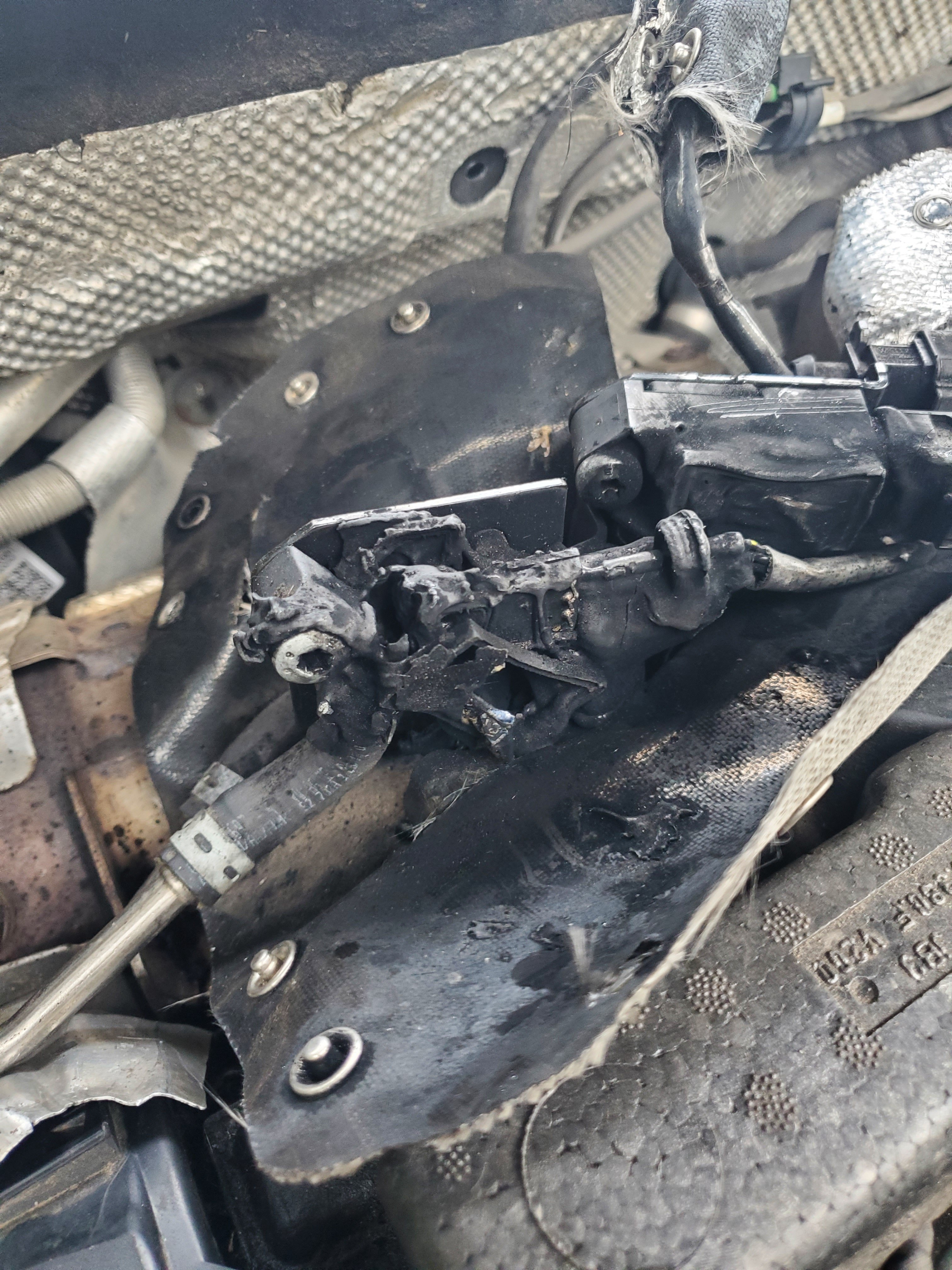

The time has come to do the cambelt again at 151k miles, as I opened up the heat shield wrapping on top of the engine, under the top engine cover, I found this mess.
Can someone identify the sensors, my guess is one is the dpf differential pressure sensor, is the other a load sensor ?
I had a MIL come on a couple of days ago, so this must be why.
Any advice/diagrams appreciated

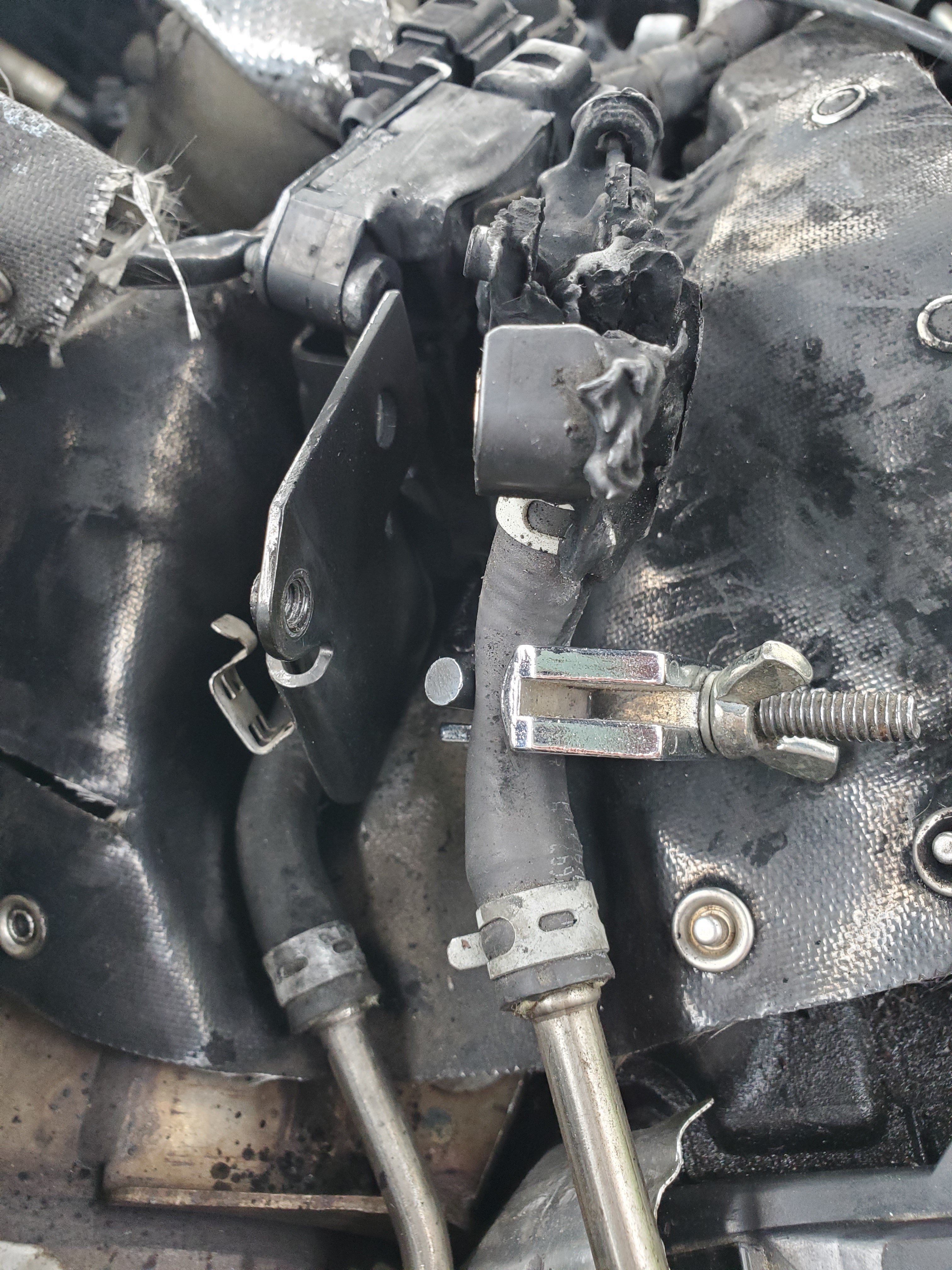

There's a sort of tinfoil bag with press studs normally wrapped around this sensor assembly, at the rear top of the engine. A couple of chrome pipes loop across the cambelt cover and feed up into 2 rubber pipes going into the foil/heatshield packet.
Bit of a mare of a job, but manageable.

The melted DPF sensor after a cambelt change is very often issue. It happens because the plastic hoses get brittle from the high temp over time and during the belt service these sensor hoses get broken.
Buy a new genuine sensor based on your car’s VIN. It’s very easy to fit if no other parts were damaged - just two screws if I recall correctly.
The new sensor also requires software adaption and you’re done.

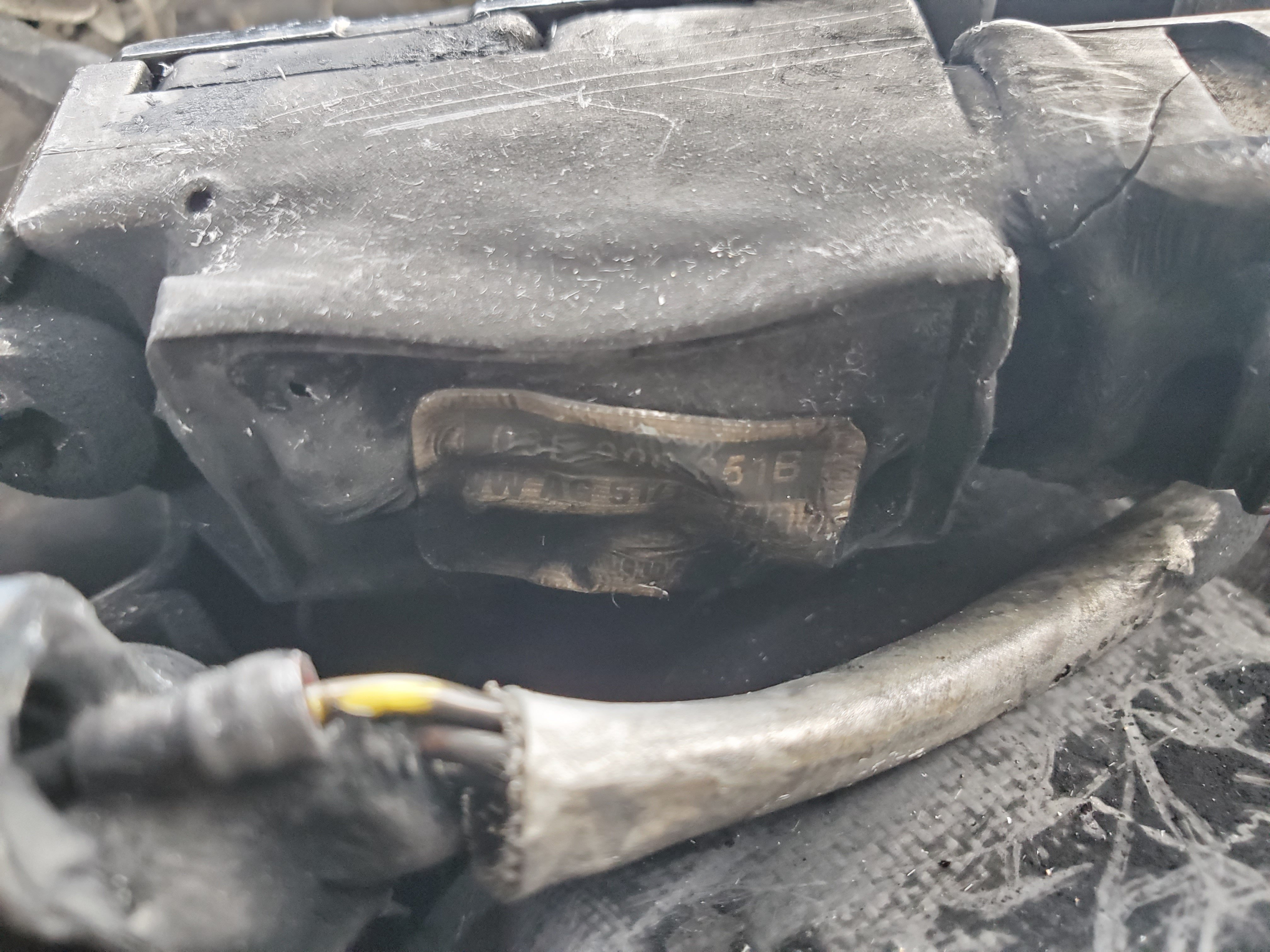

At least 2 plugs have melted, and the sensors they attach to are too badly burned to get a part number.

I've managed to clean up one soot covered melted ex sensor with a cotton bud and water, and can make out 03L 906  51B now.
There's a seller on eBay who sells them with a new plug and six inch long wire tails attached, so repair isn't going to be too bad now
For now I've clamped up the pipe where the exhaust gasses are blowing from. Car isn't needed for a week, luckily, and I use the motorway frequently so I don't think I need to worry about the dpf.

I can see why that might happen, but this happened all by itself, and was only discovered because I had a reason to take the engine cover off, so they seem to possess the knack of self immolation !
Someone decided to put a plastic sensor next to the DPF which reaches 500-600C.. Yes, there is a shield but it’s a poor engineering decision.
It happens from at least 10 years and there are cars completely burned because of this issue.
I feel that the position is fine. My guess is the sensing element degraded internally, allowing a hole to develop.
With a hole internally, exhaust gas is able to then flow through the sensor, transporting heat internally directly from the exhaust, to the sensor internals.
It has melted away from the inside out, not outside in.

I've found more info on another forum, seems quite common, and as mentioned previously the movement of pipes to remove the TB cover might cause the sensor port to crack.

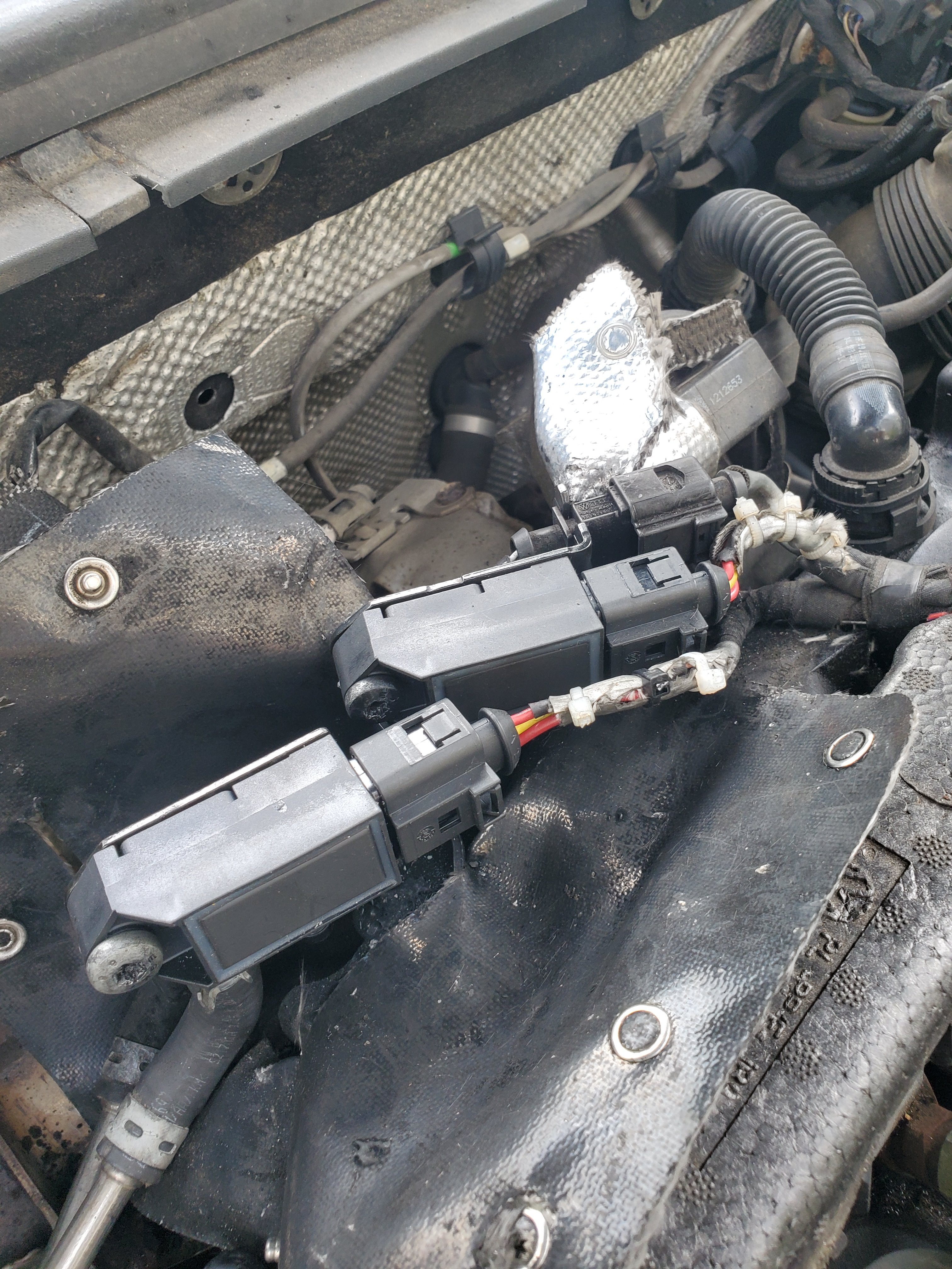

Came back from holiday and as expected the new sensors were here.
They're 'noname' brand, or unlabelled Bosch (who knows ?), purchased instead of originals due to the new plugs and wire tails which came with them, so that I can get back to work in the car tomorrow without having to waste time sourcing new plugs etc.
It took under an hour to splice, solder,wrap and seal the wire transplants.
Once the car started the codes were cleared, and by the time I drove to the nearest motorway the oil temp was warm enough for a regen to begin as soon as I hit the motorway. I've done a few stop/starts, and battery-off reset, no codes, all working fine. I'll monitor how often it regens and then consider doing a sensor adaptation if it needs it.
MPG reading has increased (better economy) back to where it previously was.
