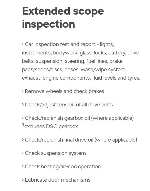

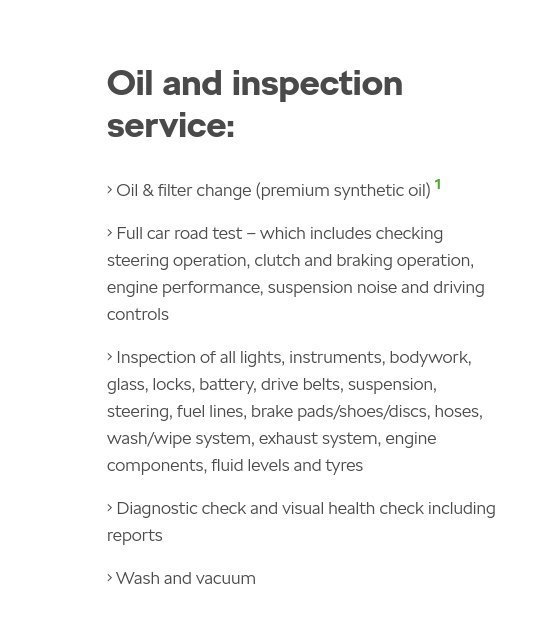

All you can do with the DSG is drive and see if it feels OK.
What is the full service history of, is it to manufacturers recommendations, guidelines or schedule.
@ 80,000 miles it should have had the 2nd replacement of spark plugs.
The brake fluid would have been changed at 3 years and due again at another 2.
The Air Filter might not even have been looked at.
That is the thing with Service Histories, you want a record of stuff done, not the stuff not done.

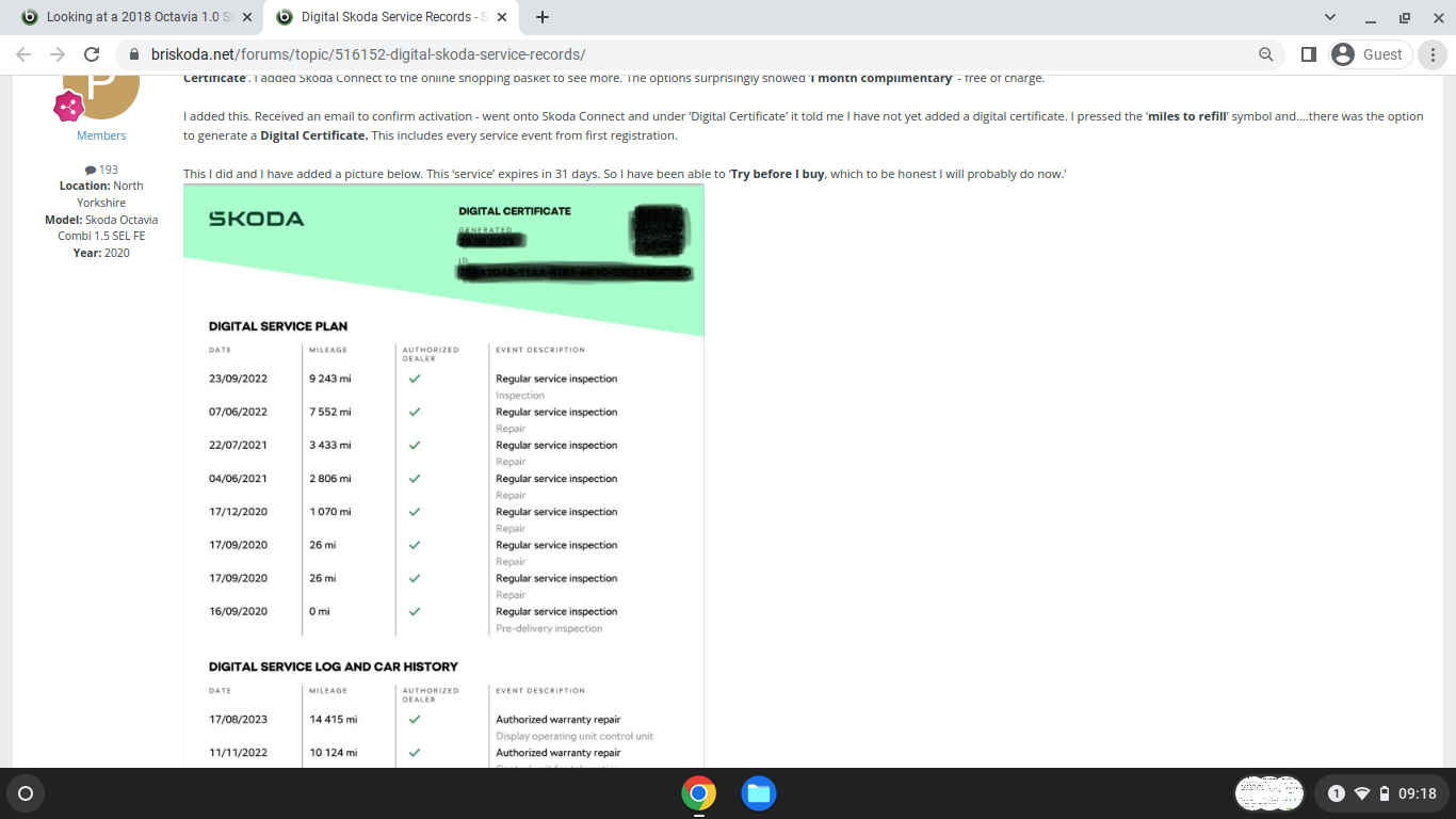

If the 80k car has a full main dealer service history should I be able to get details from my local Skoda dealer as to the work carried out if invoices are not available?
You most certainly can get the service record as they have it on the system.  http://briskoda.net/forums/topic/516152-digital-skoda-service-record
Ask the salesperson to send you the Service & Warranty history before you go see the car.
It might show Oil & Inspection Services & extended scope.  Great if they have the additional work done. shows a AC service or stuff customers get told is due.
