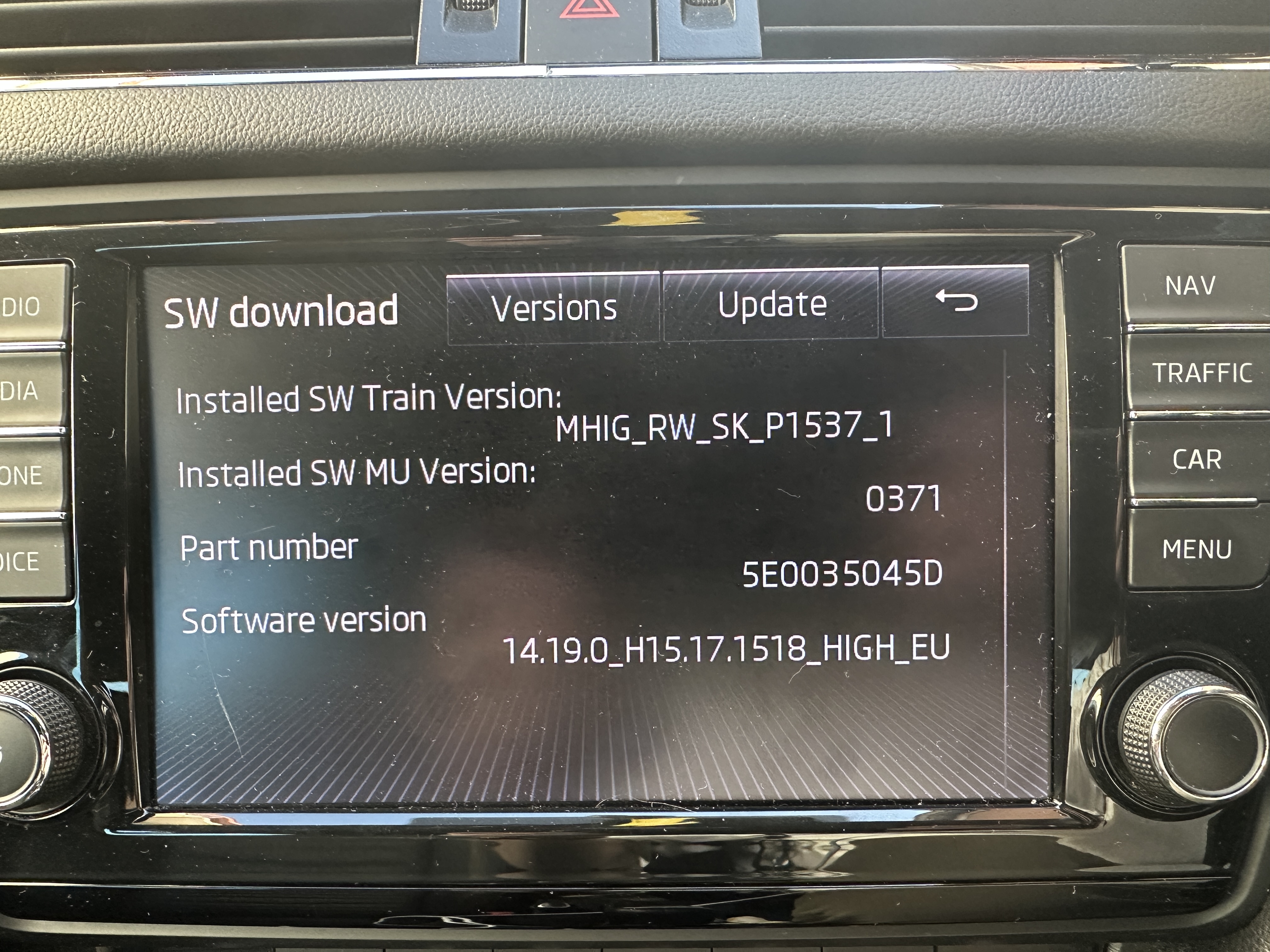

My current train version is MHIG_RW_SK_P1537_1
software MU version is
0371
and software version 14.19.0_H15.17.1518_HIGH_EU

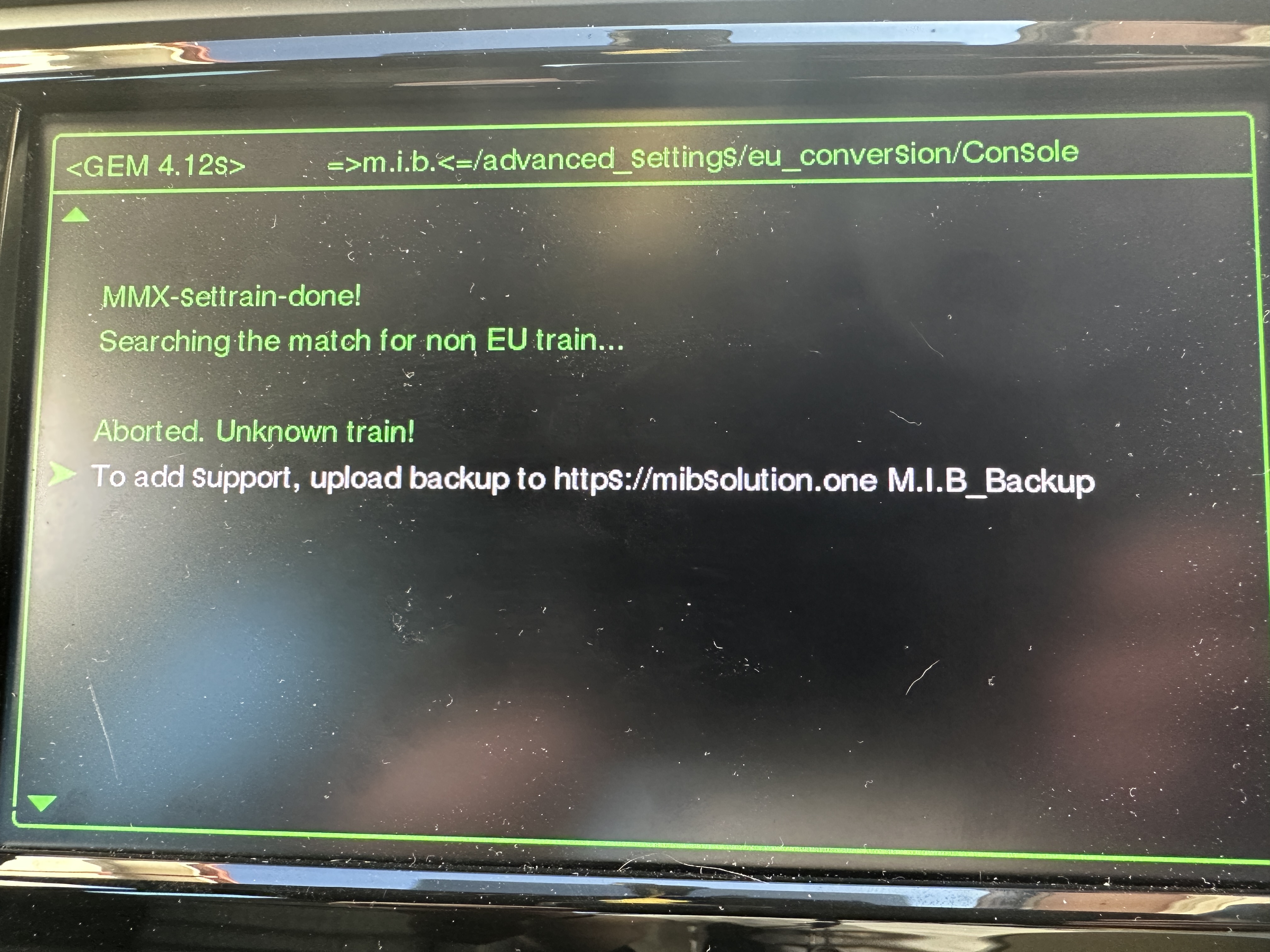

So far I have established that I need to do a conversation to EU in order to flash a patched version, as there are no appropriate patched versions for my existing train. When attempting the EU conversation I encountered error “
Searching the match for non EU train...

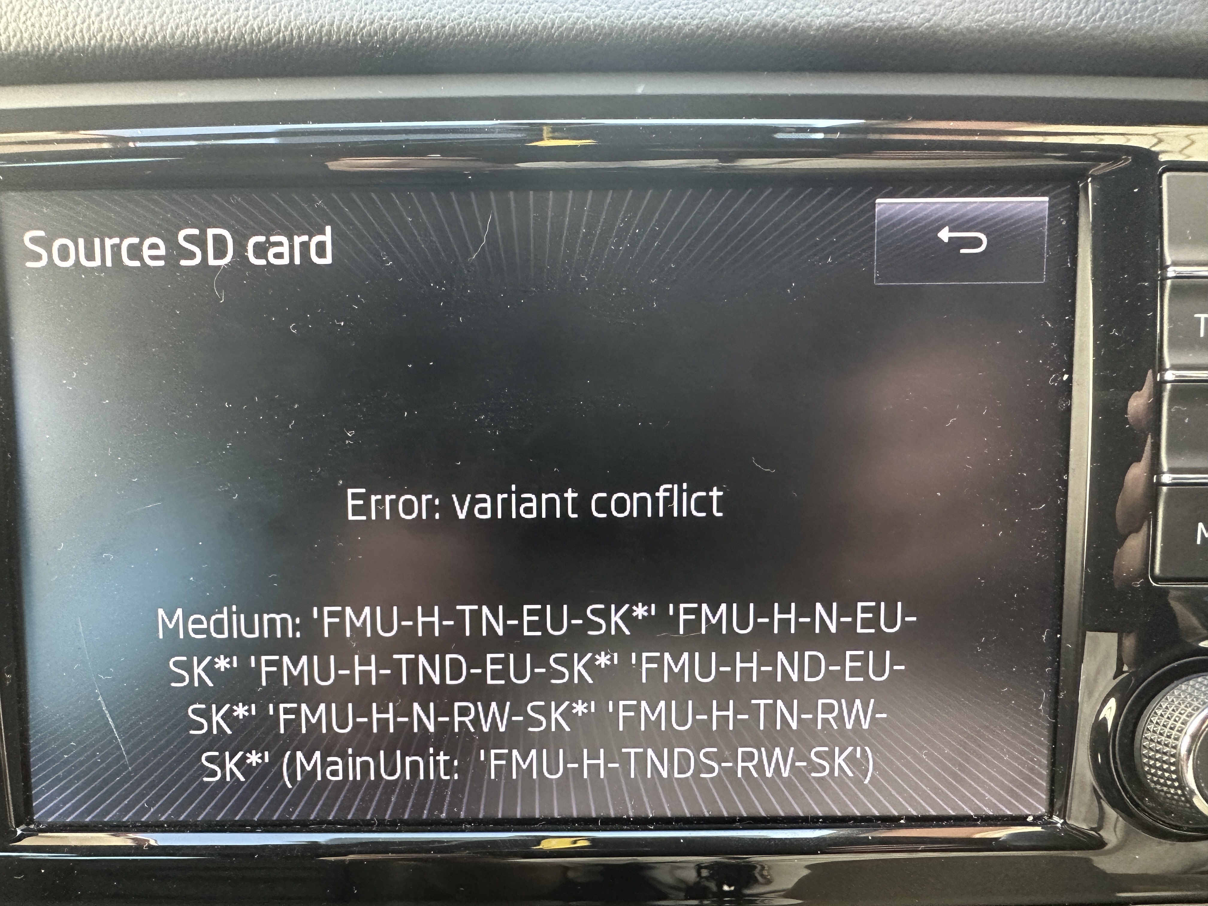

Aborted. Unknown train!” and since established that I need to update my existing train to a newer version before I can convert. There is one file on mibsolution.one (MHIG_EU_SK_K1552 MU0411)  that contains both the EU files and the RW files, however when I attempt to update to this firmware I encounter error
“Error: variant conflict
Medium: 'FMU-H-TN-EU-SK* 'FMU-H-N-EU-SK* 'FMU-H-TND-EU-SK* 'FMU-H-ND-EU-SK*| FMU-H-N-RW-SK* 'FMU-H-TN-RW-SK* (MainUnit: 'FMU-H-TNDS-RW-SK')”
At this stage I found a comment suggesting I need to edit the metainfo of the update file and I have done so, adding “FMU-H-TNDS-RW-SK” to the metainfo txt file. My problem now is that after editing the txt file and reinserting the SD card into the car slot, I then get the “unable to read card” error.  I’m assuming that by editing the txt file on my windows pc that I’m somehow screwing things up.

added this missed screenshot for the EU conversation error
