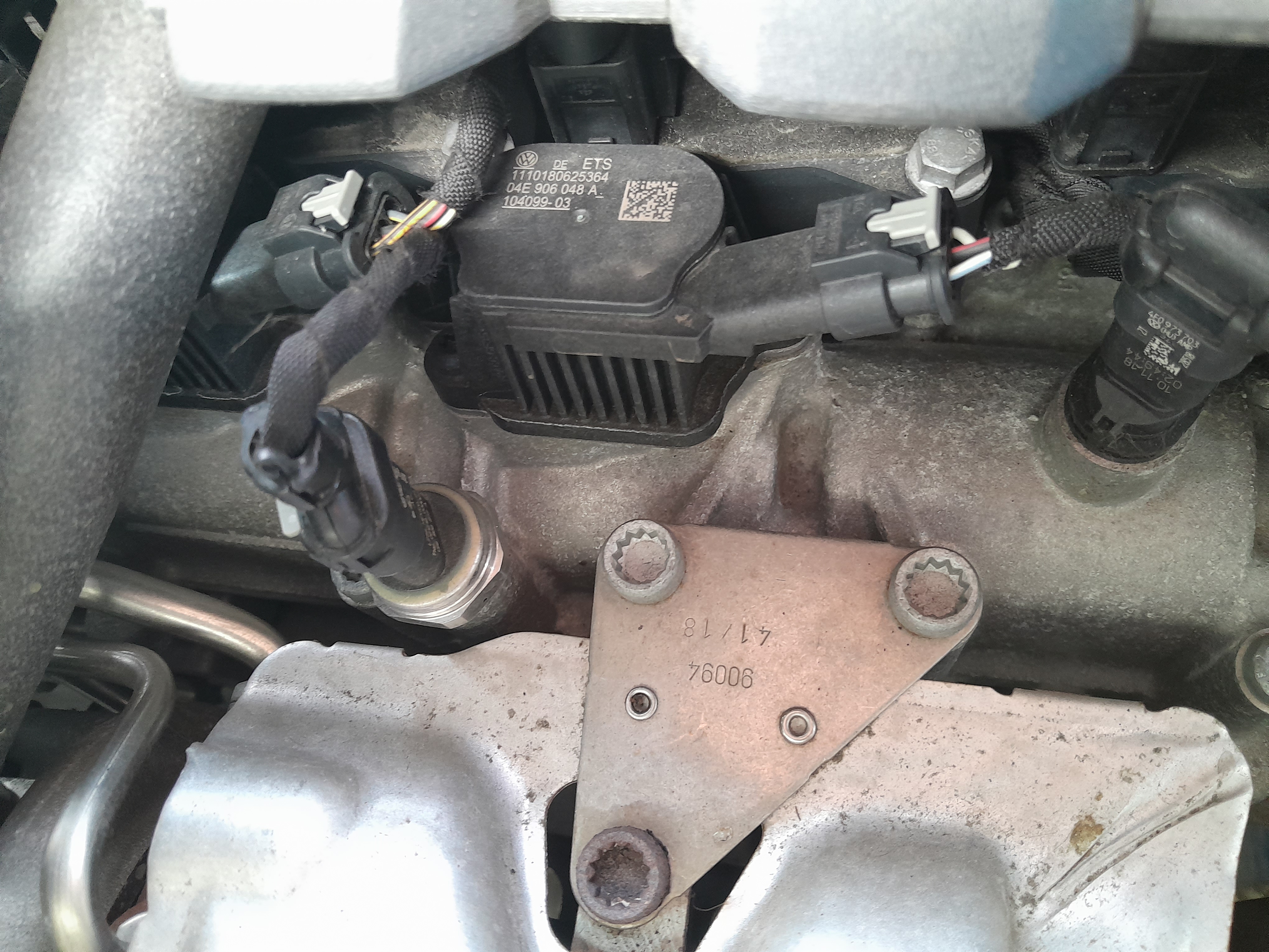

I'll check under the engine bay for the coilpack or packs.
I'm no vag expert, looks like single coilpacks, bit hard to see with the plastic cover on.

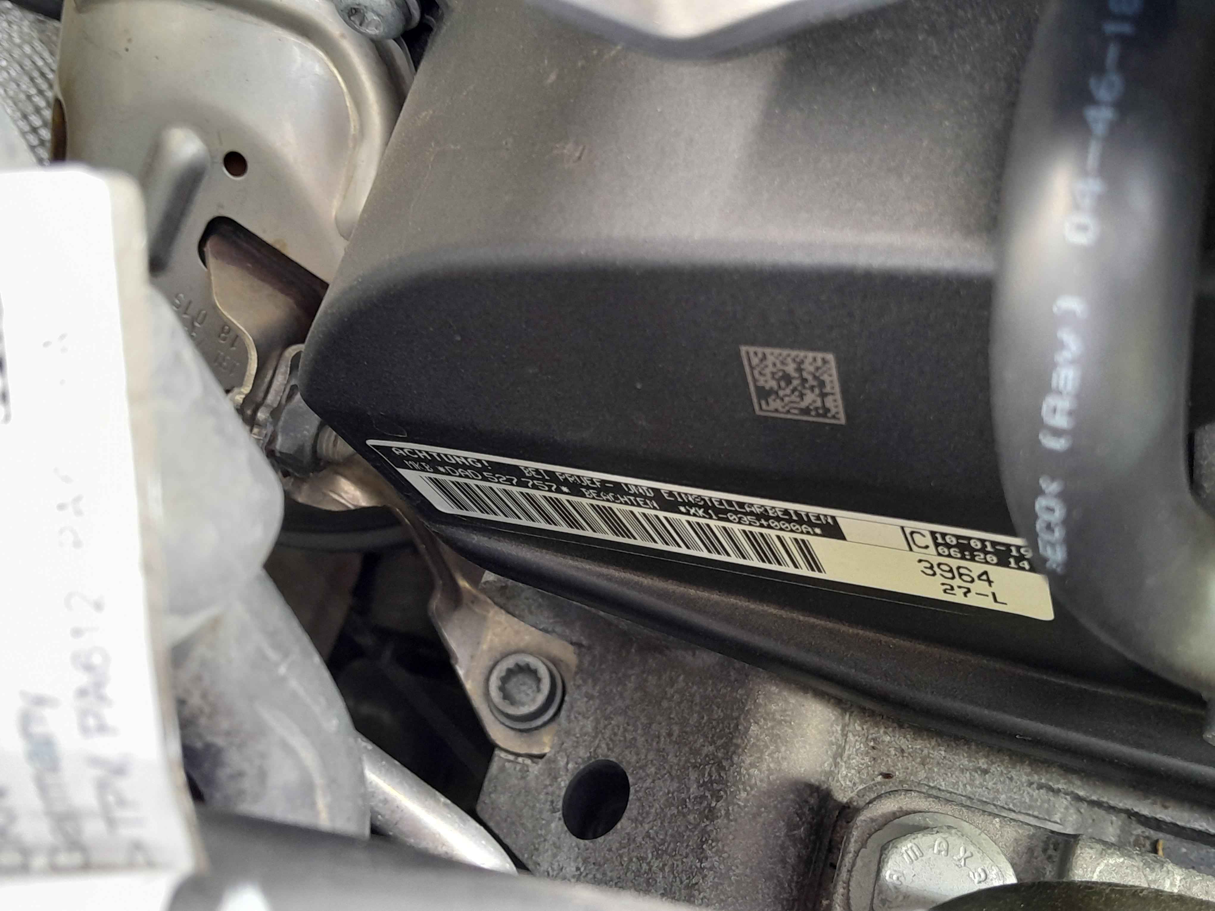

That doesn't look like an engine code. There may be a sticker on the cambelt top cover with engine number on, as well as it being on the V5c.
I think it will be three or four letters starting with a D.

I took it from engine code on the v5. Do you mean chassis number?
I'll have a look on the Cambelt cover.
As I've had generic codes relating to multiple missfires, maybe not be a coilpack then? If they are single packs. Cars still driving A1.

That any good?
Also pic from rear of engine cover.
Edited by Phoenixboy
  • Sponsor
Yep, DAD is the three letter version of your engine code, on the bottom row.  The fourth letter usually is a power variant so A for lowest power of that code, B for next one up, etc.
Handily, that's a match for the diagram I mentioned above, so confirms individual coilpacks.
