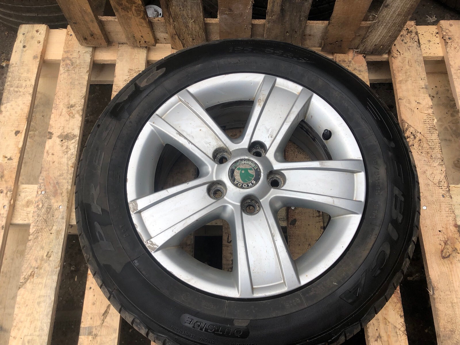

I've had a look at the Skoda parts catalogue, and it lists a 6.5Jx15 ET50 alloy rim. Maybe 205/60R15 was a standard fitment after all.
6.5Jx15 ET50 5/112 57.1 alloy rim 1Z0601025S 7ZS

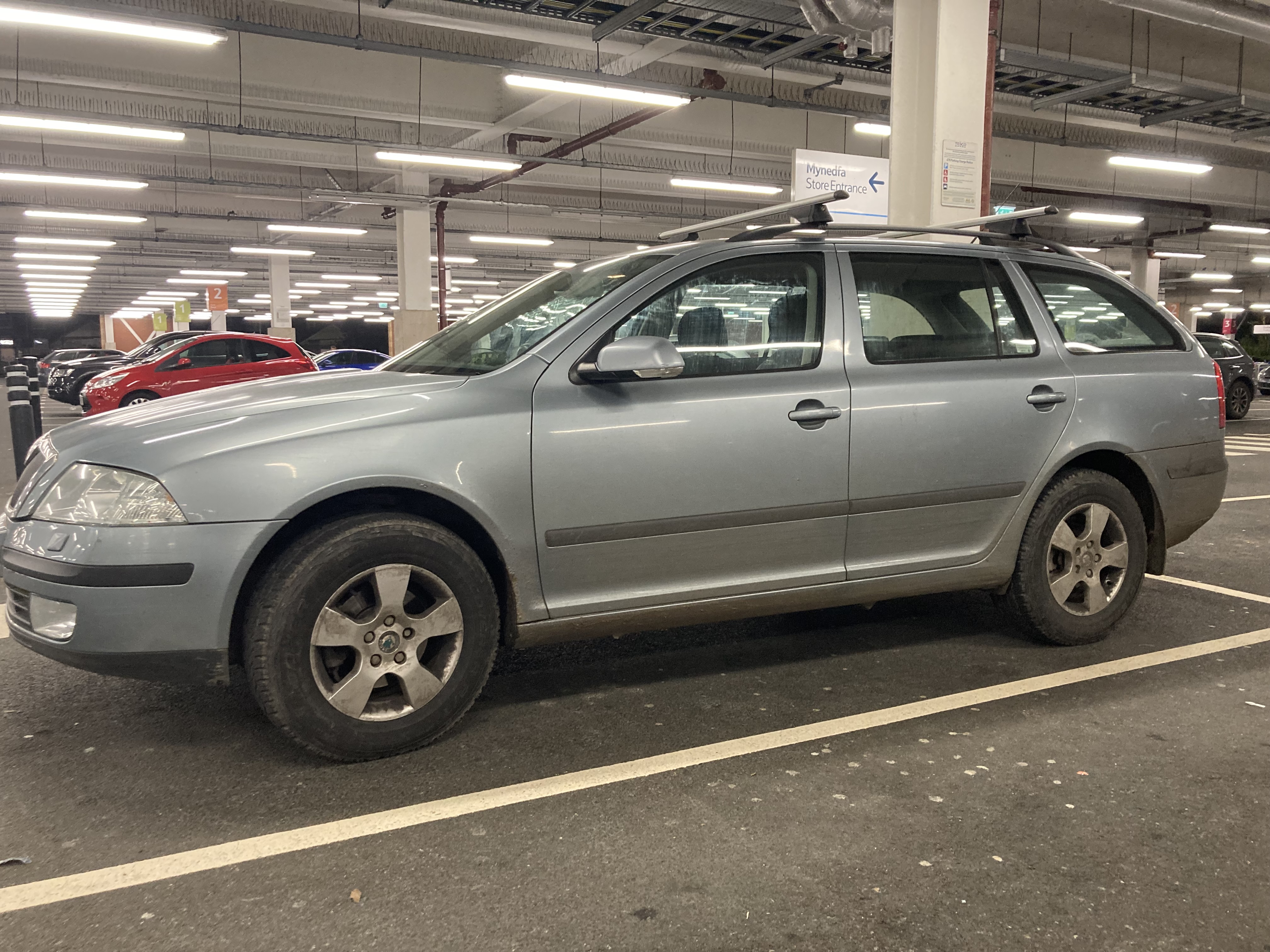

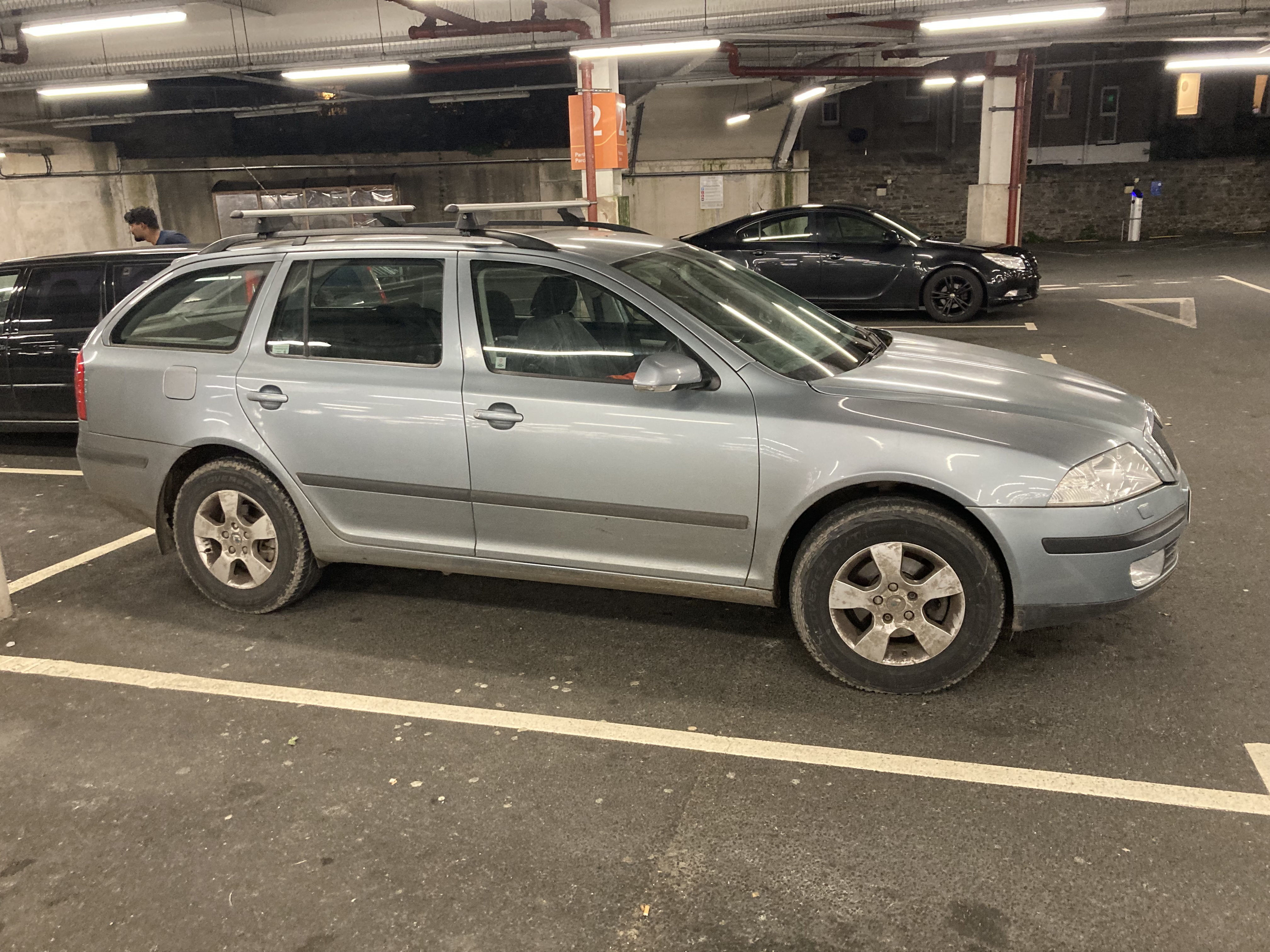

The 205 70 15s fit very well, these are Cooper AT3s. The gearing is noticeably higher but not excessively so.
The ride has improved and there is about 20 to 25mm more ground clearance which is useful for some of the places I go, and park.
