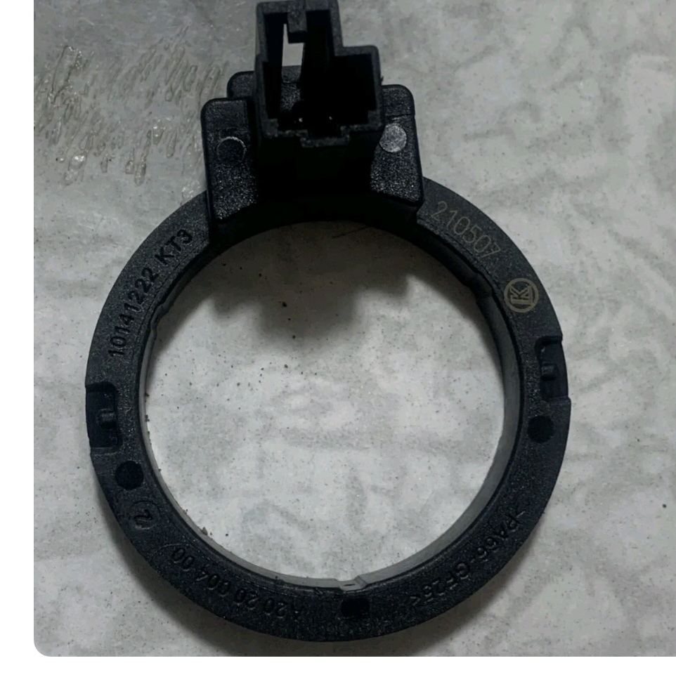

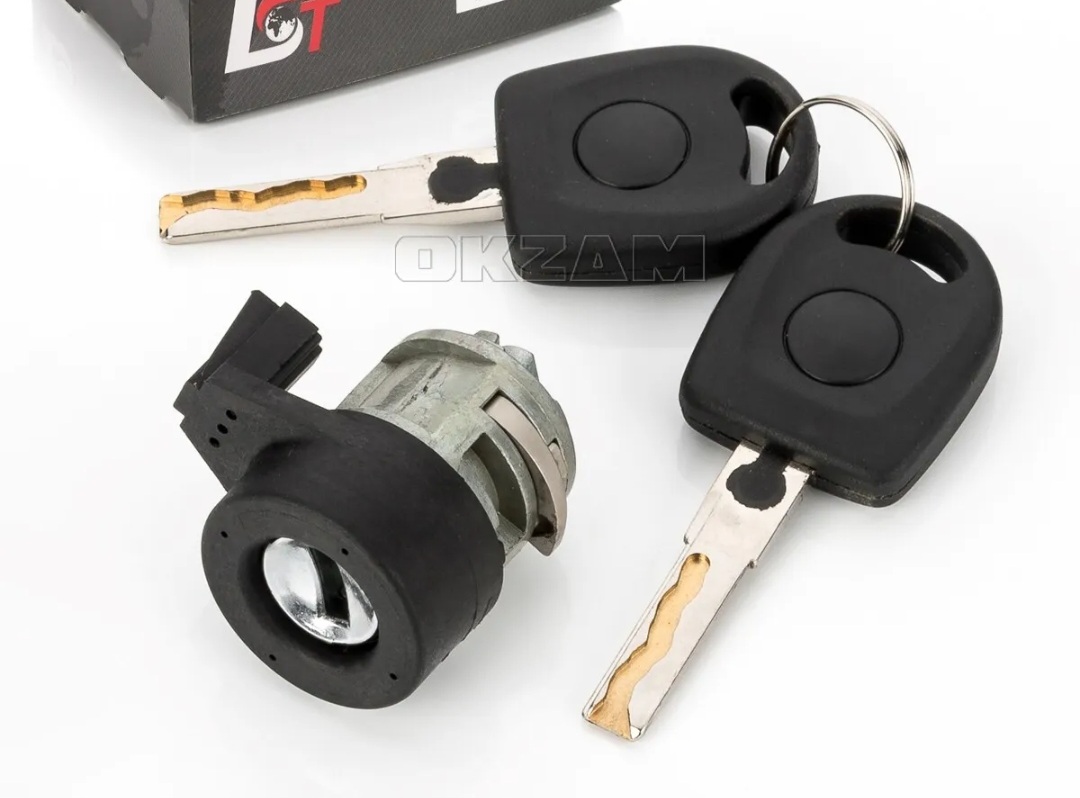

Looking at my ignition I have the type below. Looks like I can't replace just the reader?
If I brought this below would the keys need coding to the car vi's vcds?
If your electrics are faulty that won't help.
I was going to replace just the key reader as first port of call.
Can I not do that on this type?
Have the car scanned or start firing the parts cannon if you have deep pockets.
Fair point, but for £15 I thought it was worth a go.
But just to confirm, am I looking at two different types of key readers?
IDK
