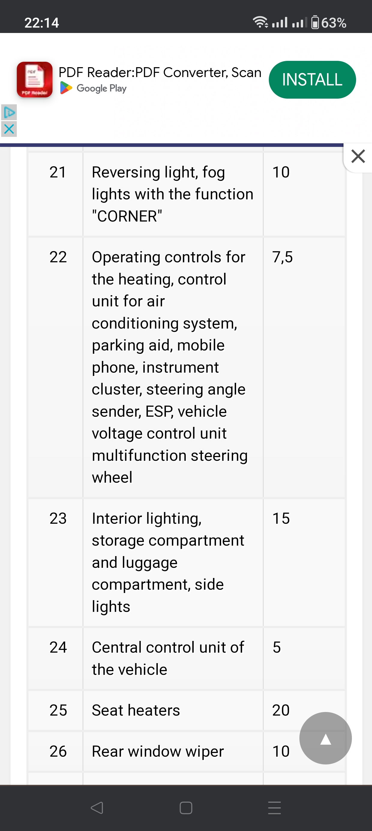

Have a skoda fabia 1.6tdi 2011 and the bulb fault comes up, found out fuse 23 under the steering wheel was blown, replaced it but when ignition it sparks out, most of them blew out while putting them in, I disconnected the interior light housing, still no joy.
I do appreciate the wiring shorts can be like finding a needle and haystack and every case is most probably unique. Saying that if any one amongst our group has had this experience solved or someone can point me in the right direction I will be thankful, interior light I can easily do without but rear side lights are safety thing.

A brief look at wiring diagrams suggests that fuse 23 is only interior lighting, inc glovebox and boot light. Where have you seen reference to tail lights being on it?
Changed lights in the rear cluster so checked for water and wiring all seems ok.
Breezy Pete, I found the fuse diagram on this website, photo attached below, plus both side lights have gone out with this fuse.

Are the front sidelights working?

Sorry mate had to what for the car to come back, that's a good call as I never checked. Yes front side lights are not working, so both front and rear side lights not working.
