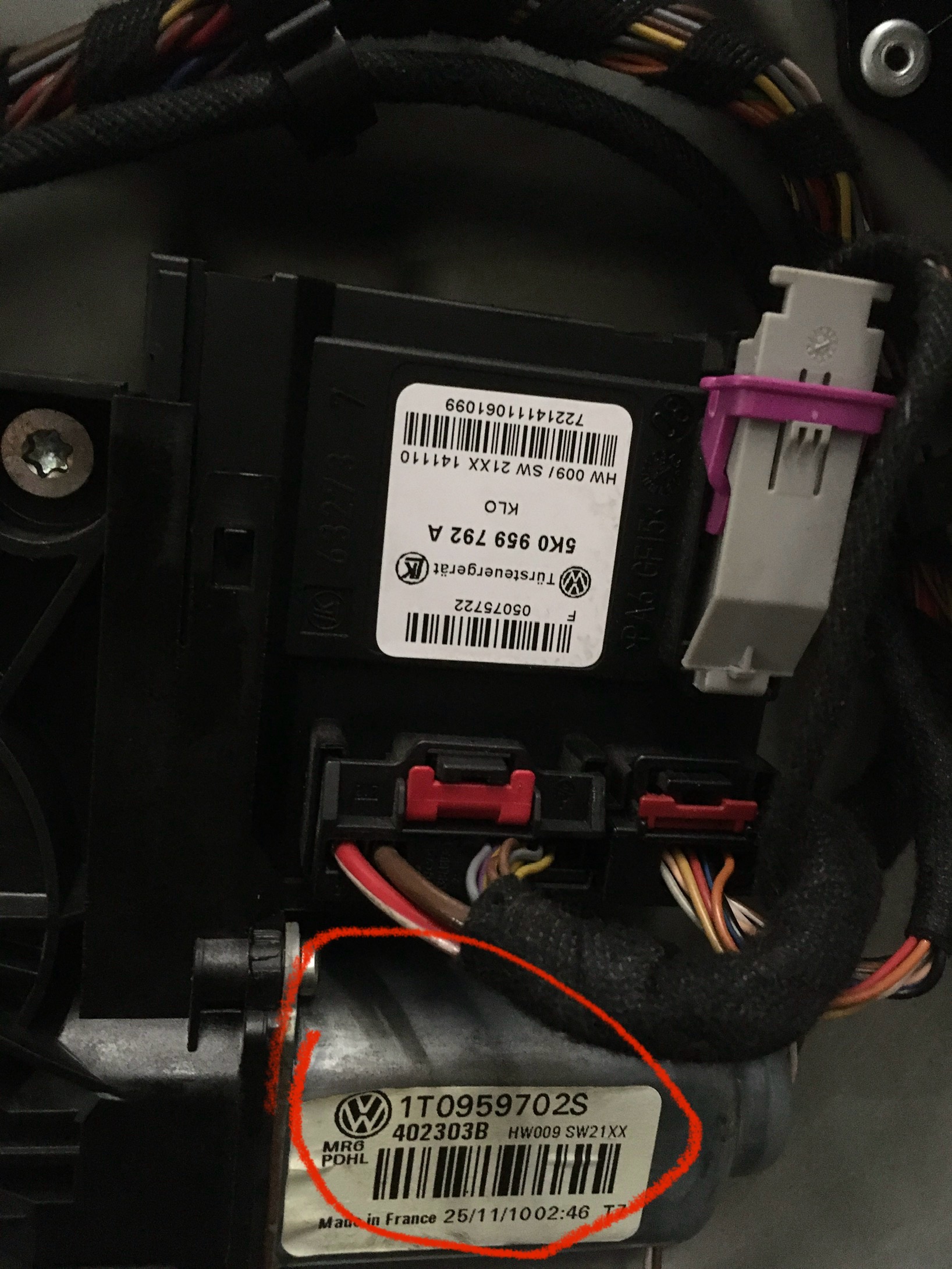

Hi guys im new on this forum,i need some help about my window motor.My window motor died in my Skoda octavia rs mk2 facelift version. The front passenger side died the part number is 1T0959702S is the part number. I dont found any of with the letter “S” my question is only parts with end “S” will work good or other part like “B” or “D” ending would work. Thanks for helping.

Sadly the electronic parts work well,one of the gear teeth inside the motor broken
