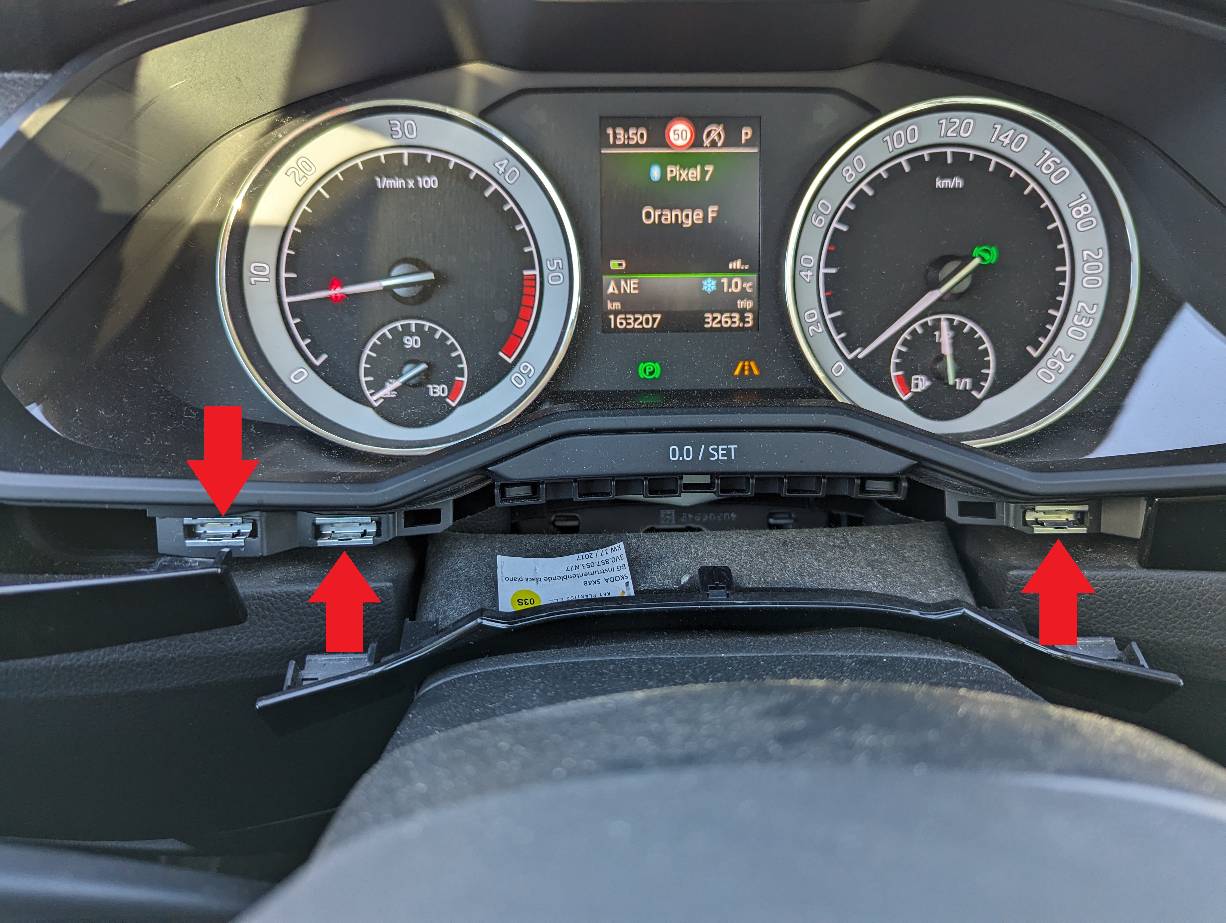

Mine (MY17 tdi 150 L&K combi) had annoying rattles in the center of the dash too. Could hear them especially on low accelerations with load.
After removal and sound insulation of various parts of the dash (including the top speaker grill, the infotainment screen, the gps module, etc, with adhesive foam tape), I finally found what was rattling on mine.
It was the piano black trim fasteners along the dash but especially the one on the left of the infotainment screen (french car, so between the steering wheel and the screen, not shown in the picture below).
Several clips were not secured enough on the trim pieces: they stayed in the dash when I removed the pieces.
I took these clips out of the dash, secured them tightly on the trim pieces with needle nose pliers: they are now tightly fastened to the trim pieces and I have no more rattle in the center of the dash.
Might not be the case for yours @M00t1 but, if you haven't tried already, it is worth giving it a go. It is costless and easy to do (I used a plastic pry tool inserted vertically between the trim pieces).
