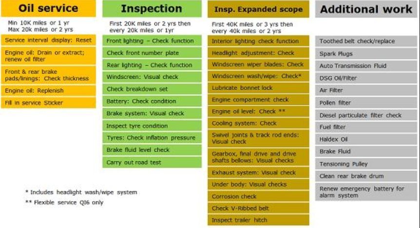

Welcome.
Get the oil up to operating temperature and then change the oil and filter.  Carefully.
Maybe pumping out the oil via the dipstick tube, then change the sump plug and see what if any oil / gunge comes out.
Test the Coolants strength / ratio with a test kit.
Fuel filter.
Air Filter.
Pollen Filter.
Brake Fluid.
