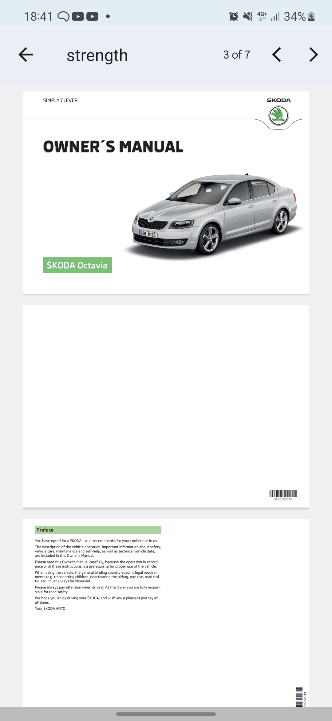

I've got this PDF manual but none of that text appears anywhere in it
On the 1st page of this forum, 4th topic down > owners + workshop manual. On the 1st page there is a link to download the manual. Lane assist starts on page 146.
I've eventually figured it out. There's a line under lane assist option that says 'dynamic lane assist' or something like that. But it's just on or off - no variability option so I must have a different version of the mk3
