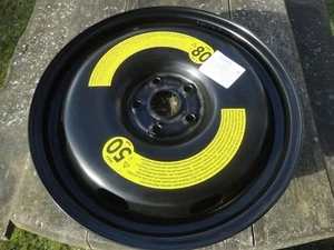

You can order the below spare wheel kit from a VAG parts department using OEM part number 57A093860C. 3,409CZK is about £121.31.
The 3.5Jx18 ET25.5 5/112 57.1 steel space saver rim is normally fitted with a 125/70R18, but this tyre size has an outside diameter that is too small for the Karoq 4x4 because it's really an Octavia MK3 spare saver tyre that Skoda has simply repurposed for other cars rather than selecting something more appropriate. This is probably a cost saving measure. I suggest you use this spacer saver rim but with a bigger outside diameter 135/80R18 space saver tyre. This will closely match the outside diameter of the 225/60R16, 225/55R17, 225/50R18, 225/45R19, Karoq 4x4 standard tyre sizes.
Continental 135/80R18 space saver tyre
https://www.mytyres.co.uk/rshop/tyre/Continental/sContact/T135-80-R18-104M/D-123378
3.5Jx18 ET25.5 5/112 57.1 steel space saver rim 1K0601027AP03C 5Q0601027BC03C
GENUINE VW AUDI SKODA SEAT SPARE WHEEL RIM SPACE SAVER 18X3.5J 5Q0601027BC03C
https://www.ebay.co.uk/itm/234787975693
Karoq 4x4 spare wheel kit (includes foam and jack, ie. everything except space saver wheel) 57A093860C
18" Spare Wheel Replacement Kit
https://eshop.skoda-auto.cz/cs_CZ/sada-pro-vymenu-rezervniho-kola-18/p/57A093860C

Carlston, while not a specific question I asked, i really appreciate the information you've given me and the time it took you to put it together as in fact since the post, I've considered maybe we do add a spare wheel kit for certain journeys, and maybe remove for those where need absolute maximum boot capacity and rely on inflator kit on those should the unfortunate need arise. in this case I would need to have two sizes of dog guard boot divider and boot liners, but am ok with that. One appeal of the Karoq was the boot space in it considering the over all package size of the car, but till we have used it a bit, taken the dog out. Weekends, weeks away, with and without children won't really know. From a standard day to day, no spare fine. Again as I said Carlston absolutely great information for when and if I do need to add the spare wheel kit. 👌
