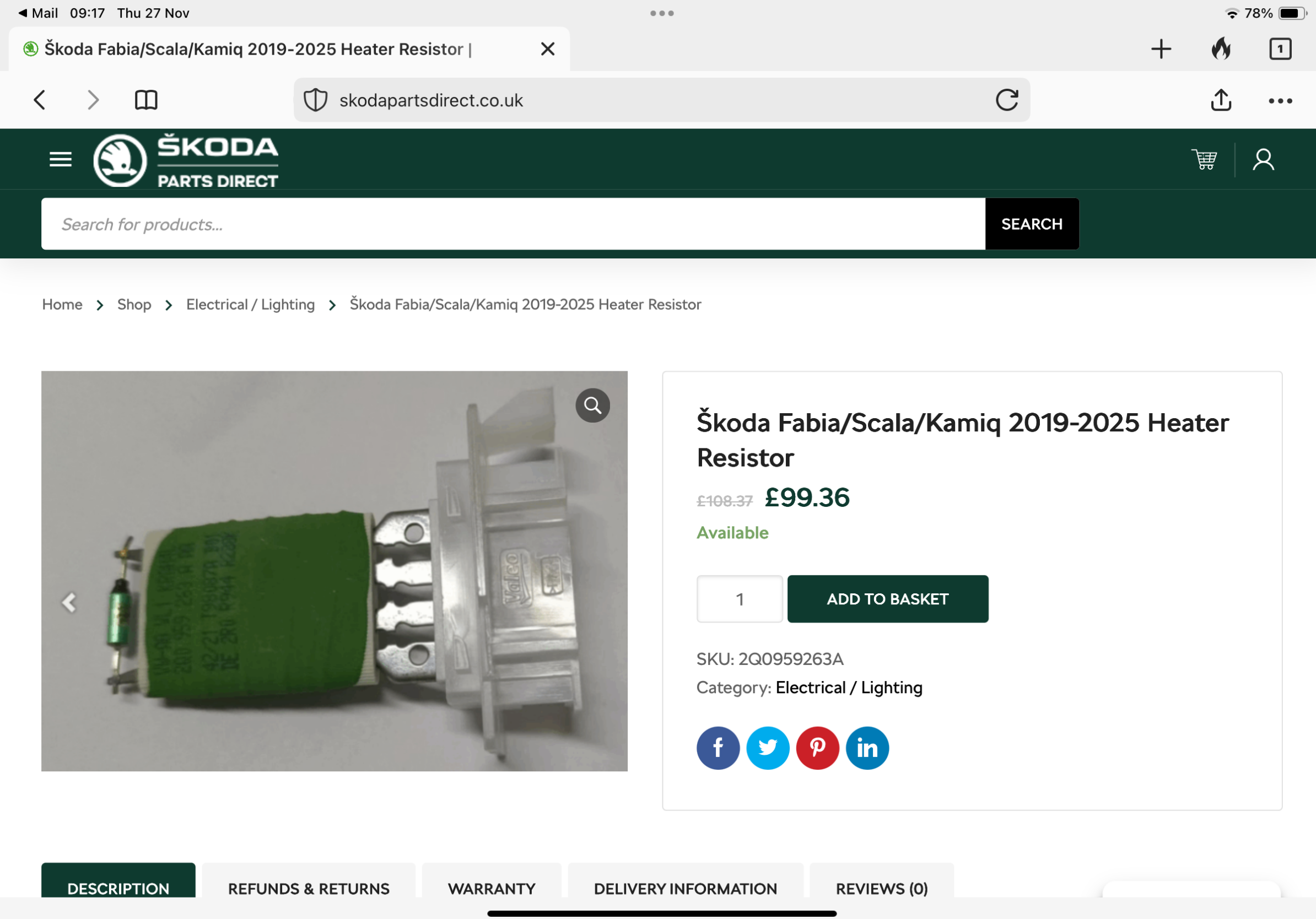

Where did you source the replacement resistor pack you hope to replace?, I ask because I couldn't source the proper one, (as a spare), from anywhere else except from the main dealer, I will just get one there if/when another one packs up. I'm convinced this problem has something to do with the resistor pack, maybe this thermal fuse which is generally found to be blown. I don't think anything has changed for decades in the fan speed control (for VWs) at any rate as you can see by the figures, below, for a 9N Polo. I was surprised to see that resistors are still being used in this day and age for speed control, I seem to remember that years ago Ford were using PWM (pulse width module) control, wonder if they still are.

Good afternoon, SUCCESS that has fixed it, I got the part from Skoda Parts Direct part no 2Q0959263A it was expensive but it’s fixed it 👍 the only issue I have now is the airbag warning light is on, I’m assuming because I unplugged it on the side panel, in fairness I didn’t really need to unplug it as the wire was long enough to for me to undo the 2 panel clips but thought it best to get it out of the way, all in it took about 30 minutes from start to finish, I don’t suppose anyone has any idea how to reset the airbag light please? Many thanks for all of the comments above, it’s very much appreciated, cheers Paul
