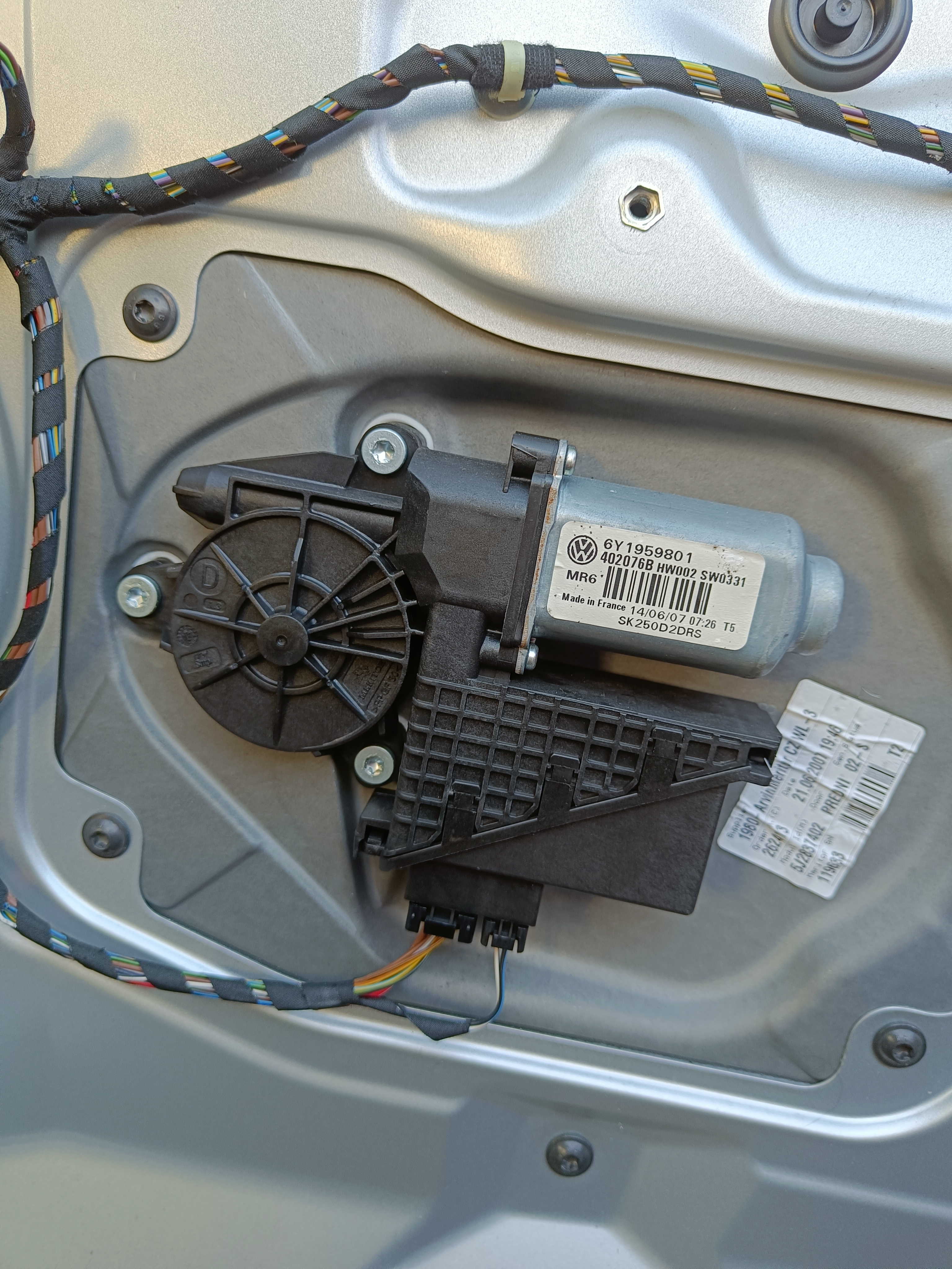

Yea, I suspected the window problem might be a motor/module fault but was hoping it was something simpler. Do you know if the motor and module is 1 part or two separate parts? ie, would I need to replace the motor and module or just the module?
  • Sponsor
It's all one part, 6Y1959801 for a 2007 RHD mk2 with just front windows electric. Repair probably cheaper than replacement. See link in my signature.
Well, I've had the door card off, you were right about the part number. And yes, the part is more expensive than I thought. I couldn't find your signature or the link, I'm assuming it took me to an auto electrician who repairs these modules?
