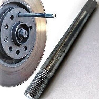

@m18rusif changing wheels at home (unless you have a lift ) because VW use silly bolts instead of wheel studs for the sake of your back I suggest you buy and use one, or better still two, wheel alignment tool, or two or four if swapping front wheels to rear.
Below is just an example, plenty around to chose from, I've no idea of the quality of finish of this example. - https://www.ebay.co.uk/itm/223480382915
