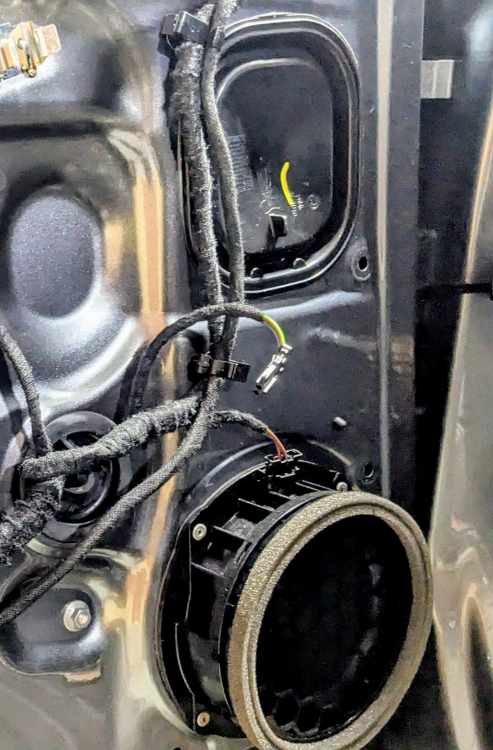

My front left passenger speaker has blown and just bought a replacement. Superb is a 2016 SE-L.
Seen the video on how to remove the door card, but was looking for some guidance on fitting the new speaker. First of all is it a simple unscrew job and secondly, not sure how the connectors work as my new one looks a soldering iron job (like I say, new to all this).
Any help appreciated.
Cheers

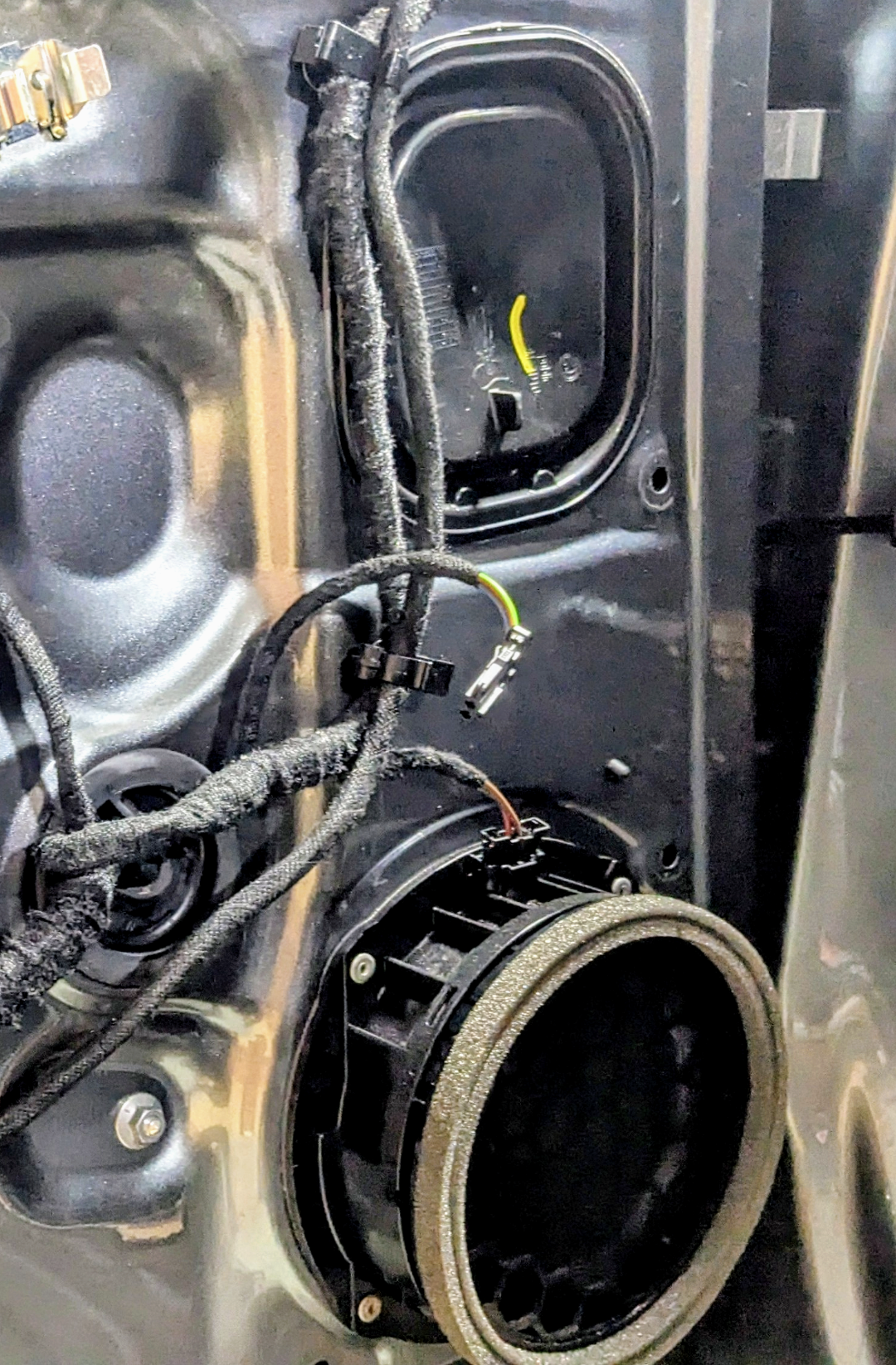

The speakers r riveted to the door frame.
U can also see the connector in the pic.
Thanks mate. Will drill the rivets out. I missed the side connection and looks like it's just plug and play basis the pic. Many thanks 👍
Hoover the door out so you don’t get any rattles after drilling the rivets.
Great tip! I'll do that as I'm pretty sure the resulting rattles will have driven me mad 😂. Thanks 👍
