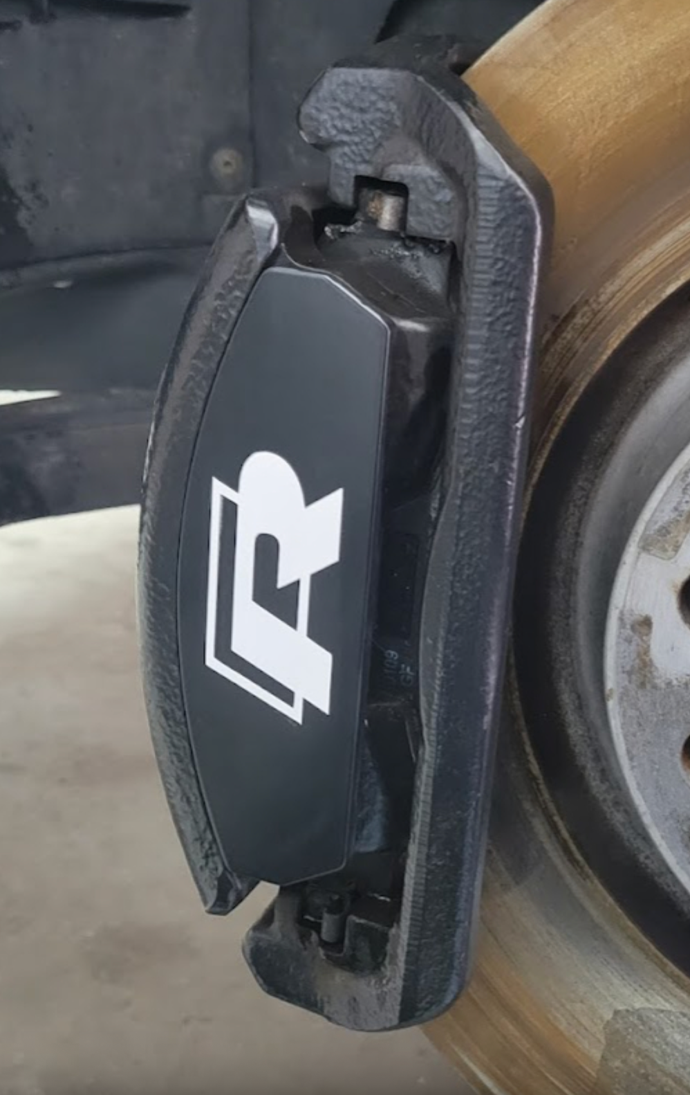

Most brake pads designed for the VW 340mm brake setup are made for the Golf R which has an anti rattle spring image.jpeg.3bffe8c8ea47f948570174d40c3ff5a3.jpeg
The calipers that Skoda use don’t have this and cannot fit them thus a lot of aftermarket pads not having shims that fit quite right.

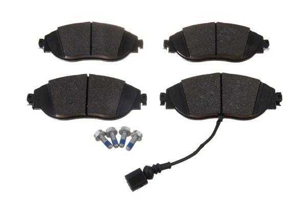

Hi Zac, thanks for the info. The front pads they showed me look nothing like this, but more like this:
@simonharper the image I posted is the anti rattle clip used on the Golf R for the brake pads which are supposedly interchangable with the Skoda 340mm calipers. But as the Kodiaq doesn't have the mounting point for the anti rattle clip (different casting), this causes some play in the shims on the side.
@ZacDaMan72Ahhh... got it. The pads the car came with never rattled, only these new ones (not from Skoda as to was vastly more expensive) which I can't imagine are made to the same tolerances. ETB have said that they have not had other Kodiaq's they've used the same Doscs and pads on rattle. I have no reason to think they are lying. I personally think my dealer needs to investigate more closely. The clunk/rattle sound is louder toward the centre of the car and if the other wheel hits something I can cause a less loud more muted rattle as I believe its shaking the left side too where the issue lies.
