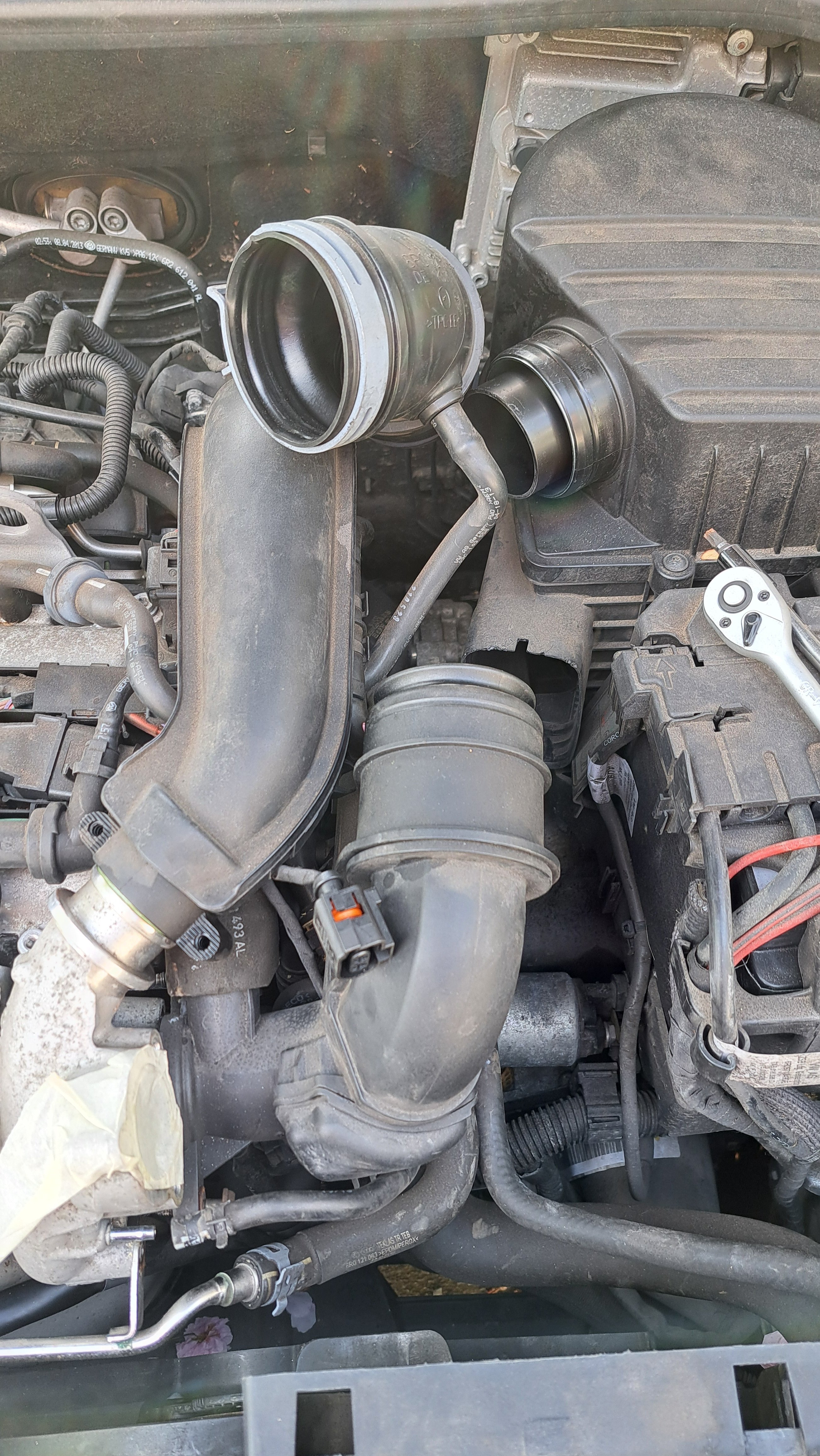

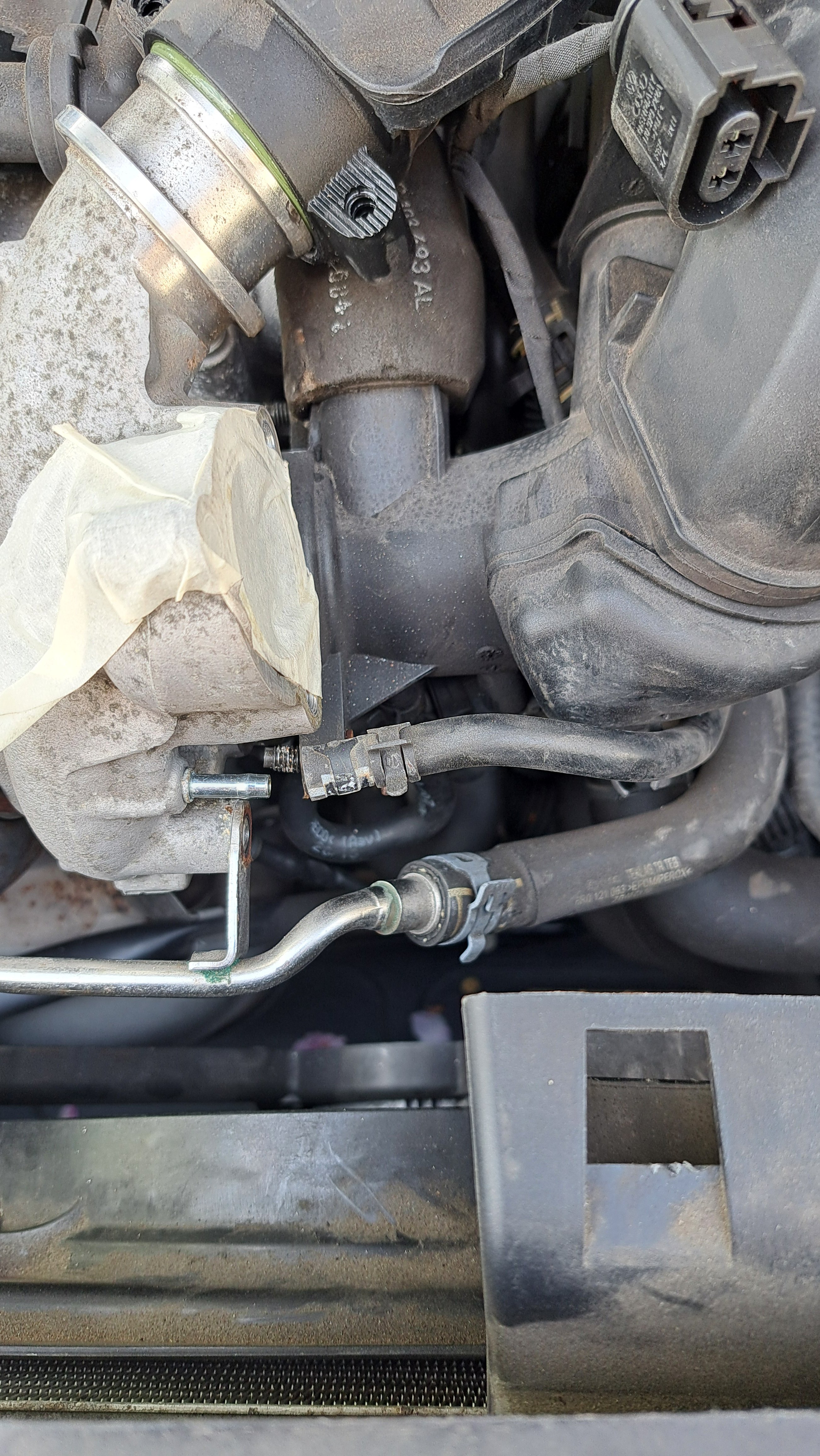

All done today, The way  i did it was to remove both air filter housings ,then 3 torx at front holding something in then 2 torx holding the black bit in front ,the second torx screw is hidden.  Then it gives you room to push it back enough to get a socket on.20240429_134145.thumb.jpg.e7aa2551c7e62c4896f0a05af31fea99.jpg20240429_134137.thumb.jpg.b6409c92d9aafc1483e9316da4247cf2.jpg
