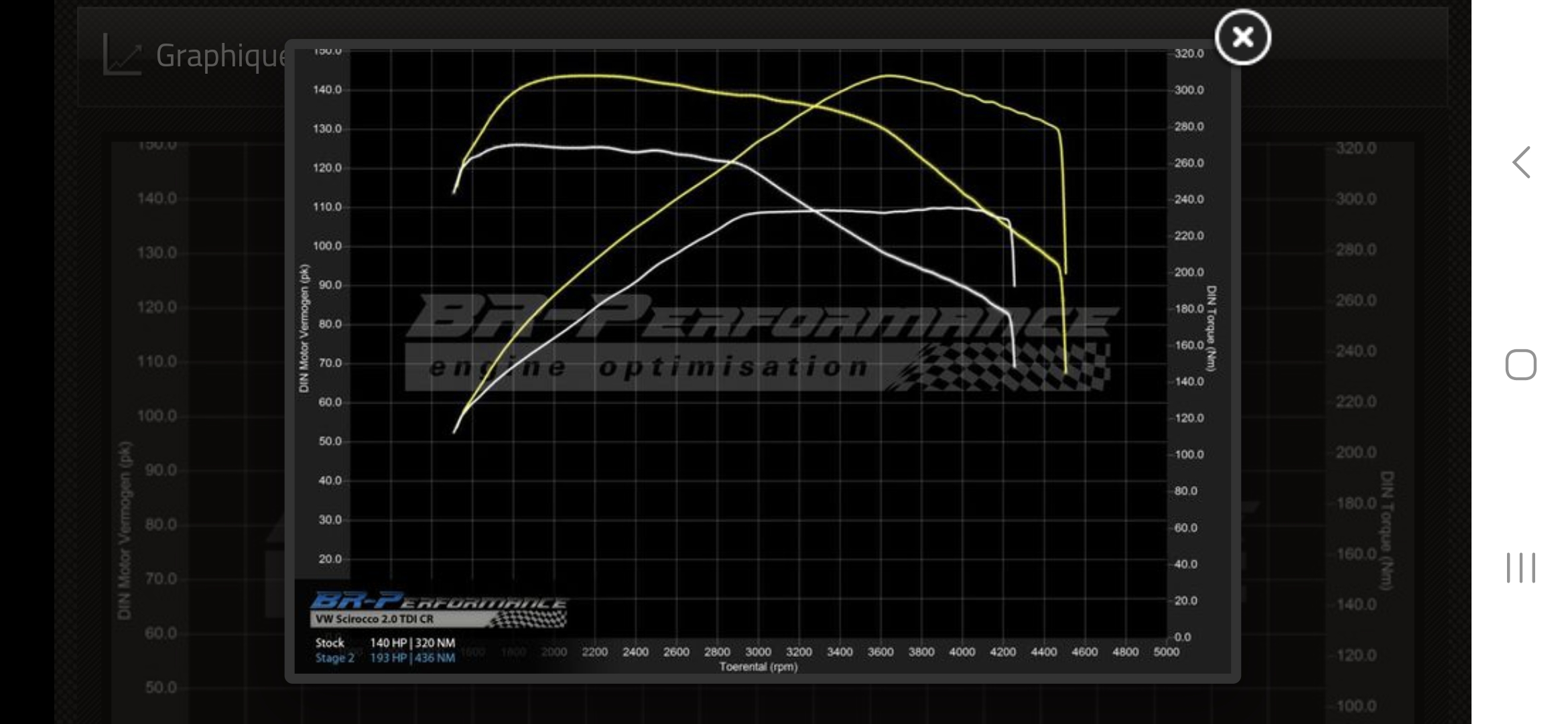

Here is a graph from a reputable tunner in France.
You will get much more torque on the launch so yes, better pulling at low revs.
This being said, watch your clutch

From various reports the 1.6 benefits greatly from a map.  The one I drove was the oldest power (95?) which was massively under powered and even revs didn't help.  You will never have the pulling power of the 1.9 but a map on the 1.6 should let it rev more freely while also offering a little down low.  If you are happy with the risks and other stuff (insurance, clutch, etc.) then go for it.

@r0bm867 To help the clutch you need to use higher revs instead of accelerating from low down.  Just drop a gear when wanting to overtake etc should do the trick.  As a mapped engine is more eager to rev anyway its actually ok.  I had my 1.9 mapped and had to adjust my driving from using 1200-2500 revs to only booting it at 2000+ (preferably more).  It was far more flexible and continued to pull up to 5k so far nicer to use.
