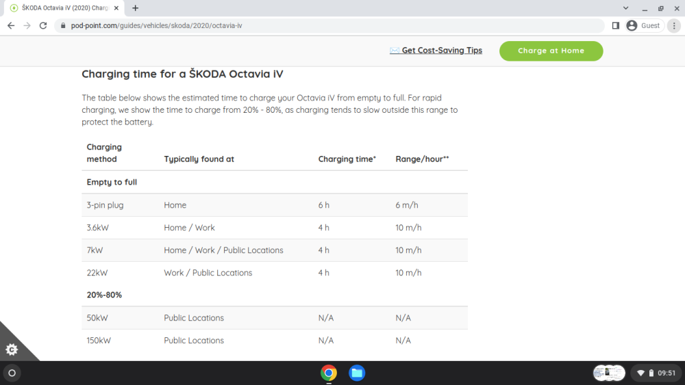

Your Evoque had a 7kW AC onboard charger, there are Land Rovers with 11 kW AC onboard,
your Skoda can only charge at 3.6 kW.
