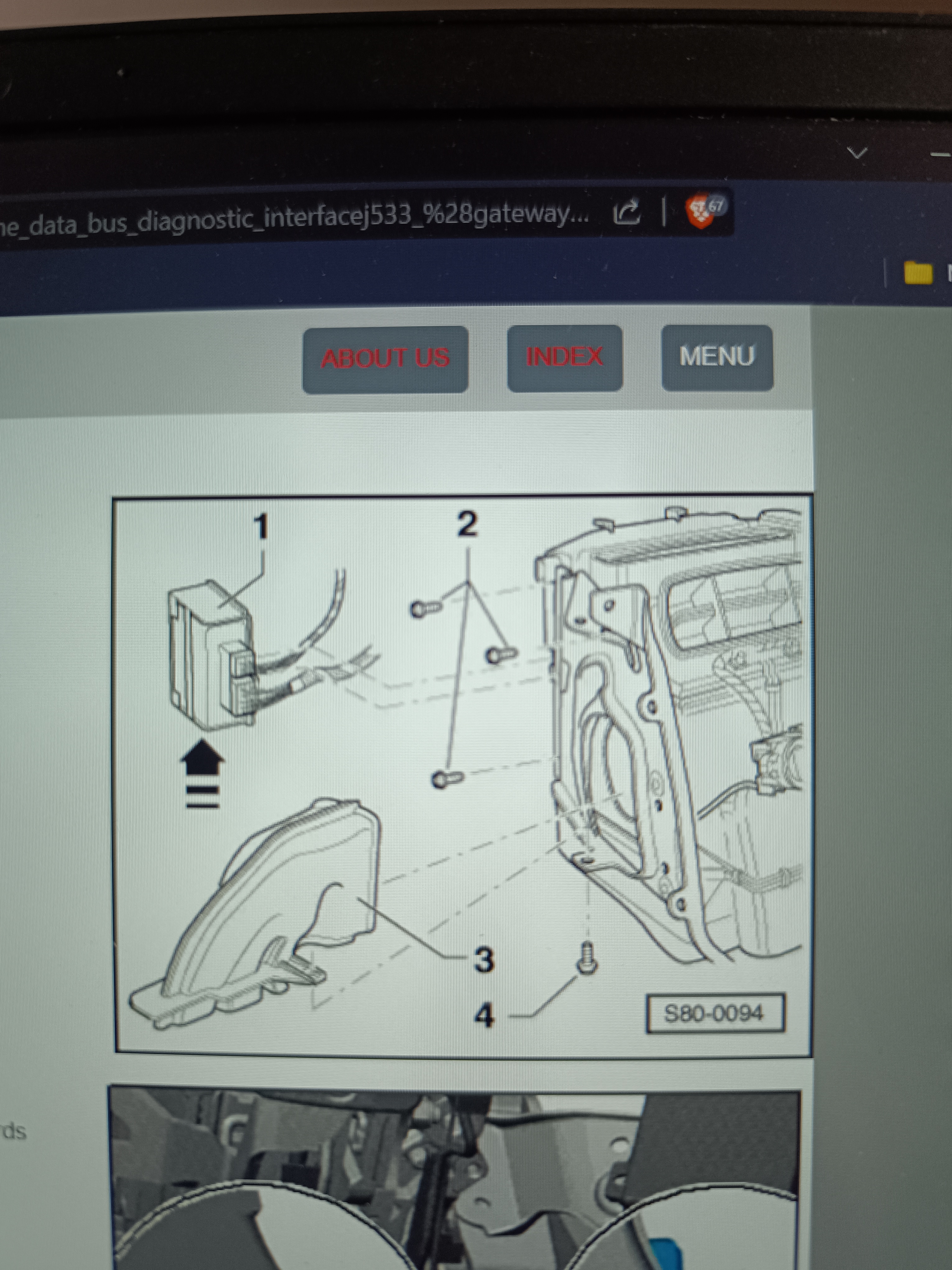

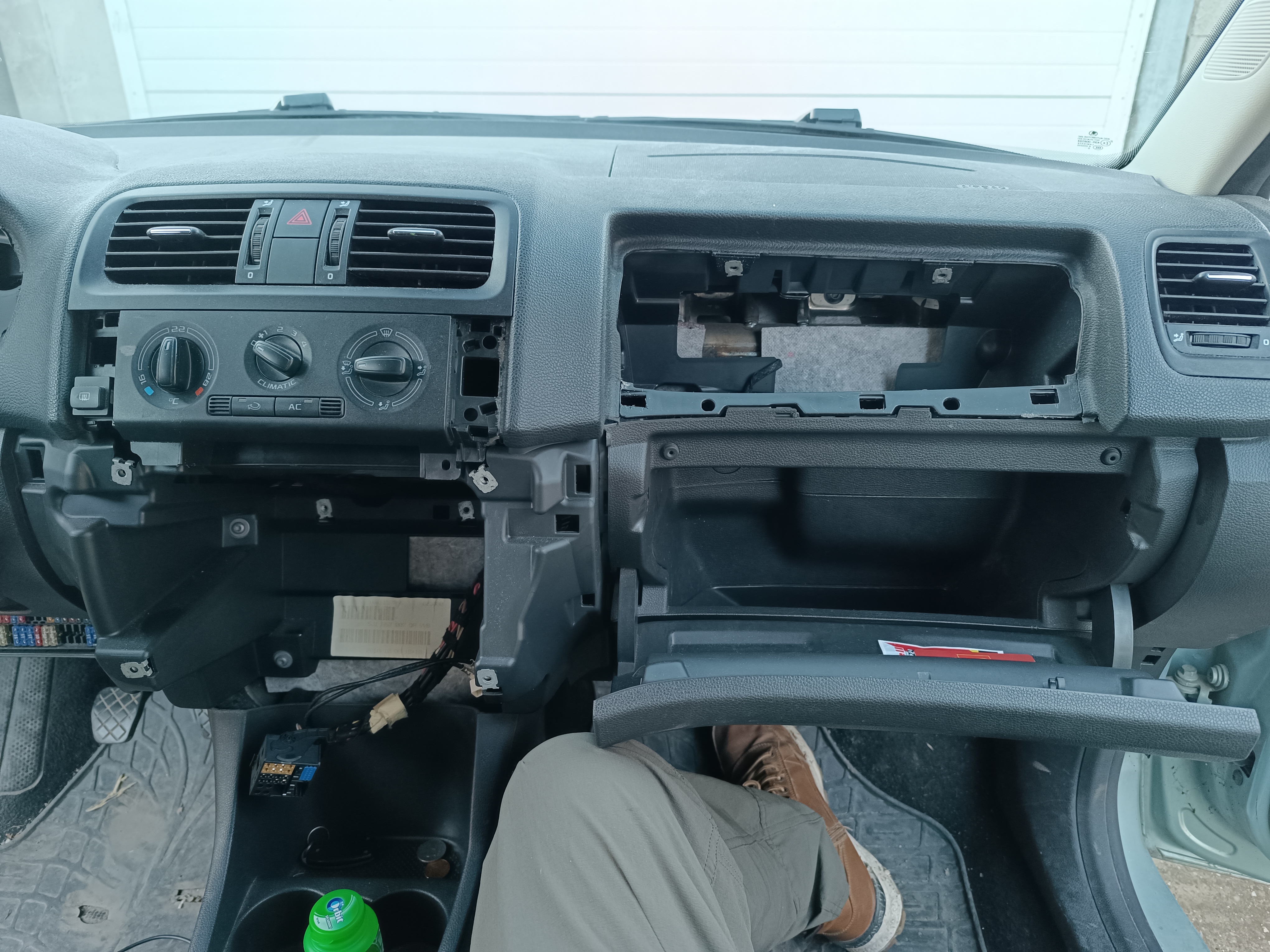

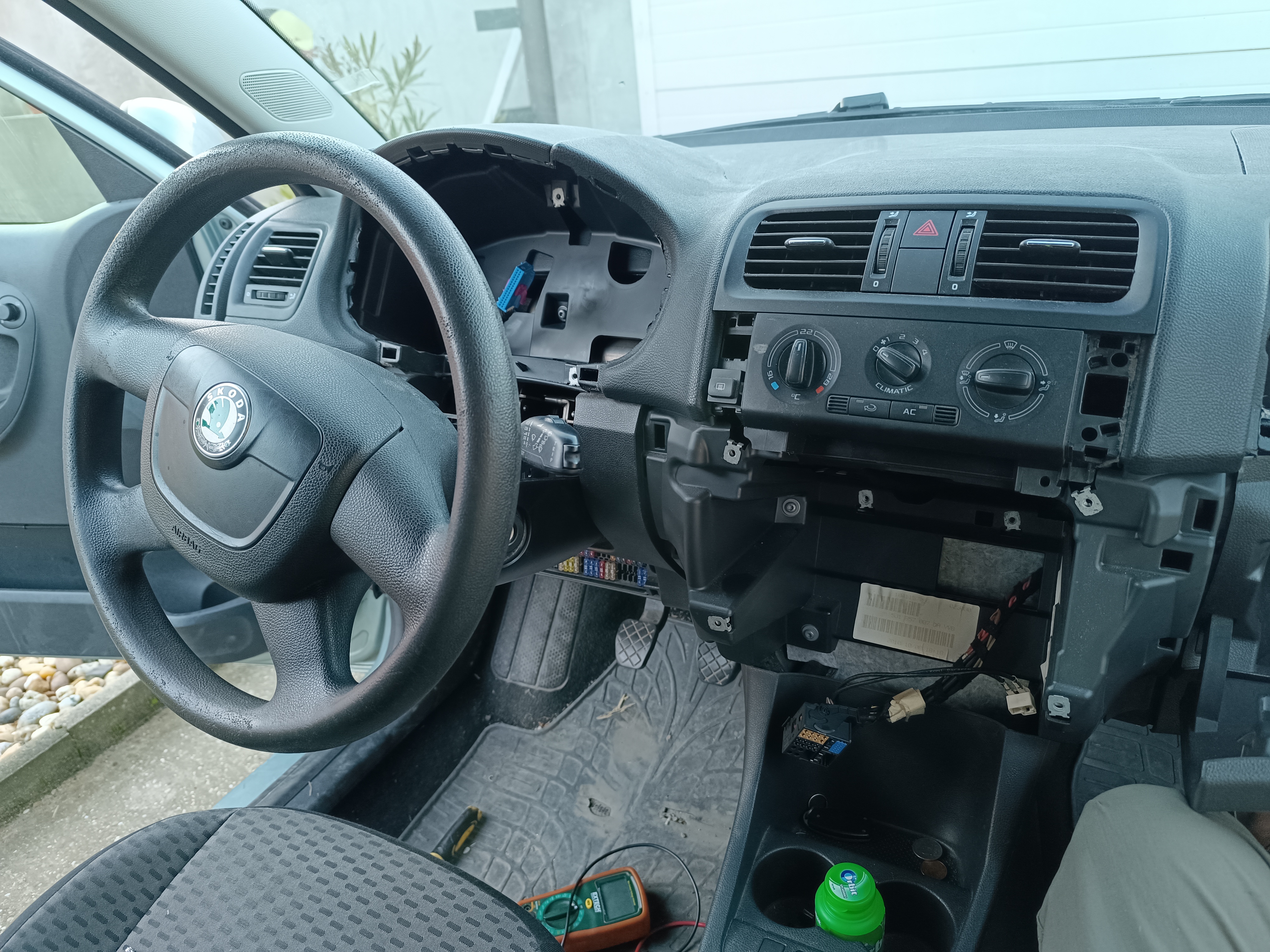

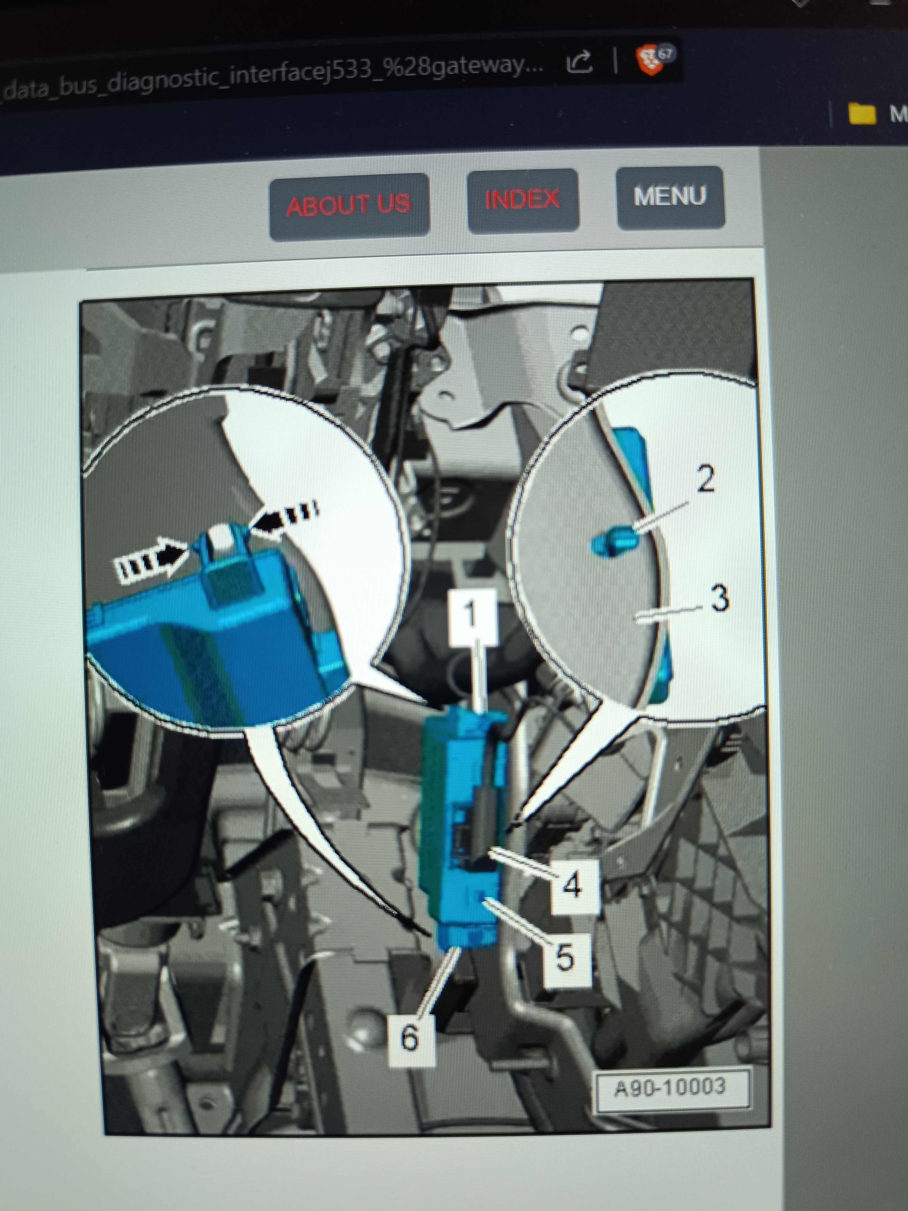

I found these pictures on the internet but i couldn't find them in the car. Could it really be integrated into the vehicle voltage control unit above the clutch pedal?

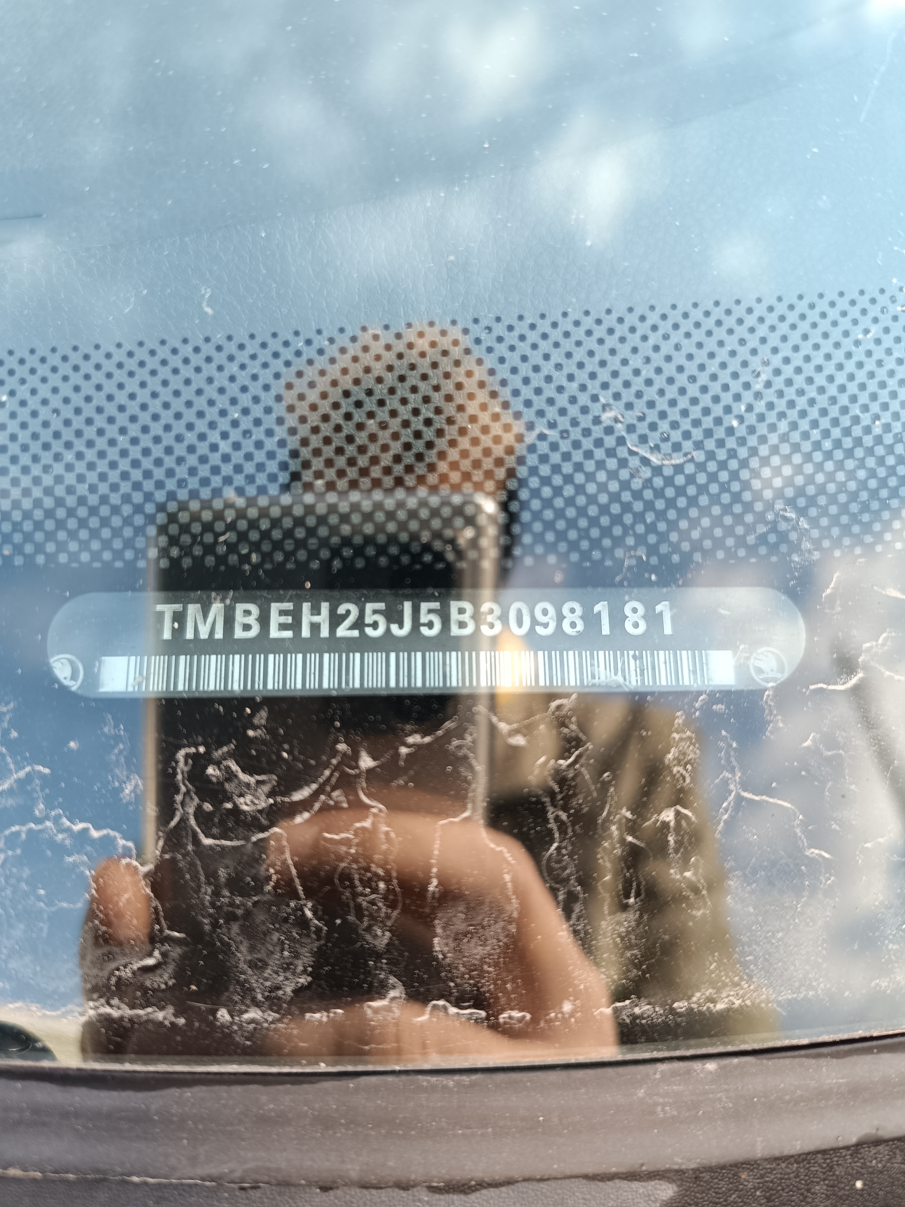

If you let me know the VIN of the car, I can find out the date of manufacture and be more certain.
Here is the vin TMBEH25J5B3098181

J533 shown like this on the relevant circuit for your build date (12 Oct 2010).
J519 is the Onboard supply control unit/vehicle voltage control unit.
In some of the later versions it is shown as a separate unit, presumably what your images above show.
