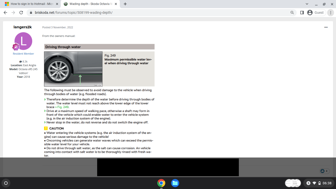

Before you go wading in what you think is not too deep water remember as you do it some idiot might come through in the opposite direction and that is then the issue.
http://briskoda.net/forums/topic/508199-wading-depth
