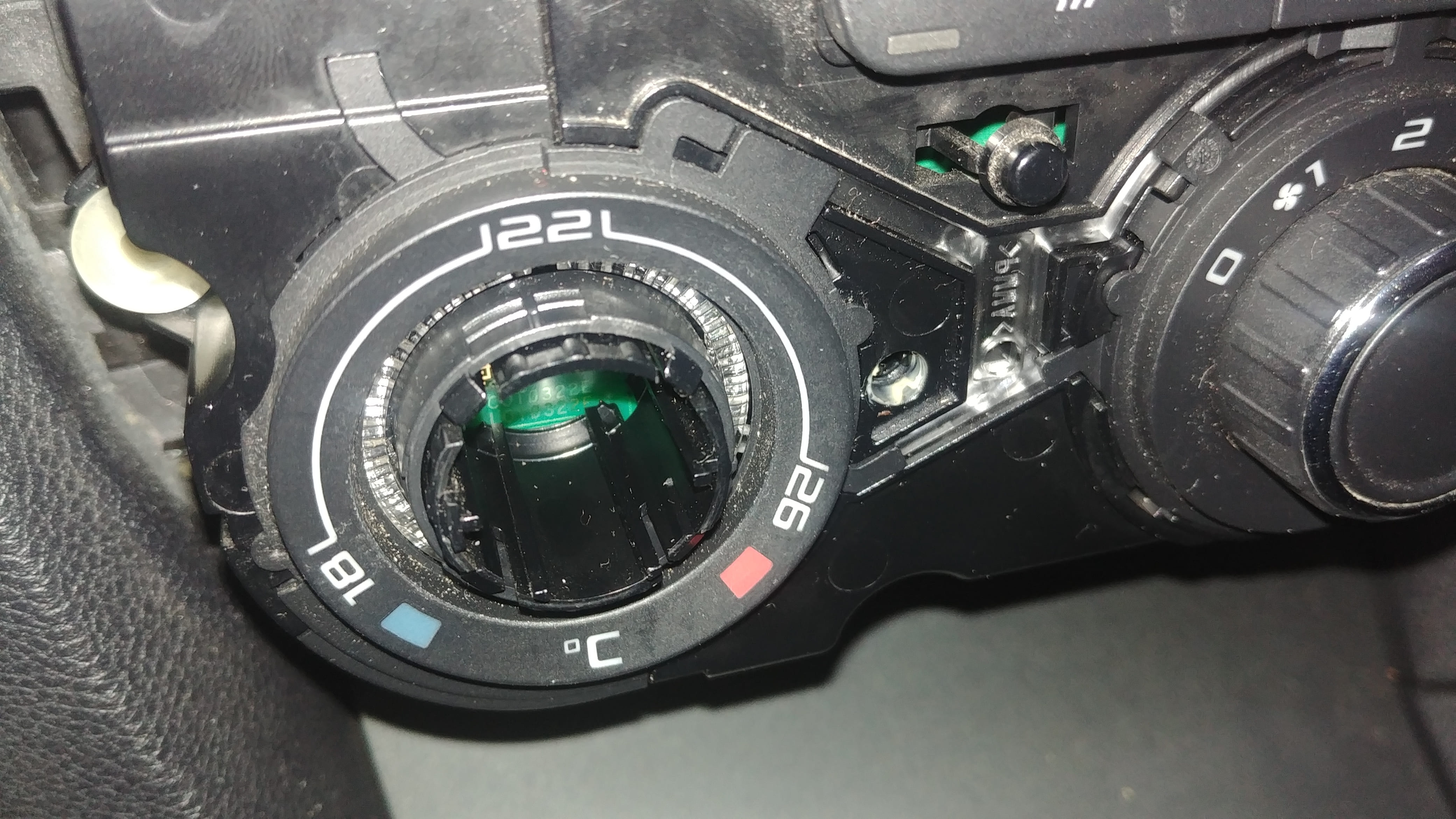

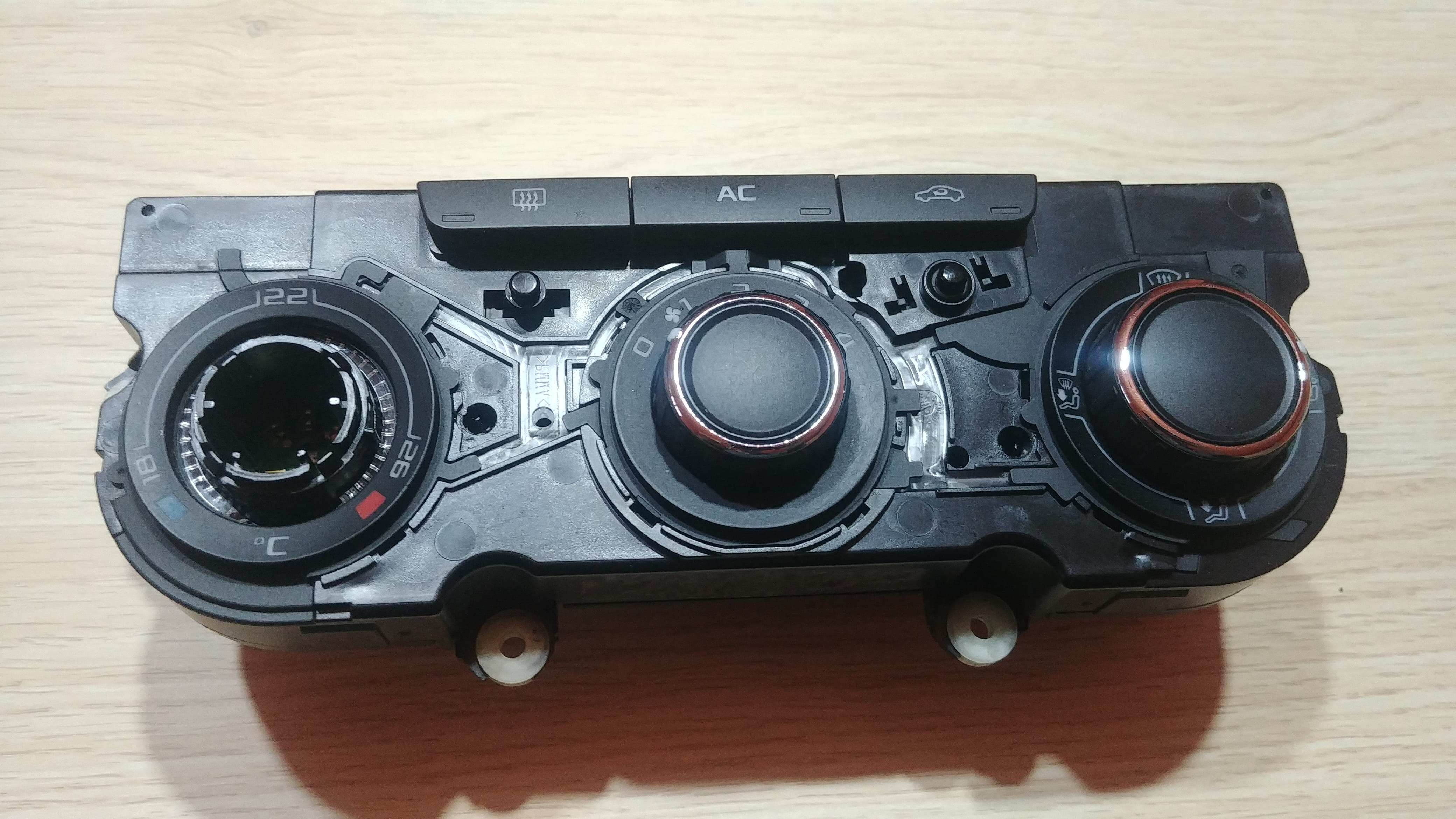

Second question is: does anybody have manual or could anybody explain how do i reassemble the heat knob to its correct position? Problem is that i wanted to take apart the climatic unit (to see if there are any contacts to clean around the potentionmeter) and pulled off the knob in the center (see photo). I thought that the potentionmeter has a stop mechanism at lowest/highest turn because if the knob is attached then it has. but i have realized that without the knob it can be turned around infinitely (just turning the potentionmeter only to the right the temp is changing between cool/warm). So now i have lost the position where the potentionmeter should be when i attach the knob. The knob has a thin cut and the potentionmeter a small "jump" so i assume one fit inside the other but i dont know where should the potentionmeter be set when i attach the knob. Because if i just attach the knob blindly then the knob might be pointing to low temp when warm air is coming and that not good. I can only experiment by feeling the air temperature coming from the vents and attach the knob accordingly but since its not regulating correctly its very hard to experiment. A definitive quide would be straightforward.

Looking at your photo I see that your knob has markings for temperature, mine doesnt, just red and blue hot and cold icons.
It's climatic, the signs of temp values means the air is continuously adjusted to the setting left.
The other settings are all manual.
