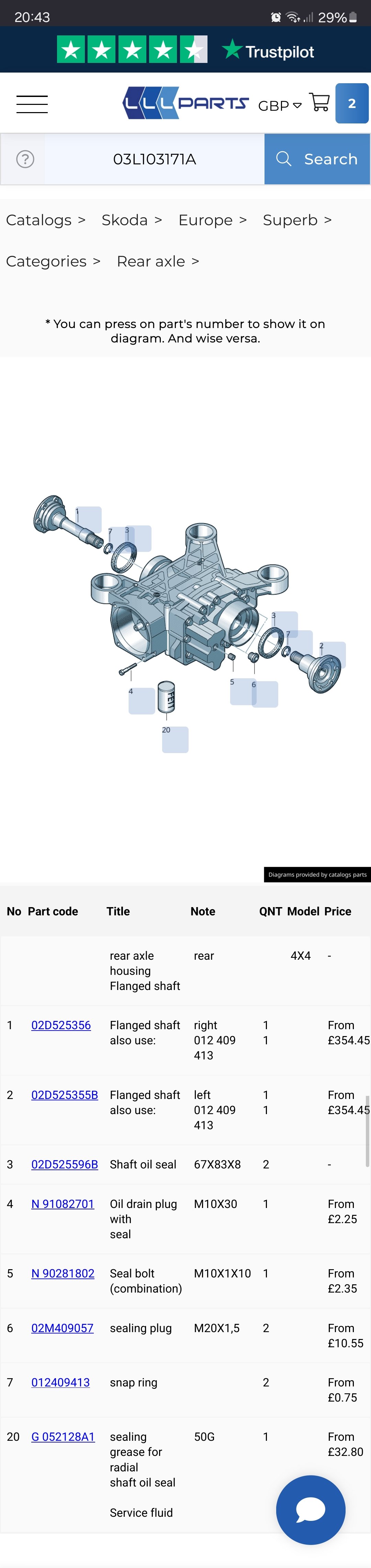

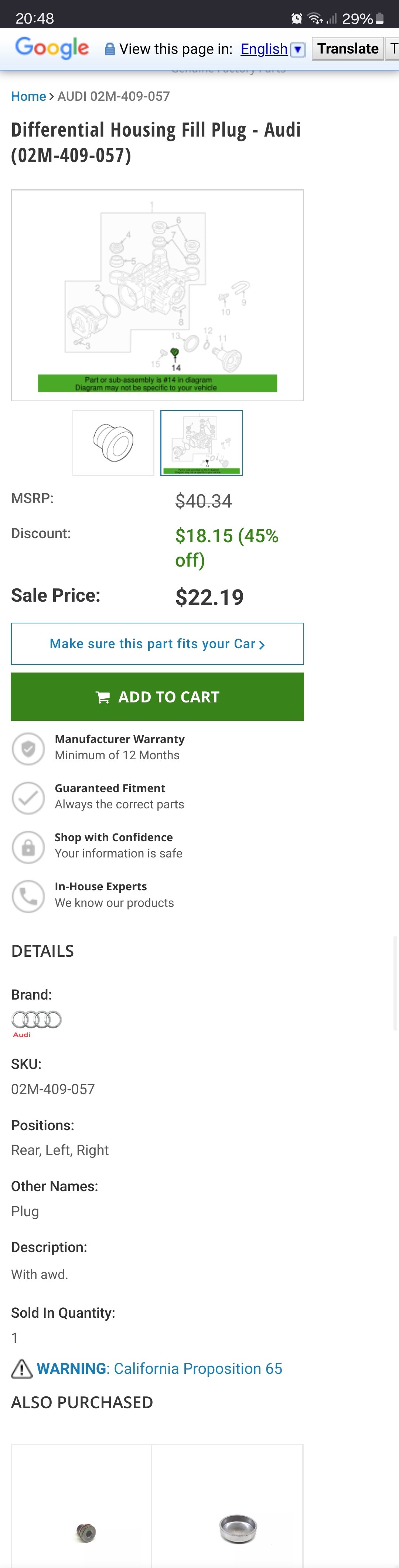

Screenshot_20240821_204819_Firefox.thumb.jpg.88bf0c167a0ea3f60249eabe49368303.jpgScreenshot_20240821_204341_Firefox.thumb.jpg.f88710841bcda8606902992a18450e77.jpg
Both saying 02M409057 for rear diff x2 No.

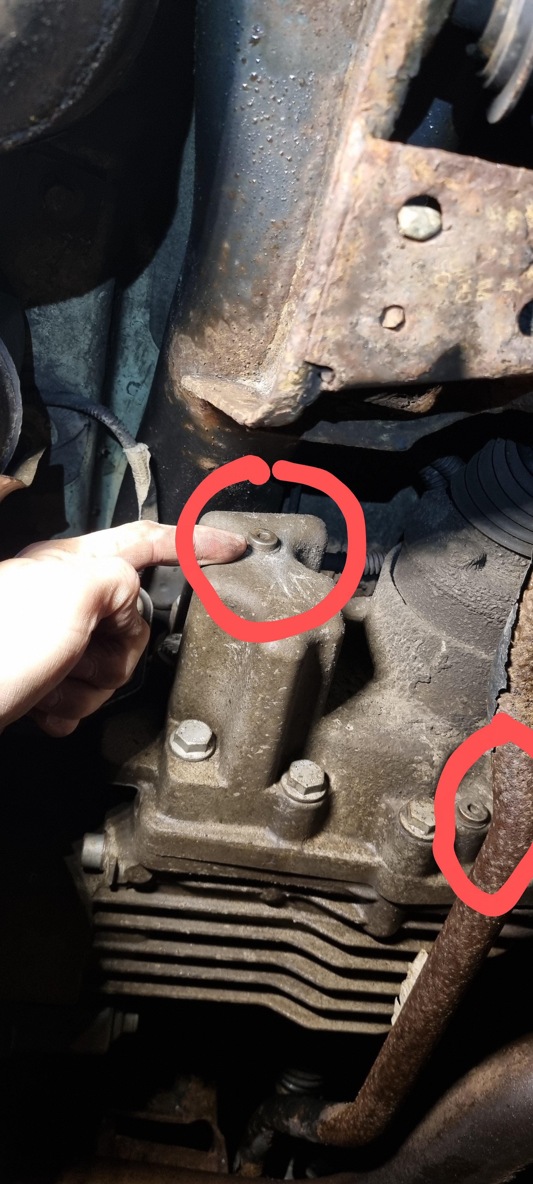

Well, look at this pic from my superb. There you see the fill plug for the haldex where my finger is pointed, and that is exactly the same as the drain plug on the rear diff (marked in red ring to the right). Have no picture of the fill plug, but hey're the same N90281802. At least thats how it is on my 2011 superb with engine cffb, and haldex 4 system. Guess it it pretty much the same on the 2013. But do take a look underneath your car just to be sure. Better safe than sorry mate 😀
