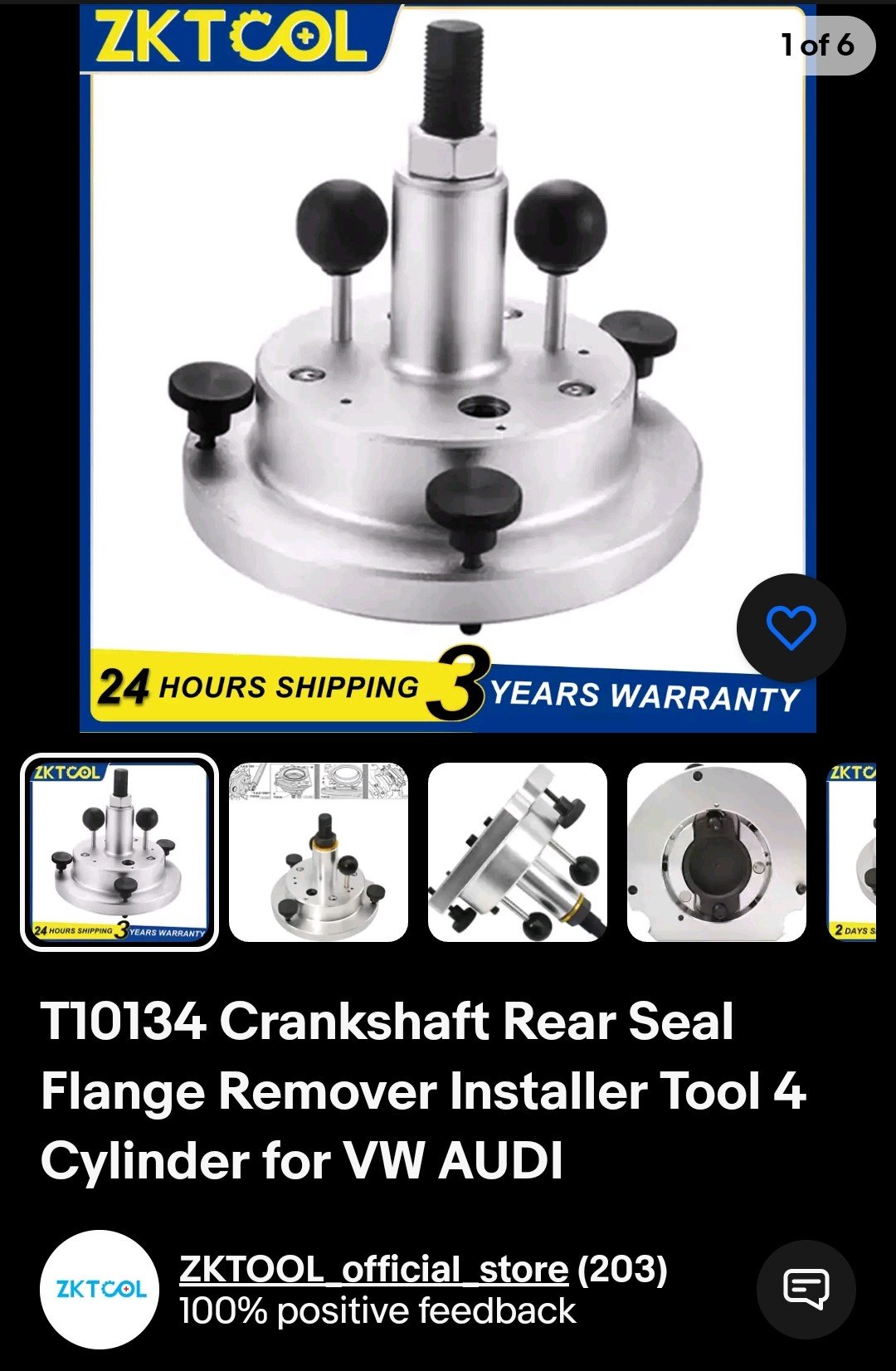

Why does engine need to be at TDC to replace rear main oil seal and what does the special tool look like/do? Is it for removing the seal? - I have handmade winkling tools for that or a shim sleeve to protect the inner lip being damaged during fitting?
It is for mounting it without risk of damaging it. Look at this link:
Tdc is also to avoid timing issues with crankshaft position sensor since the seal needs to be mounted in a special way. All that is secured with the us of T10134.
I could easily knock up something for the correct alignment of the reluctor ringbut it looks like the issue is getting the correct depth of the oil seal and reluctor ring and them being at 90° to the crankshaft axis because VAG did not fit a stepped counterbore.
Good to know, thanks for the info.
Well, if u ask any eastern european from low cost counties, they would argue that special tools are overly overrated and TOTALLY unnessecary, heheh. Eyemeasure and hammers do the trick 😆 Lots of videos on youtube 😉 Anyway, correct distance is up till 0,5mm from seal to plate according to vag specs.
