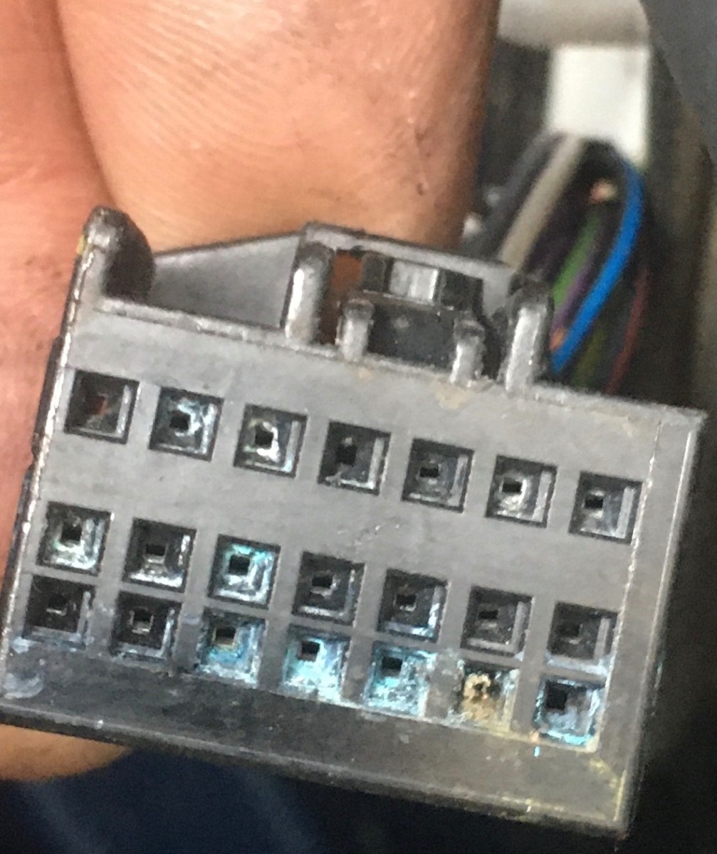

If you do find corrosion it may look something like this (different connectors on your car):
Thank you very much for the image. My connector looks like new, it's super clean, I opened it to check for pins, if some of them are missing somehow and they were clean inside, I haven't seen corrosion like on the image.
