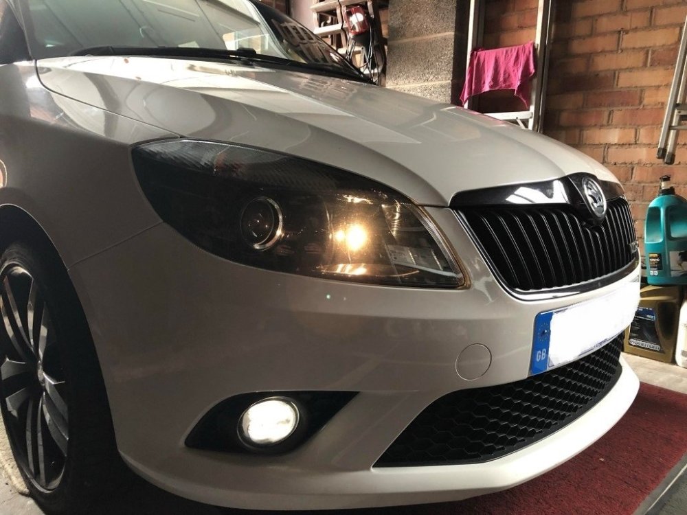

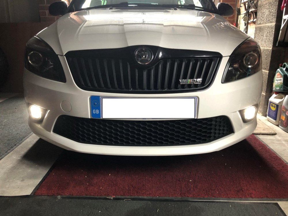

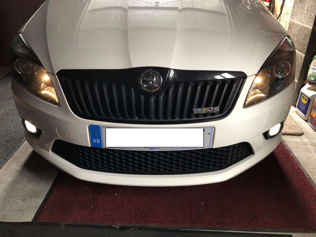

might be a stupid question, but can anyone tell me what bulb goes into the headlights?
I know that the Projector part is H7 but there's another bulb in my unit that only goes on with full beam, and can't get into it to see what type of bulb it is. from most Fabias/VRS' at this age it seems to be only the projector light that actually works so it's a bit strange

there is a bulb beside them that doesn't work.
the both come on when it's full beam

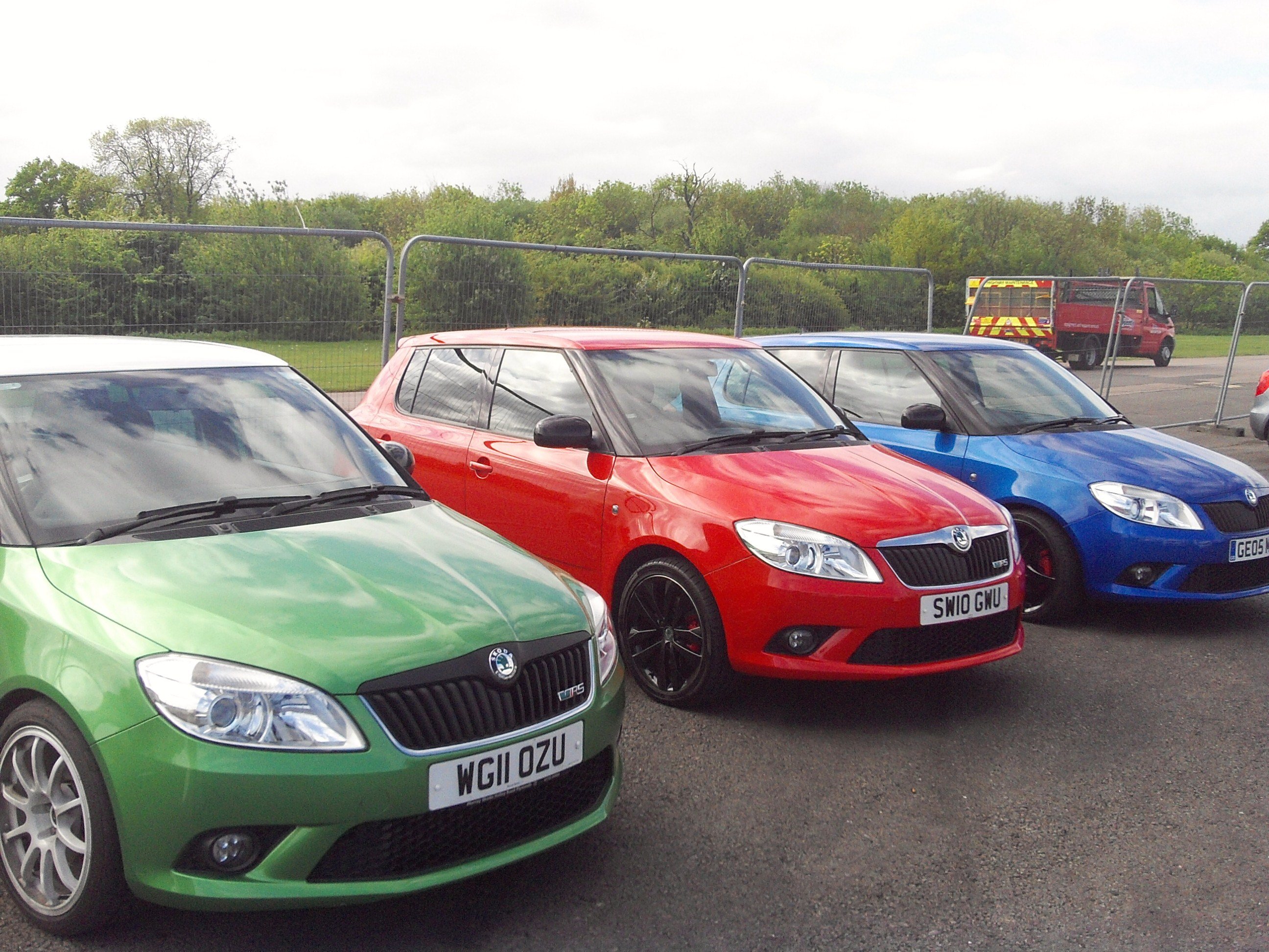

On the vrs with chrome headlight there are 2 H7 blubs main and dip on the vrs/ monte carlo with black headlight there is 1 H7 blub to do main/dip
it does seem some "early" vRS's had the lights like yours......not sure when it changed to just the projector with shutter as mentioned earlier in the topic. Maybe a facelift thing.
Not seen an early vRS close up, so cannot be sure but further up its stated the early ones had 2 H7 bulbs fitted.
