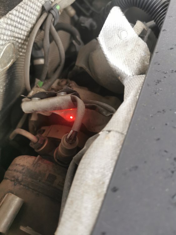

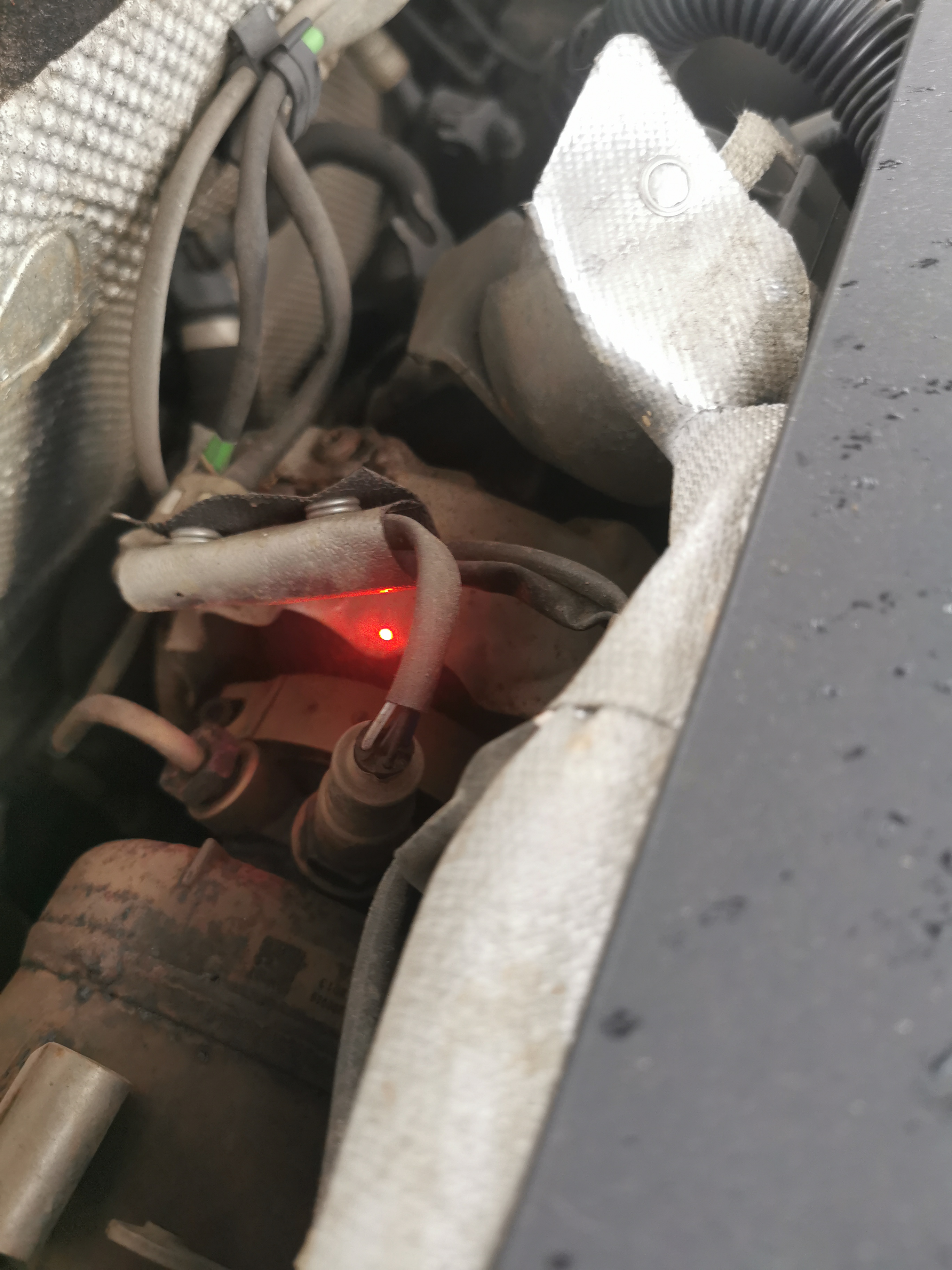

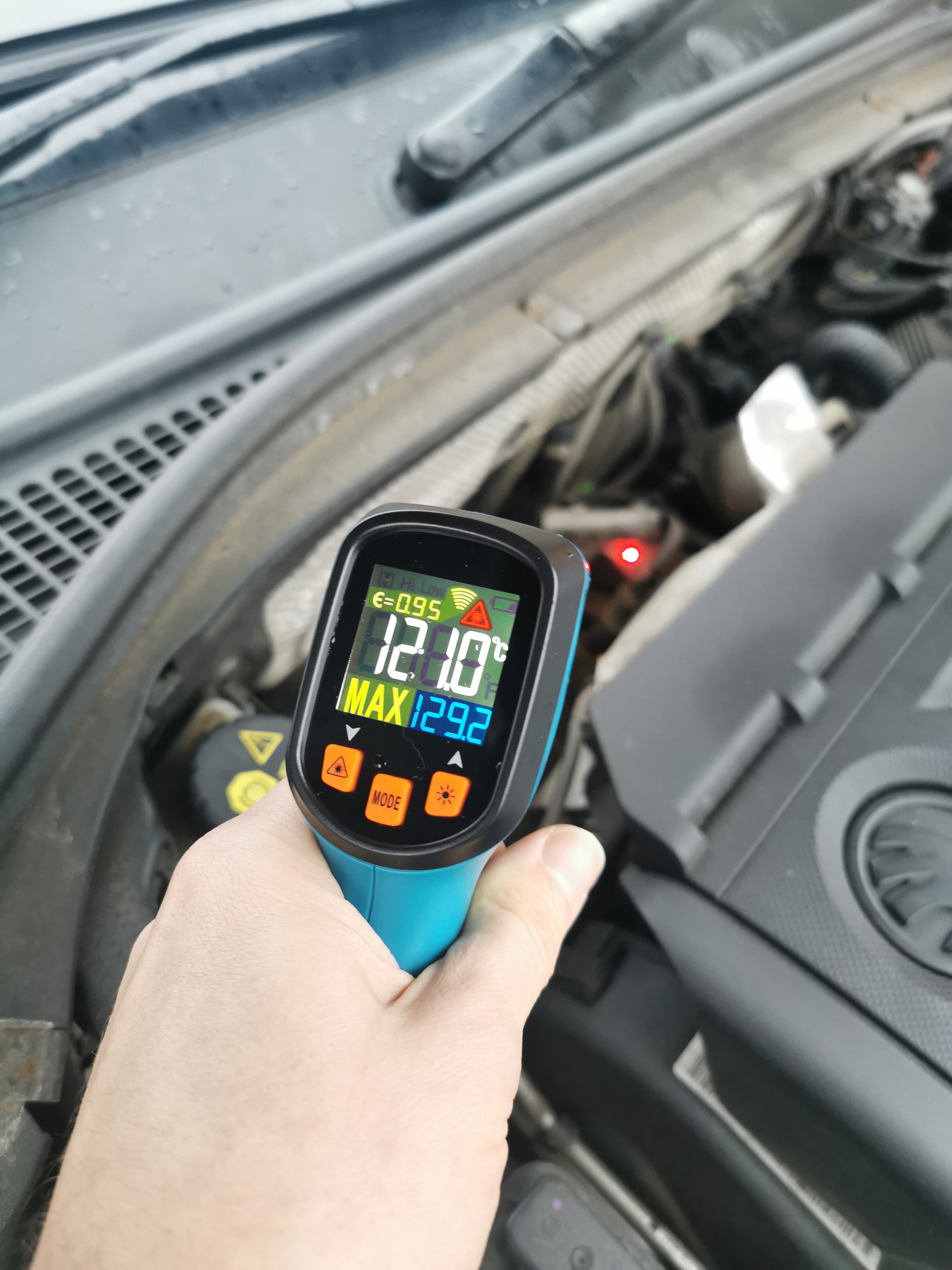

Hi, help needed please. Does anyone know what this part is called? I've not had any warning lights come on, but the temperature gauge is going up to 130 from the usual 90 when I'm going at 70 on the motorway. It appears to be this part that's overheating, so doesn't look like a sensor issue. I've got it booked in to a garage this week, but it would be good to go armed with some knowledge. I'm also hoping the part needed assuming it's this is under a tenner 🙃. Thank you to anyone who can advise.

Cheers, could be worse then. Do you know what part that is where the red dot is?

Why do you think that because you found something hot in your engine, that this is the cause of overheating? Exhaust bits get extremely hot. This is normal.
The only part on the vehicle that gets hot and is under a tenner 😃
You are barking up the wrong tree, you do not diagnose an overheating engine by looking for the hottest part which will always be the exhaust or DPF. Your problem is a common one, the sliding sleeve on the water pump, it will go away of you disconnect the connector from the actuator but you will have to drive a lot further before getting heat from the heater.

If I well understand the 1st pic, it's were fuel is injected to run DPF regeneration. Thus not surprising it gets hot.
The 130°C you're referring to concern the coolant system. Just point the hose at one end of the radiator with your red dot. The coolest end should be where the coolant temperature sensor is.
