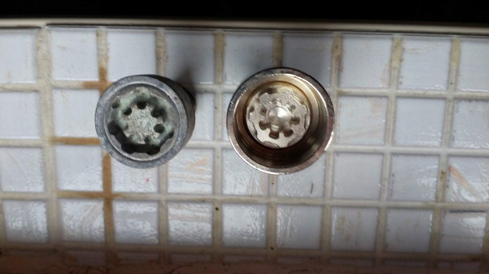

Here's a photo of one of the locking bolts;
Do I just need one of these, i.e. a 52/7pt as referred to on similar threads;

Several companies can help with a replacement locking key. Just need to determine the code which is simply matching your photo.
https://carpartsstore.co.uk/product/skoda-locking-key/
Possibly this one? 776 S

Just to be clear, I did use the wheel nut key to get the wheel off (twice) but must have left it on the bolt and driven off the last time.
If it is a 776, I was wondering about this listing, as my car came without any wheel nut covers (bar 5 left in the boot);
https://www.ebay.co.uk/itm/256377841187?mkcid=16&mkevt=1&mkrid=711-127632-2357-0&ssspo=kbuWRIALRz6&sssrc=2047675&ssuid=&widget_ver=artemis&media=COPY
Looking at the bolts being sold as part of the lot, it does look very like mine.
The wheel nut covers that were left in the boot are part number 321 601 173 B and 4FO 601 173 A for the locking nuts.
Car came without any polystyrene insert but did have a spacesaver spare and an unused VAG tyre inflater.
That does look like the right key. Note the seller does not accept returns.
Double check before ordering.

Ordered this one after prompt reply to my enquiry confirmed suitability.

Key arrived this morning and bolt removed😊
