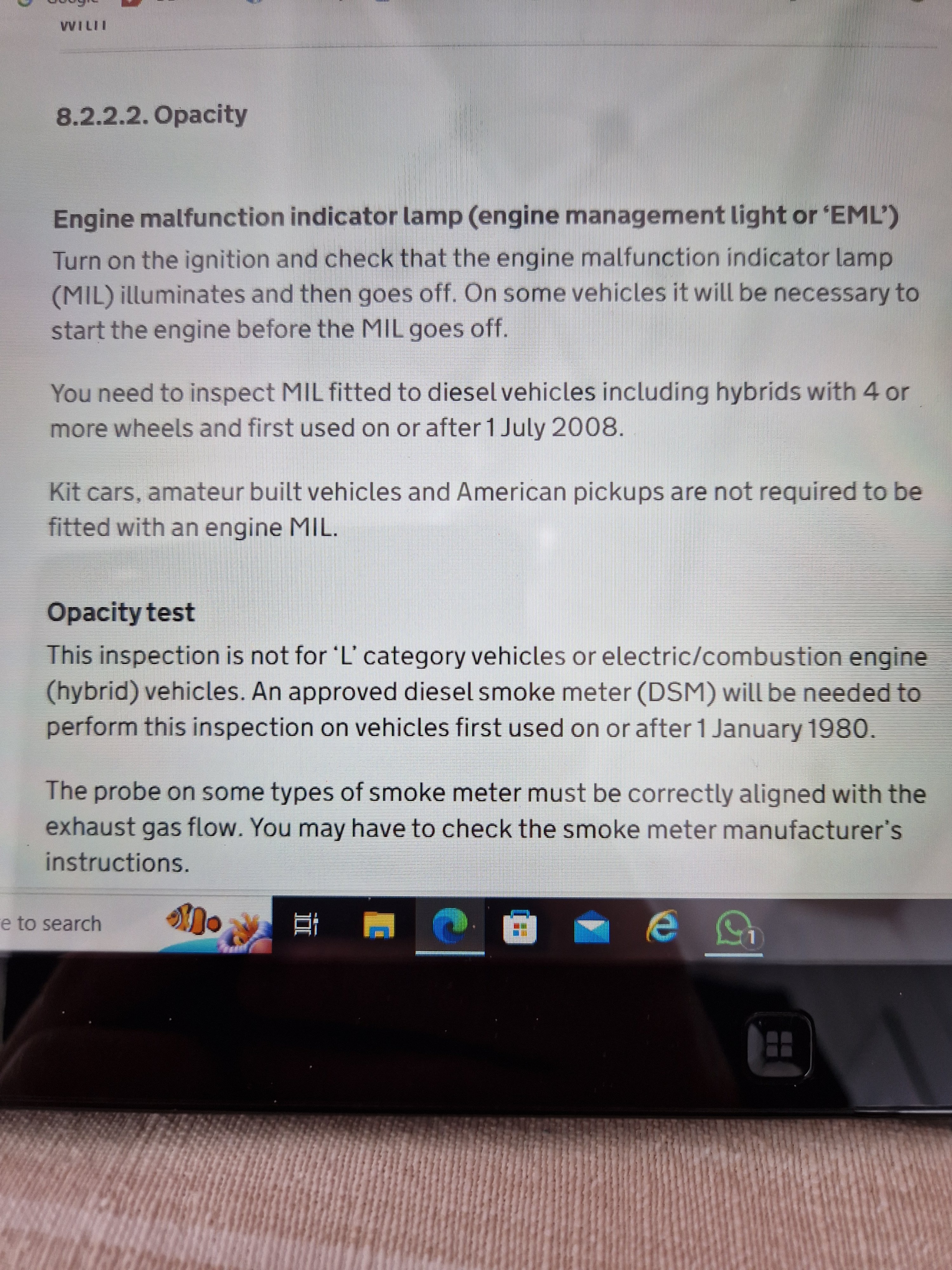

My 2004 Mk1 Fabia SDI diesel has just failed its MOT on the grounds that the engine management light is inoperative (MOT handbook 8.2.2.2(g)).  I believe the tester wanted the yellow engine icon at the 8 o’clock position of the speedo dial to light up after switching the ignition on.  Which it doesn’t, and perhaps I’ve grown unobservant but I don’t think it ever has in 12 years (it’s certainly never lit up when driving).

I'm also reasonably sure that a diesel of this age doesn't need its EML or equivalent checked at MOT.
Will check that too.
Thanks Breezy_Pete for the very prompt response.  There ensued a polite discussion resulting in a fresh MOT at 192,000-miles odd and I continue rolling on towards 200,000.
