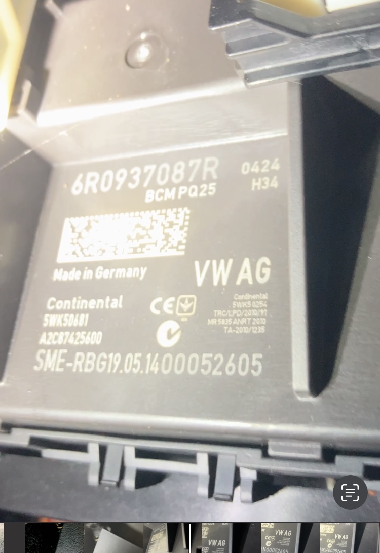

The BCM fitted is a 6R0937087R. Is it possible to replace this for a like for like?
I’ve been told it would need to be recoded, and there’s a local mechanic who may be able to do that. I’m 120 miles from the nearest Skoda dealer.

It's quite likely to be burned out relay contacts within the BCM, I think.
It may be possible to replace this relay if you can get into the unit, identify the relay, buy a replacement, and have the necessary desoldering/soldering equipment and skills.
Thanks - that’s interesting! It’s outwith my capability by maybe not my helpers…

if I were to replace the BCM, is it possible to buy a second hand one from eBay and get someone with the right kit to program it? Will my keys still be linked etc?
rhe nearest VAG dealer is 120 miles away and I’ve read a genuine repair/replacement could be £1,000 which I can’t really afford.
AC has a seperate controller, key RFID I think is taken care of by the instrument cluster and engine ECU.
I dont think there is a key/immobiliser issue when replacing the BCM/CCM, you need to find the correct revision for your vehicle and copy the existing long coding to the replacement one.
I would replace the relay or pay Pete to do it, he has younger eyes and more of them than I have now!
